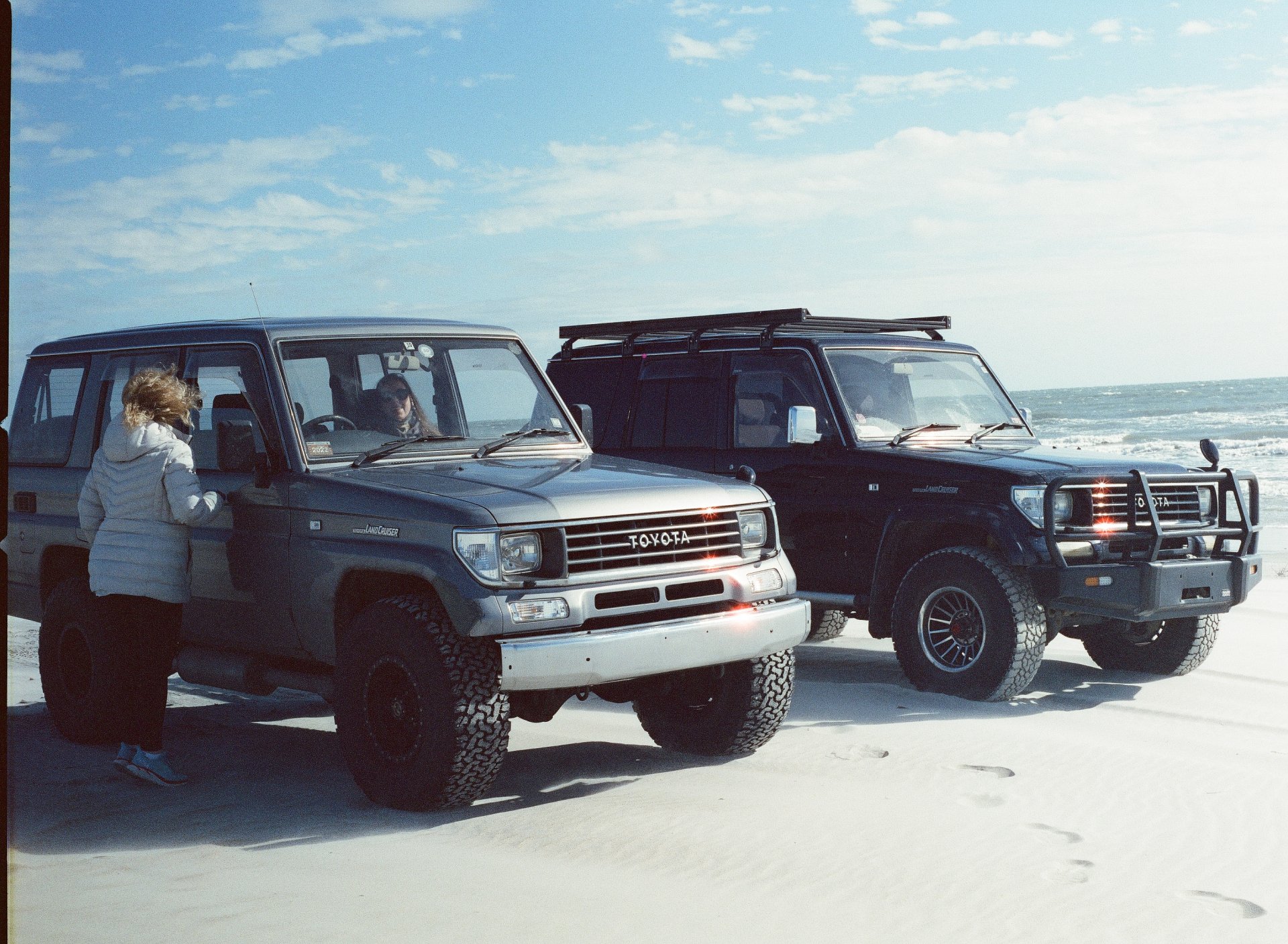

Here is mine next to @Shyrock Kzj78. Most of the work I have done you cant see though haha. Breaks, birfs, gaskets filters, bumper, undoing some unsavory off road light wiring, 2 days of pulling off ugly window tinting, those door light switches, some rust repair... you know the classic land cruiser stuff that breaks. Let me know when you do the control arm drop brackets Id be interested in seeing how that goes.
What wheels do you have? Love those!
I have not sure of the model number but they are made by Method. I actually just purchased some stock 70 series steel rims yesterday that should be here next week. So these tires and wheels will be no longer on the kzj78. I think the 12.50 tire width is too much. they rub a little too at full steering lock. I am going to have some 235 85 16 tires mounted.
