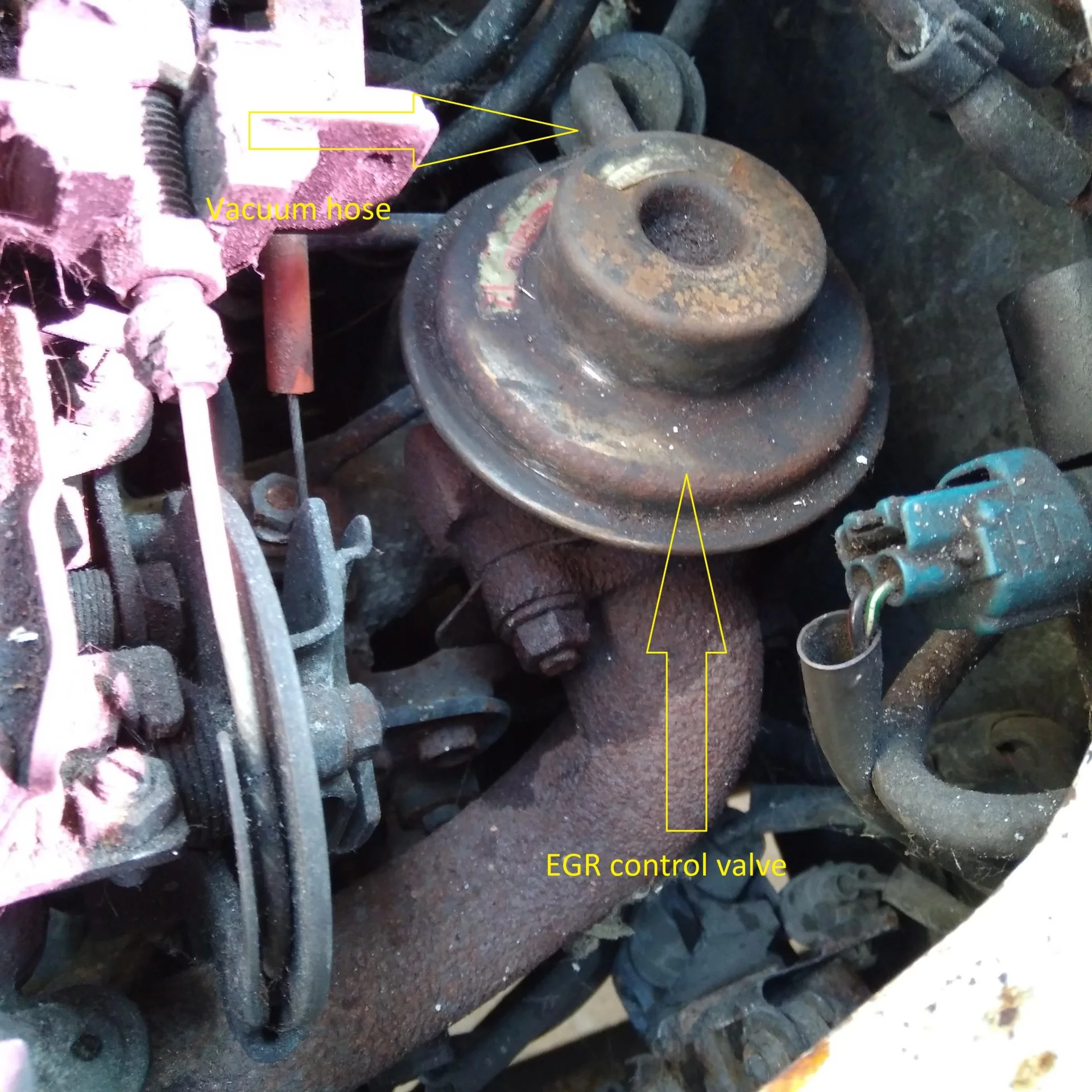

Hi there, I have a Hiace with 2-LTE engine and want to remove the EGR system as many people have advised. Are there any step-by-step instructions on these forums?
Plating off the apertures at the manifold and air intake end is simple enough but I'm wondering what happens with the valve control on top and the vacuum hose connected to it. Also, are there any sensors in the system - and does removing the EGR screw up the engine management system? Etc.
Photo attached. Hope you can shed some light for me!

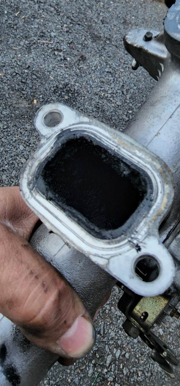

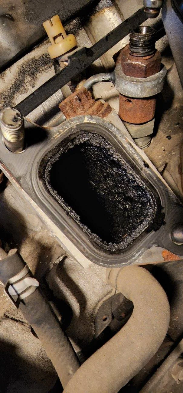

EGR delete is definitely worthwhile. I did it when I first bought my truck and used the exhaust side blanking plate to fit an EGT probe. I’m not sure what it does for temps, but after 140k miles the mixture of exhaust gas and oil from the crankcase breather had deposited a few mm thick sludge inside the intake manifold.

just block it with a plate and leave it all on there , it will still function as normal just no crap will end up in to your intake manifold, there is nothing to tell the ecu you have done this as well so no cel or any stuff like that
