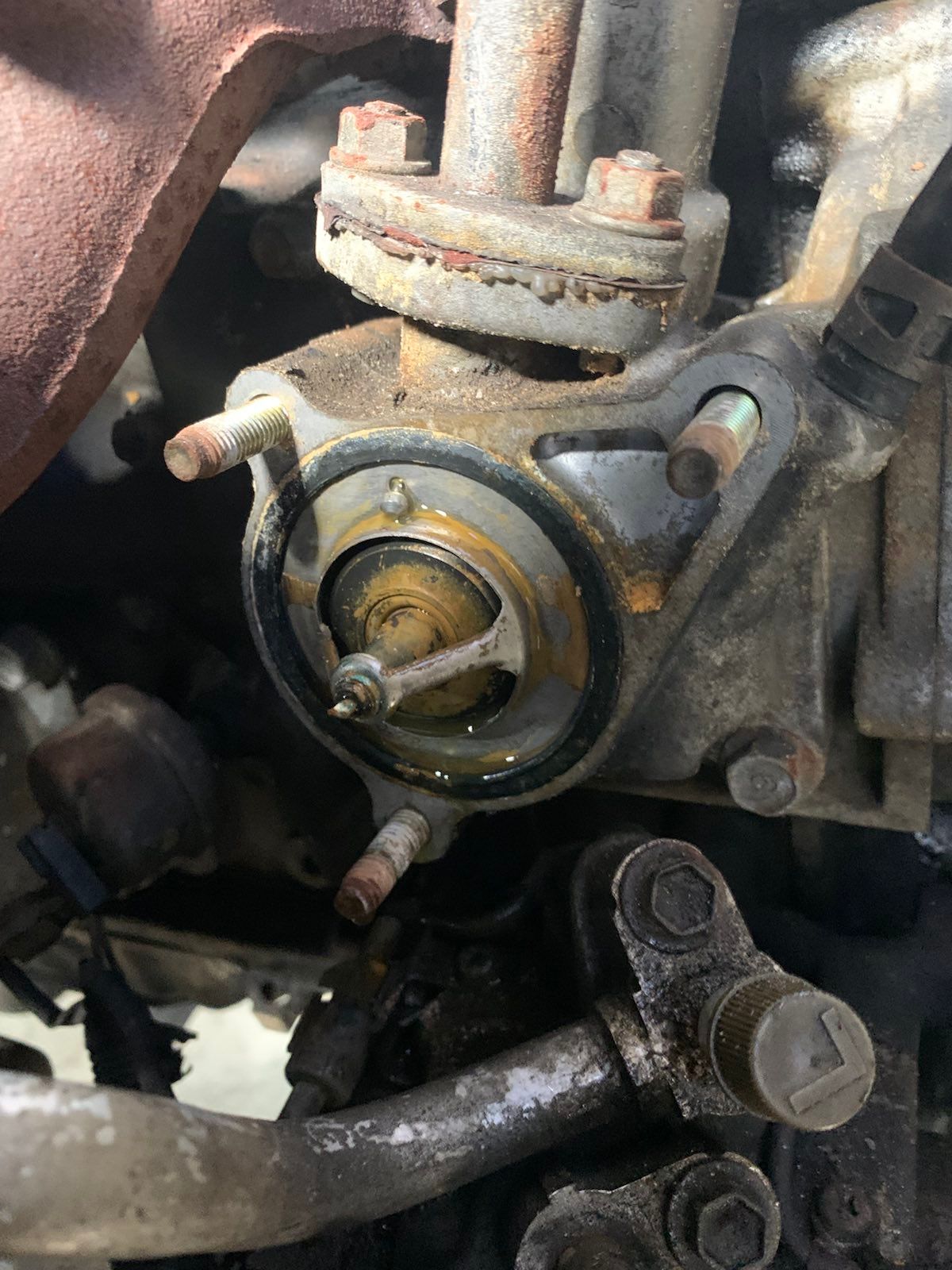

Looks like the previous owner did have the thermostat installed correctly.
With a flashlight, it was easy to figure out that the coolant was a mix of green and some type that was orange. No idea if it was Dexcool. I can't believe a guy that owned his own auto repair shop would mix incompatible coolant types. He had this truck it's entire life except for the first year.

Yellow (Prestone) can start look orangish with age. Red can start to look brownish. Both are exaggerated when shining a flashlight through them. Put some in a clear glass before settling on a verdict.
