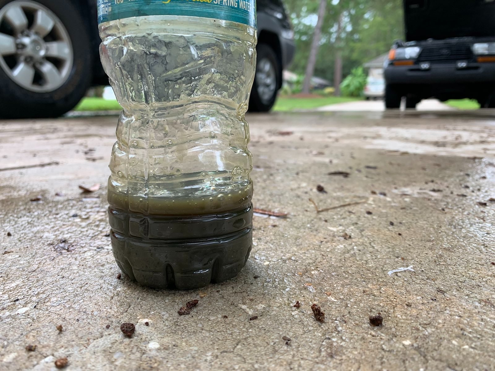

This is what came out:
The guys from Thermocure said if I can eventually get clear water to come out with no flakes I won't need another round. I guess we'll see if that rust was helping keep anything from leaking but I'd rather find out now.
It took 30 gallons of water to get things to run clear. I extended the heater hose-to-engine connection so I could use a a garden hose to flush. I also flushed some from the top of the radiator out these hoses.

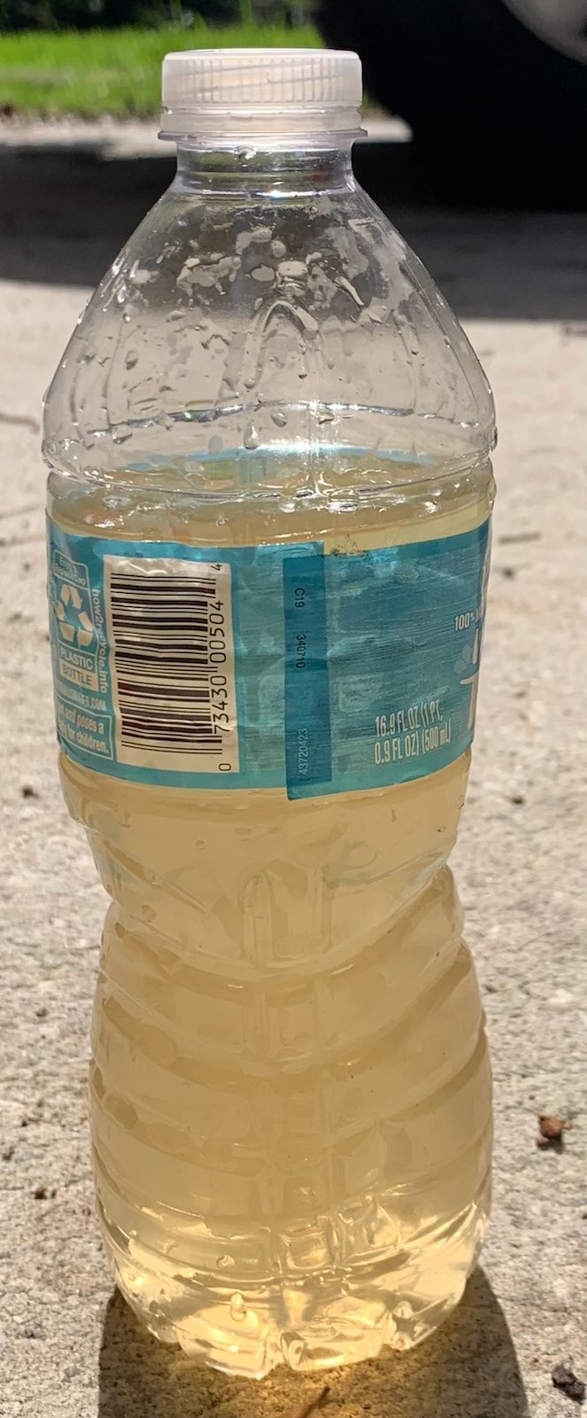

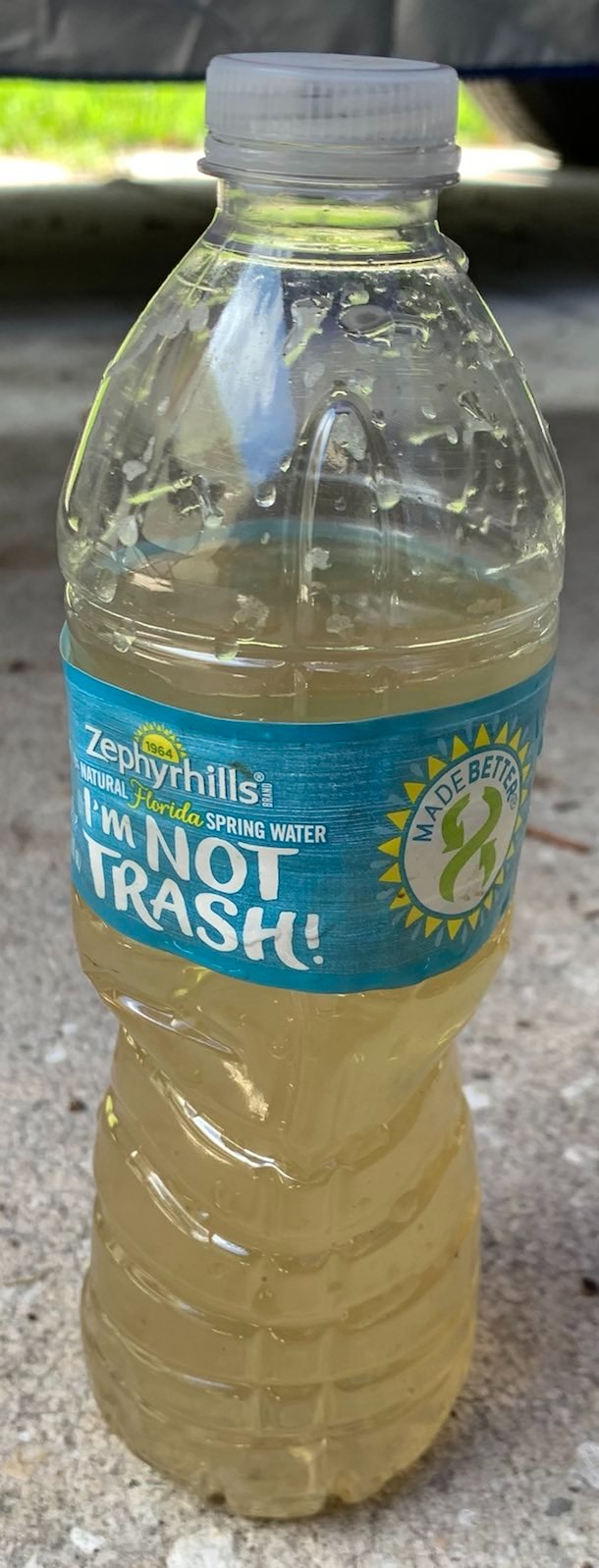

I got one round of distilled water back in but it's going to take more rounds of running the engine, drain, and fill. I could tell from the funnel that the Thermocure wasn't all the way out.

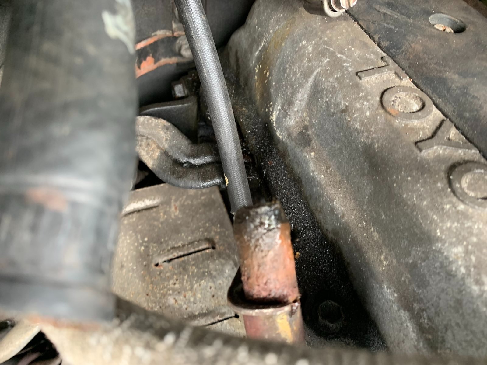

I also realized I have a hard pipe that is missing chunks from rust on the end. Rust colored goo came off when removing the hose. This is the same expensive pipe that the PO used sealant on at the other end near the engine. Going to have to take this off and trim off the rust. I guess I can just use a longer hose to the firewall. Unless I find this pipe somewhere where it isn't $150.

The Thermocure will get ALL the rust out, but yeah, you’ll have to run a ton of water through to get the remnants of Thermocure out. I did similar to you and flushed most of the Thermocure out with a hose.
I am doing a crappy job actually flushing with the garden hose I think. I saw a guy do it with the engine running and I think that was more efficient. I need to go back to the drawing board if my next drain or two is still too dark. I have to say I was pretty disappointed seeing non-clear water after 30 gallons of waste from the garden hose. I think the issue was that the entire system was not totally full under correct pressure.
