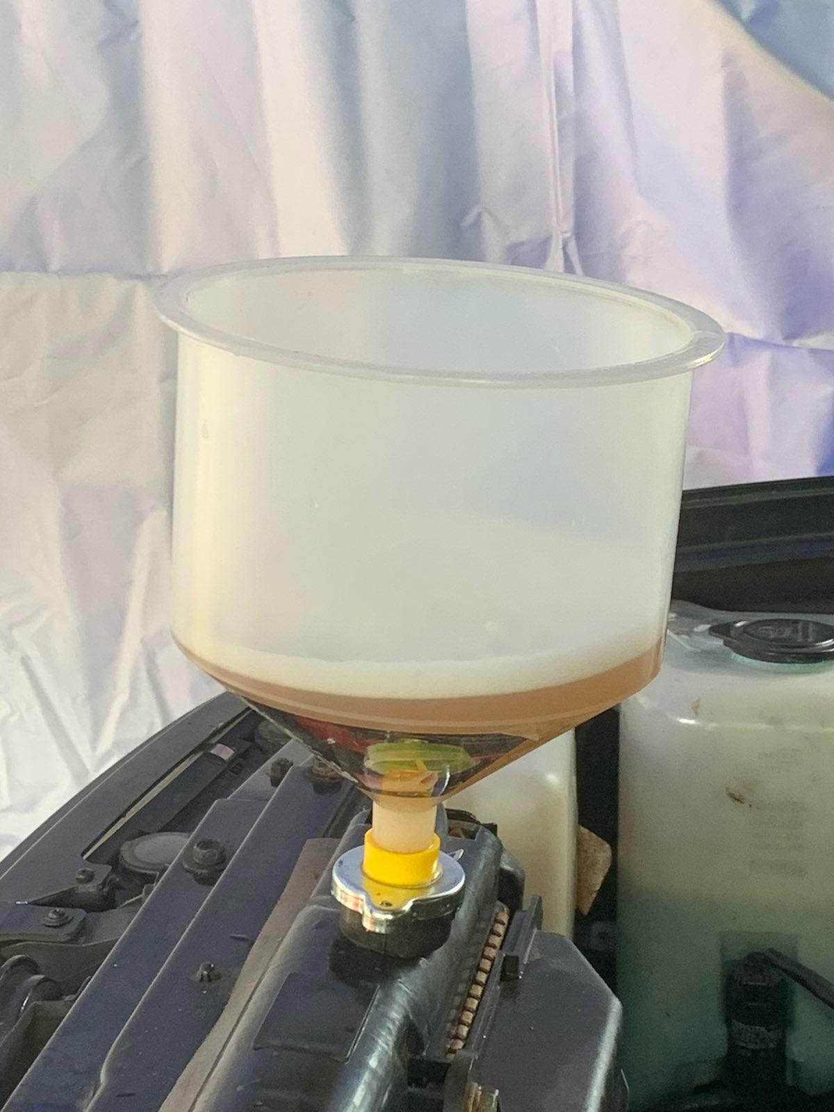

I've never used the funnel thing, just fill the radiator with the engine off till full, cover the cap opening with my palm, pump the top coolant hose a few times to move the air around, top off, seal with hand, pump, top off..... until when I pump the top hose coolant dribbles into to the overflow.
Then I start the engine and monitor the coolant level and top off as needed, till it won't take anymore. Seal with cap and top off overflow bottle. and let it get up to temp.
Been doing it this way for near on 30 years on every type of vehicle I've owned... has never failed.

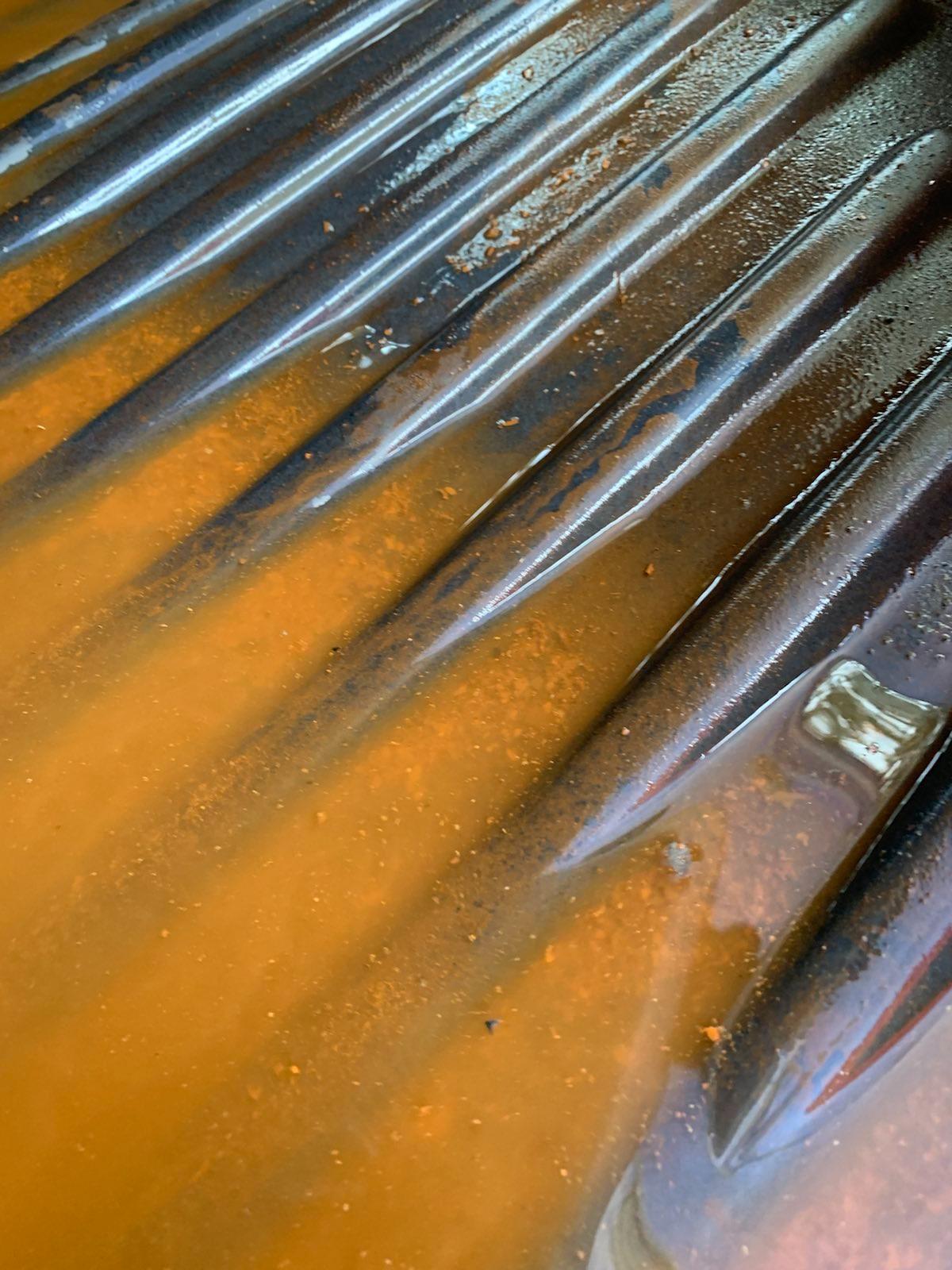

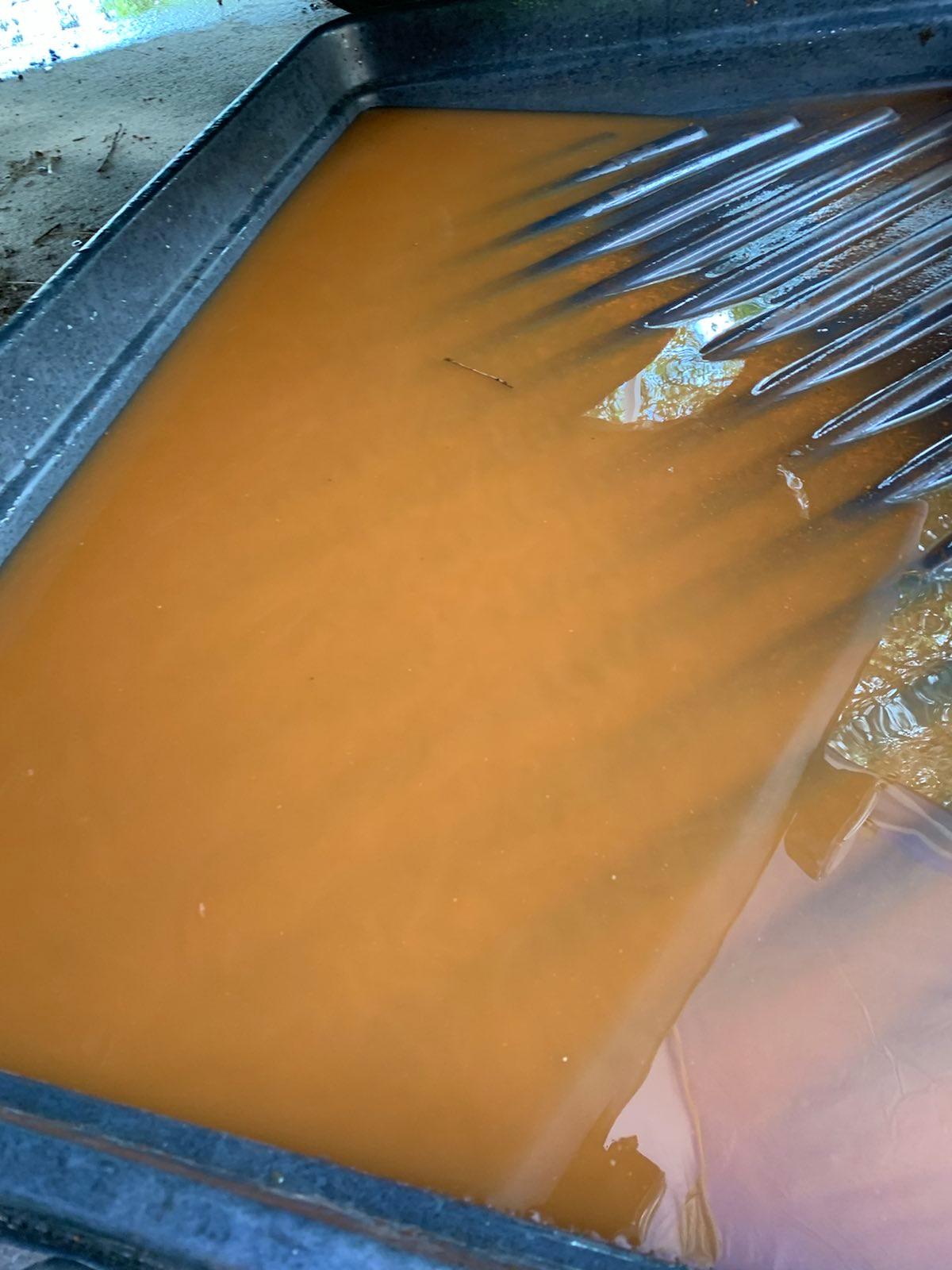

That brown stuff was after flushing everything until clear and doing the block drain. Got about 10 gallons out including my flush water. I did not pull the thermostat out before doing all of this.

The orange crap in that big black pan was the original color when I pulled the lower hose.

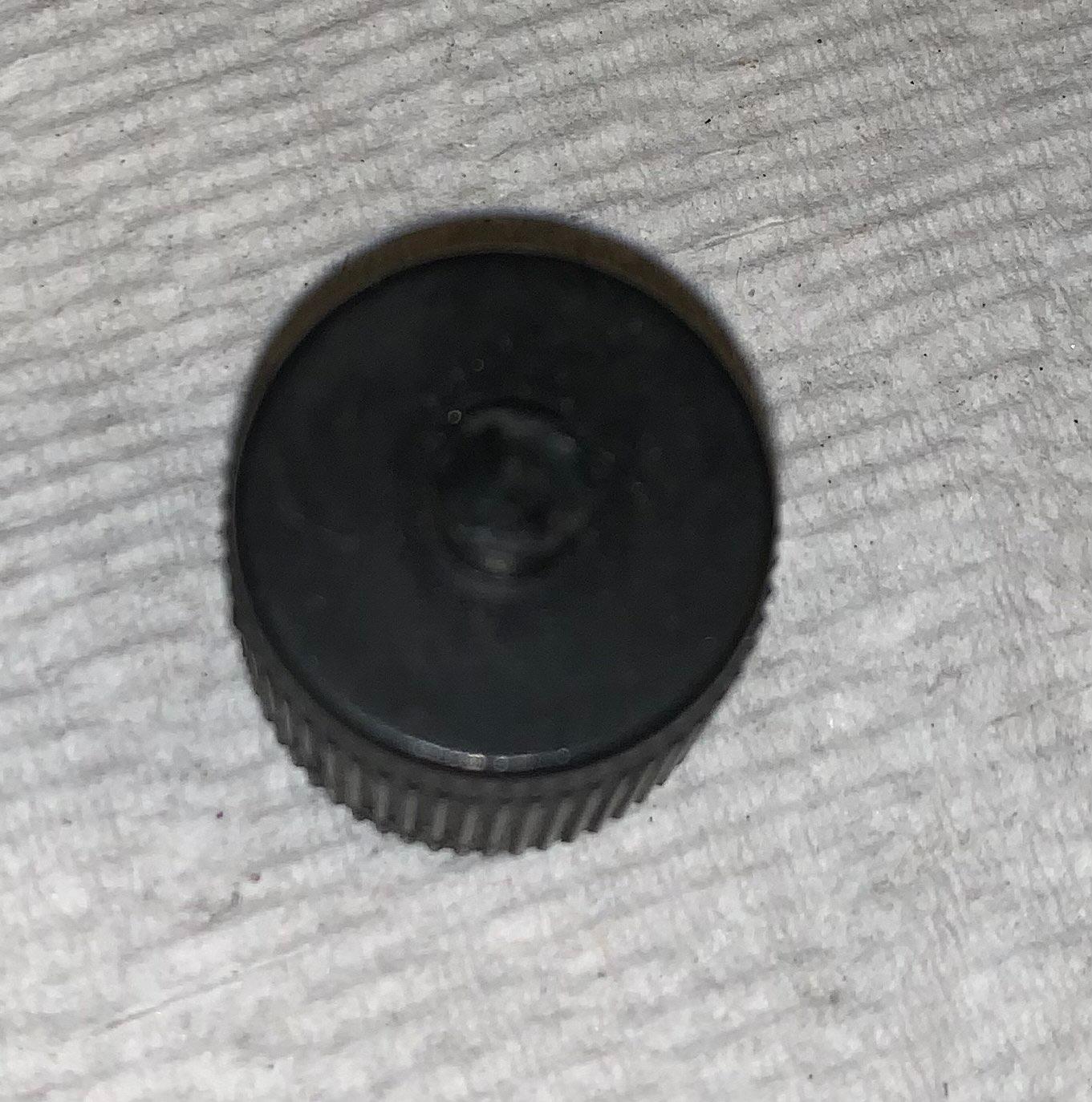

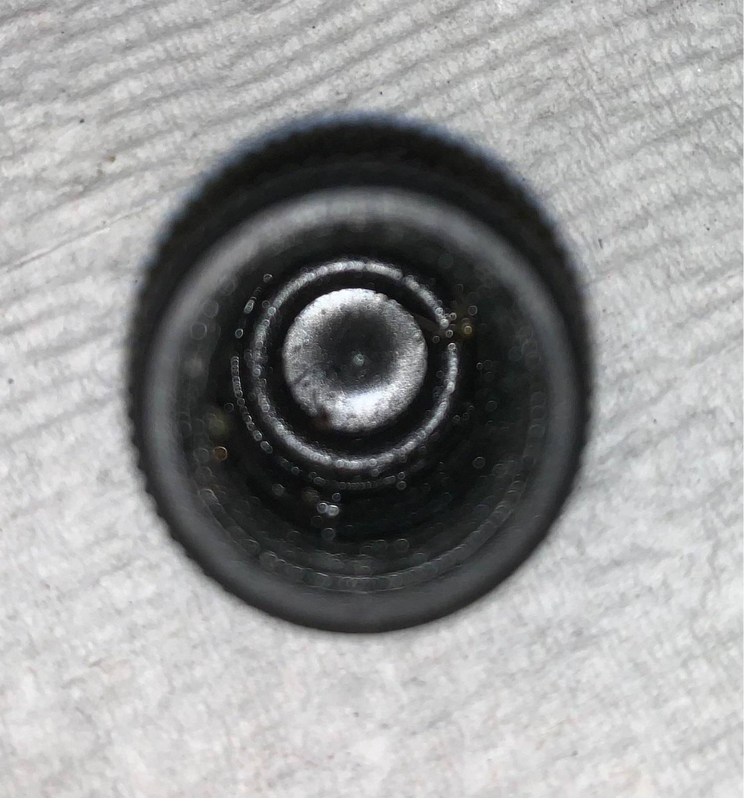

I forgot one other thing. I was working on the passenger's side near the radiator and this black screw cap fell down to the ground. I could not figure out where it came from. Could this be a bleeder cap on my aftermarket radiator? I probably should have did a pressure test. Anyone know what this thing is?

I figured out part of the problem. I didn't read the manual on that spill free funnel. They say to stop after the thermostat opens and the bubbles stop. The issue might have been too much pressure/expansion for the higher temp and nothing to backstop that pressure since there was no rad cap on with the funnel in place.

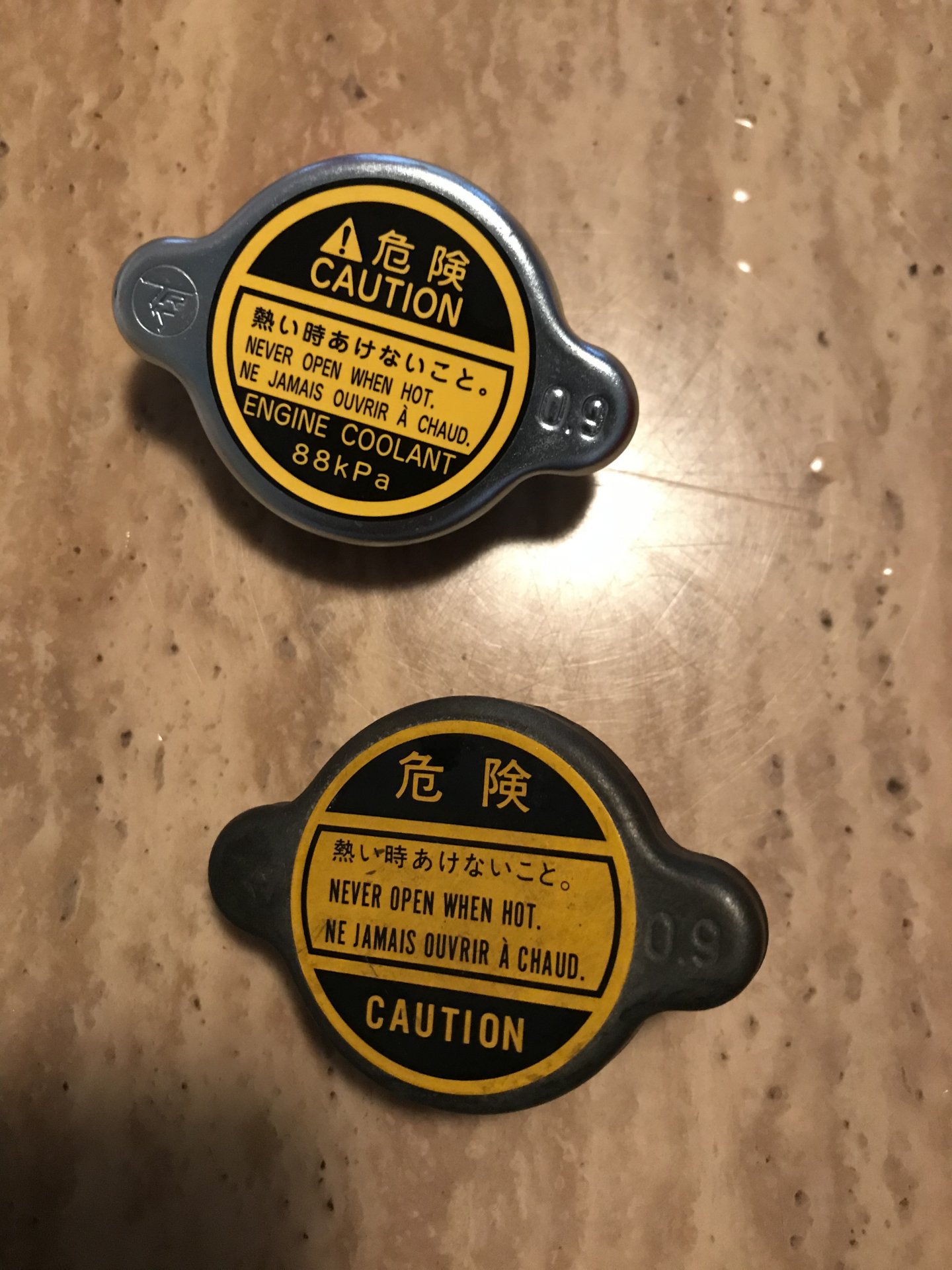

Oh yea and just go ahead and change that rad cap. I didn’t think I needed to on a 156k mile truck but yes u do. I couldn’t get the old one to hold pressure
Will do. Will be looking forward to that last step.
