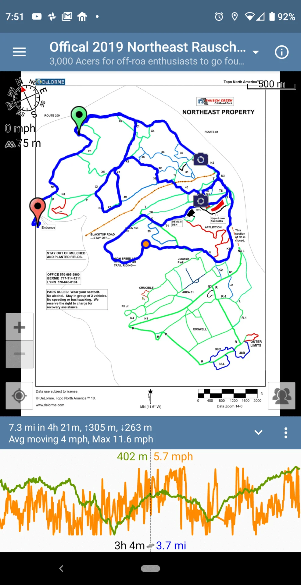

Maprika app has come a long way!

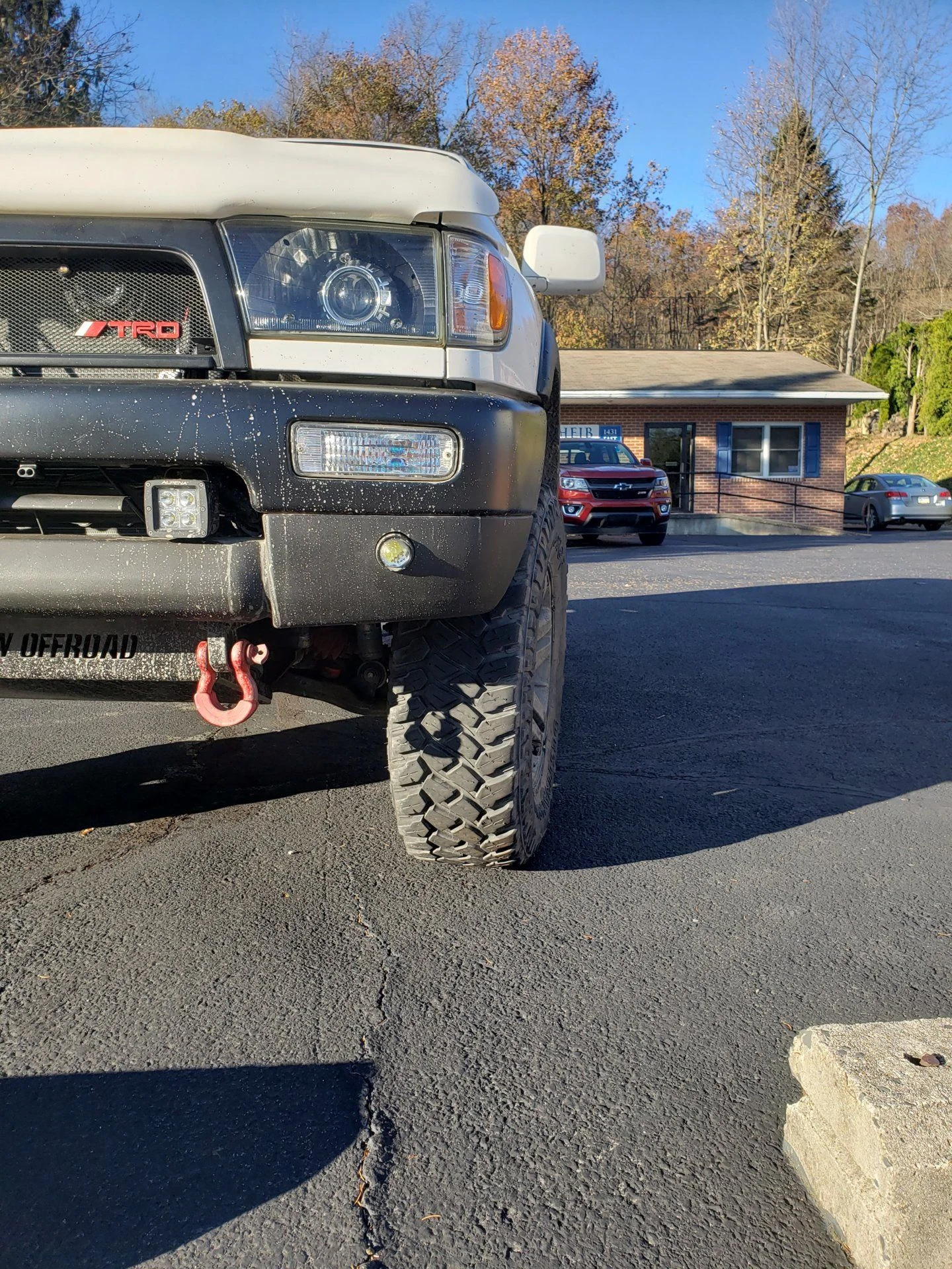

Other than that section, none of the trails we did were particularly challenging. Made for a great green/blue trails day and I think everyone had a good time. Rick did experience a problem with his front suspension it looked like it was toeing in considerably and he ended up deciding to let AAA take his truck home. Looking forward to hear exactly what he finds to be the problem. Was great to meet Sebastian, Aaron's partner, and also to meet Chuck's family. A good crew! Hadn't wheeled with Vince in quite awhile and it was good to see him. A lot of parts were swapped between trucks at the end of the day, all in all a great day for the Keystone cruisers!!!!!

At some point during the day, Rick's 3rd gen front suspension got very toed in, and looked like it had lots of positive camber.
Looked like it was fighting itself, plowing through the trail.
We found a little play in the inner steering rack, but could not determine what was causing the change in geometry.
Blair mentioned the lower control arm alignment tabs rust away, but I didn't see anything a miss under there.
When I am able to remove the skid plate and jack to front end up I will look at the control arm alignment tabs. I will look to see if I see anything out of the ordinary on the driver side and send an update.

Yup very possible. Remember when we did Anthracite a year ago. I was in my last run on the Anthracite 4Runner. When we took that seat pucker drop the cams on the lower controls arms flattened and I had to do a eye ball alignment to get myself home. I'm surprised you never experienced that problem with the Tacoma.
Yup I bet when you pull the skids you'll see the alignment tabs bent for the essenteics for the lower control arm. What I plan on doing and you should do the same. Hammer the tabs back in place. And then run a bead of weld behind them to hopefully prevent future concerns.
Another tip. After your alignment, clean the truck good and make a scribe mark on each cam. This way if it happens again. You can do a quick parking lot alignment that will get you home if you don't feel like calling AAA or don't have it (like me...)
