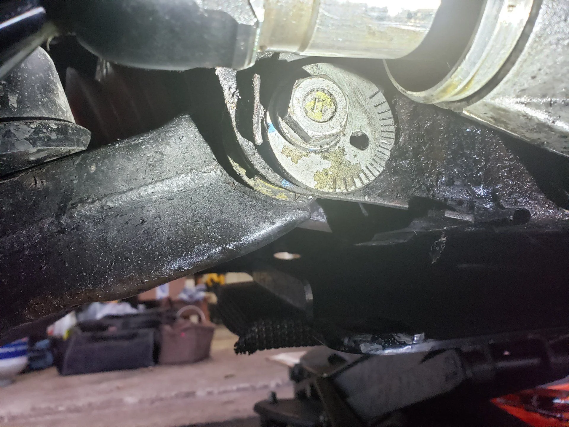

Well the verdict was the drivers side cam adjuster bolt was loose @YotaFun mentioned. So I forgot that I did make marks on the adjusters. So i was able to readjust the adjuster and I am aligned and good to drive. Thanks!
