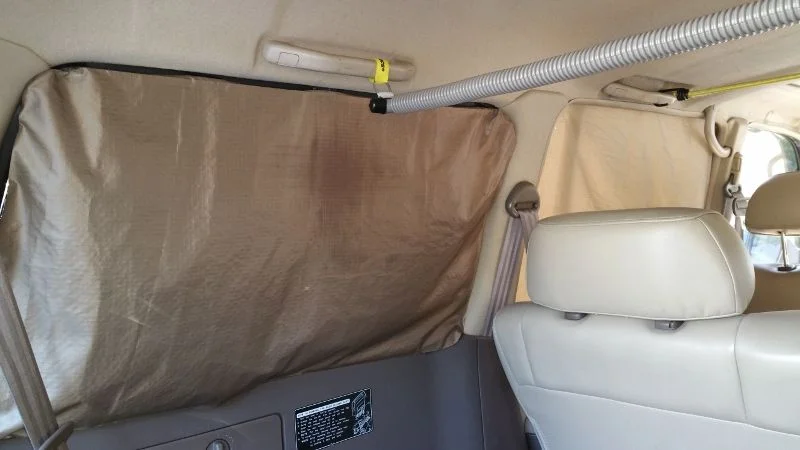

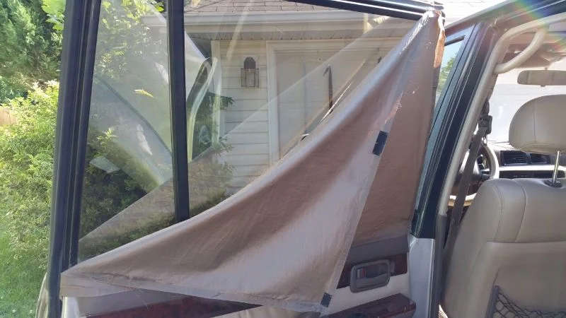

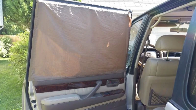

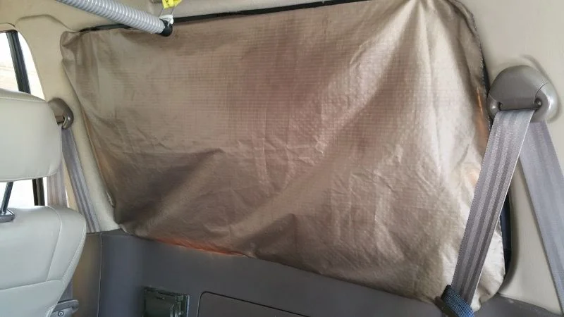

You can use mylar covered bubble wrap they sell at home depot to cover your rear windows. I have that with small velcro squares to hold it to the windows, and some brown nylon ripstop curtains that velcro to the rubber weatherstripping on the inside of the rear sliders. The rear window curtains are two layers of the brown ripstop, made em 5 years ago or so. I also made a double layer curtain for the rear window for privacy, held with velcro. I also made some single layer ripstop curtains for the rear door windows to put up when we do road trips. I put the mylar up about a month ago, and it has knocked down the cargo area temps by about 10-25 degrees. You can also use that mylar bubble wrap around your fridge or cooler too.
Have any pics of how this looked all set up?
I'll try to take some this evening and throw them up.

Let me see if these will work

Hancock Fabrics had it when I built them in 2007 or so. Ripstop Nylon. It was in their outdoor fabrics section. I bought about 10 yards of it on sale with a 45% off coupon. Joann Fabrics might have it too. I used a woodburning tool on a piece of metal to cut/seal the edges. The double layers get fused together by the wooodburning tool.
If I were to do it fresh from scratch, Id make single layer panels, and use 3m adhesive spray to stick the fabric to the mylar bubble wrap. This way they could be rolled up, folded, etc.

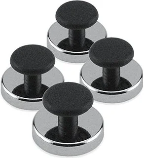

I put a strong refrigerator magnet on the lid to make opening and closing easier.. It works great!
