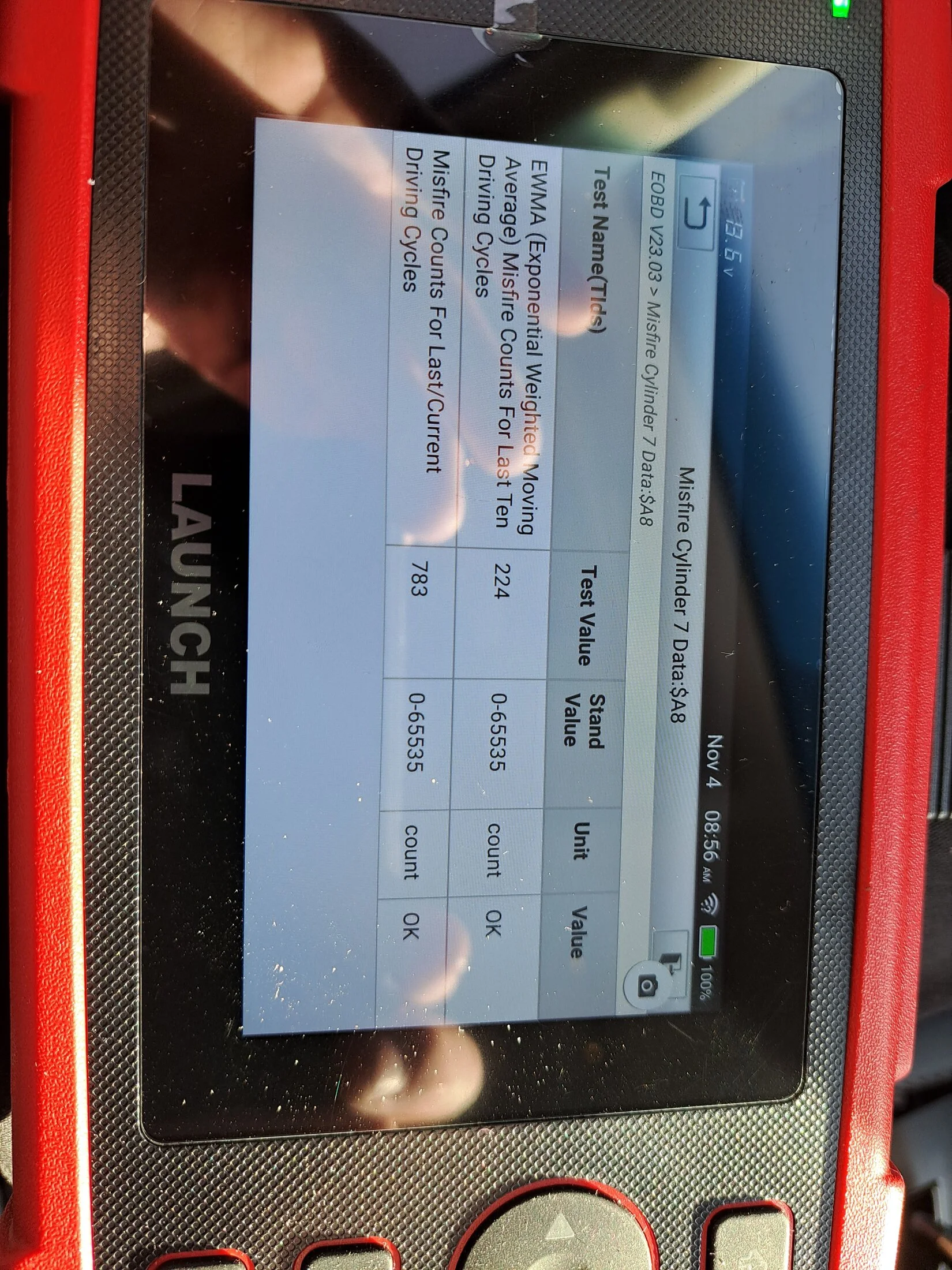

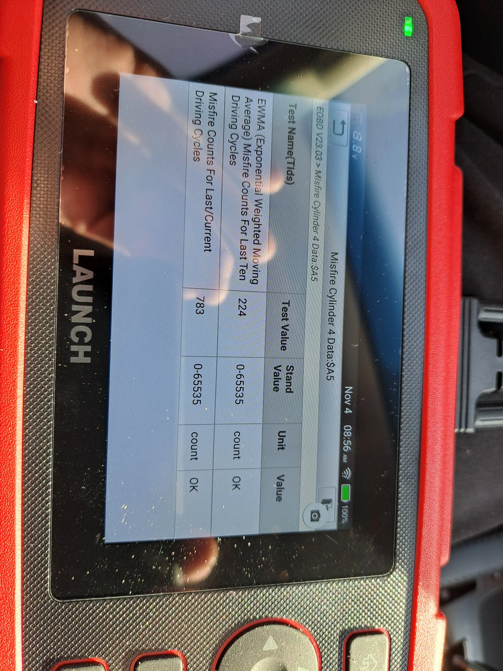

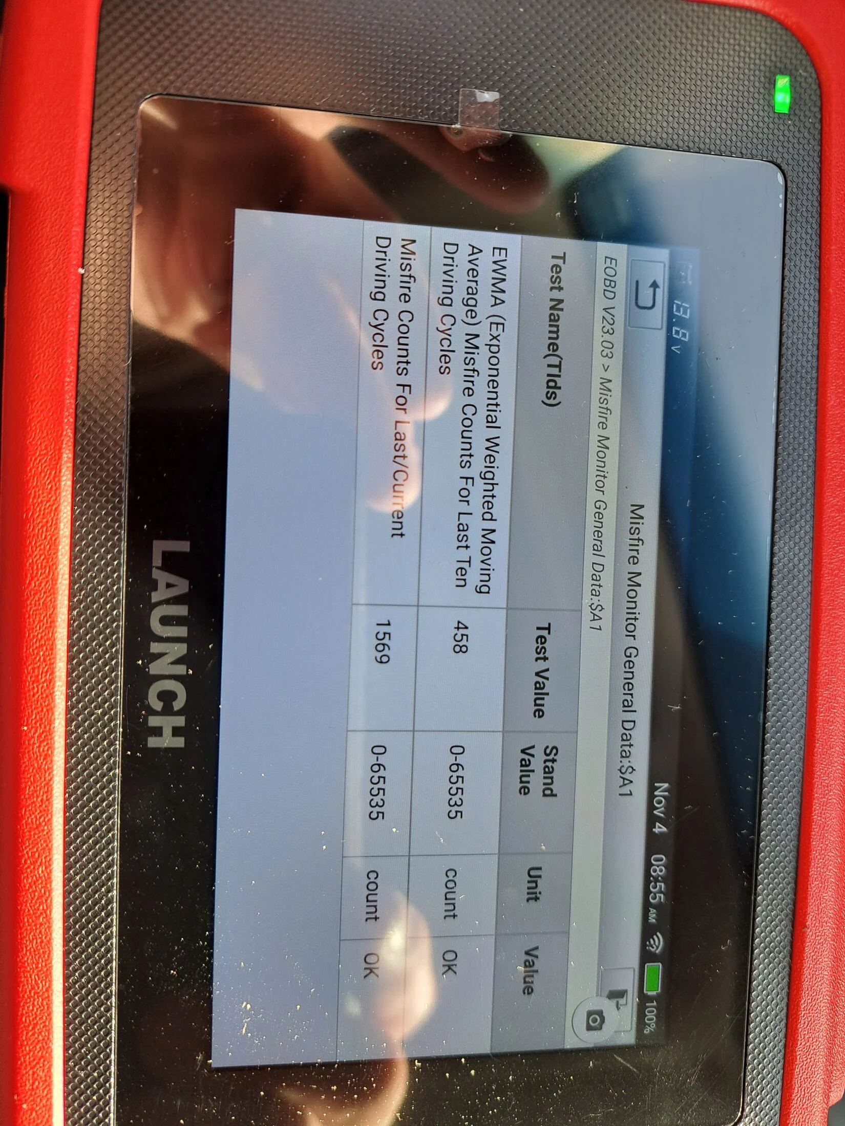

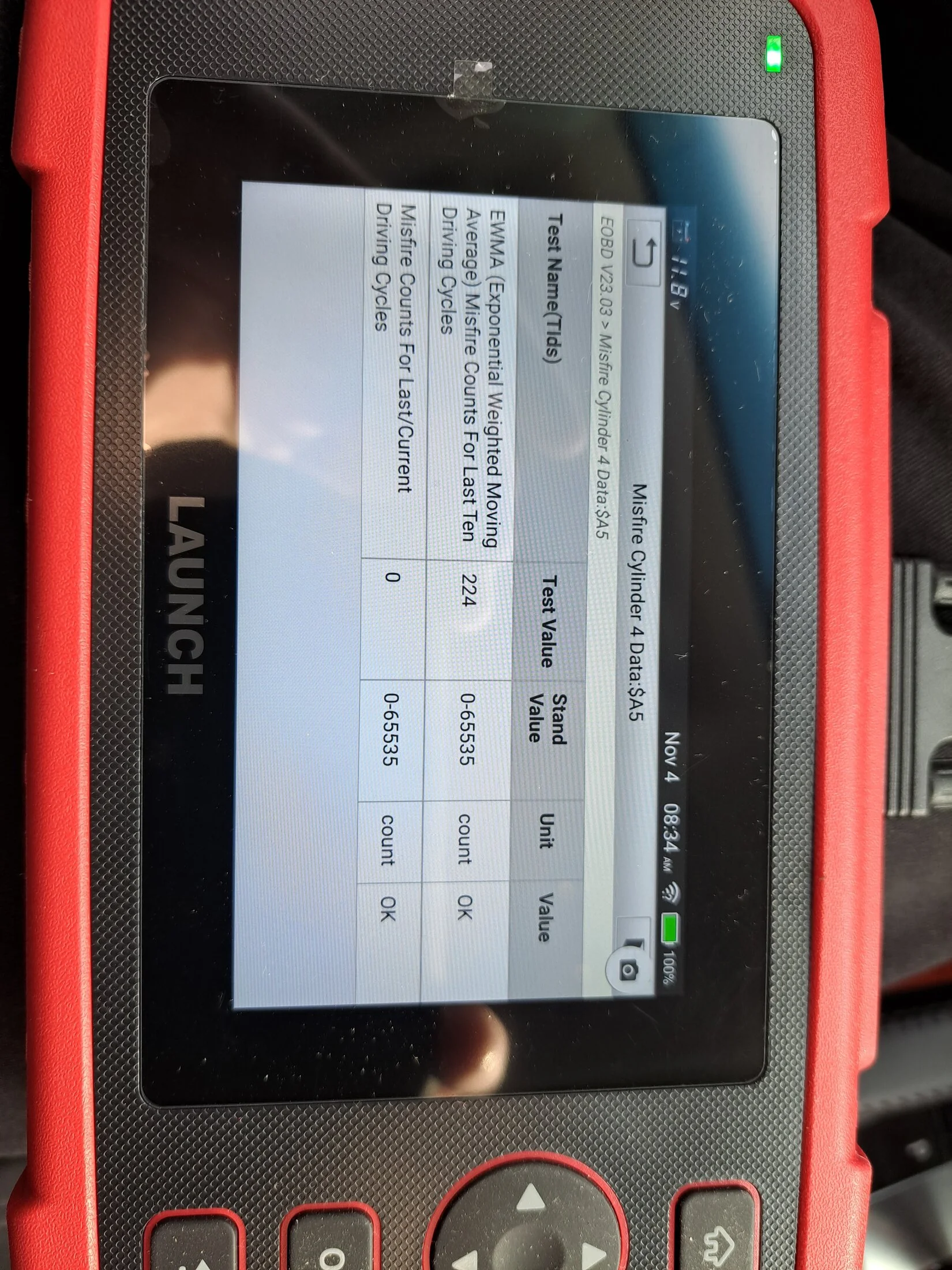

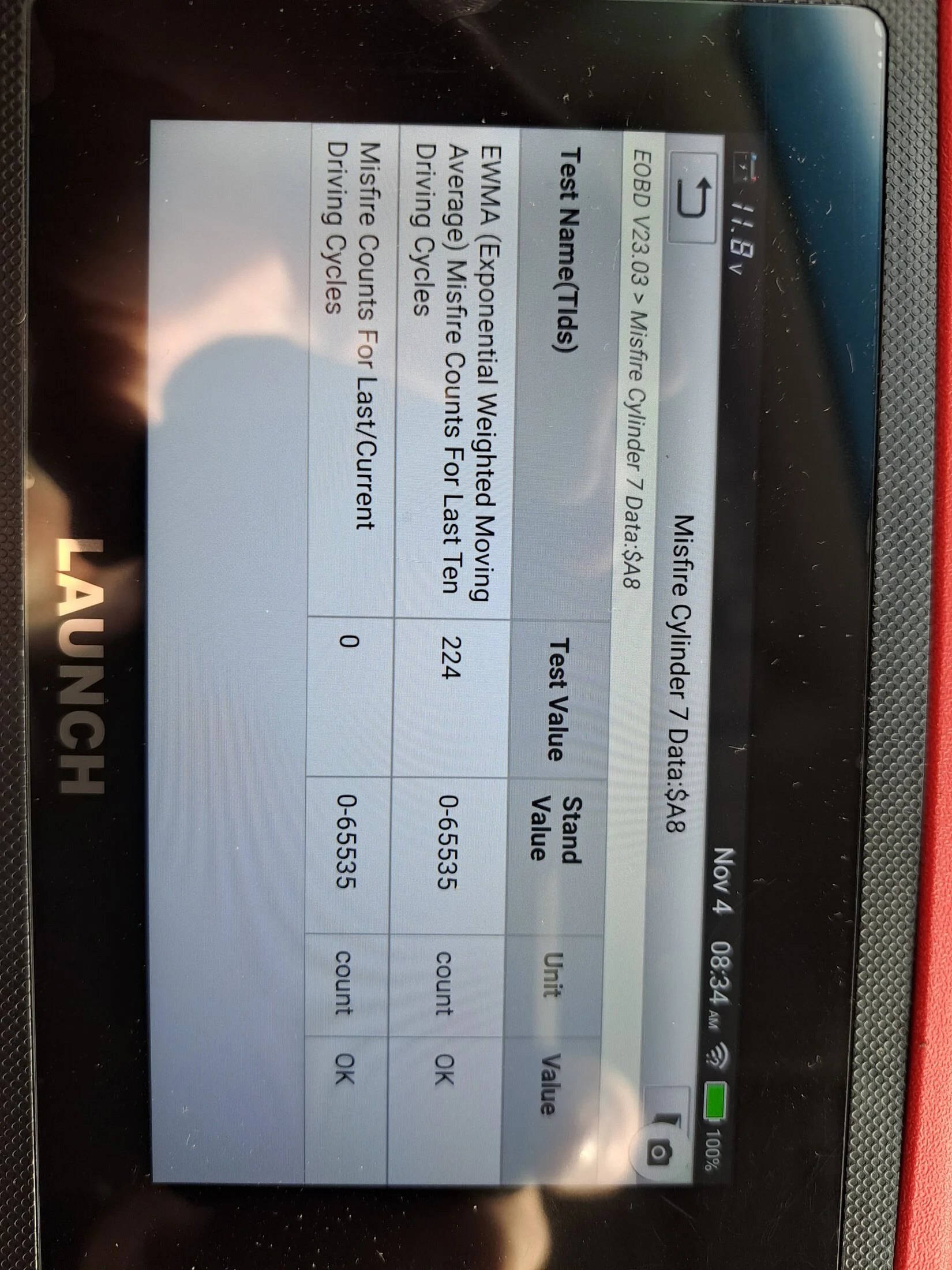

I hooked up a scanner I got from Amazon and got the following info. The 783 misfire count showed up once the truck went into limp mode and engine light started flashing. Can anyone comment on the significance of the 783 number being the same on cylinder 4 AND 7? The other pictures show the data while engine is running but before the light starts flashing.
Also noteworthy is when it's in its protected mode air/fuel voltage is very high 4.5 v plus
