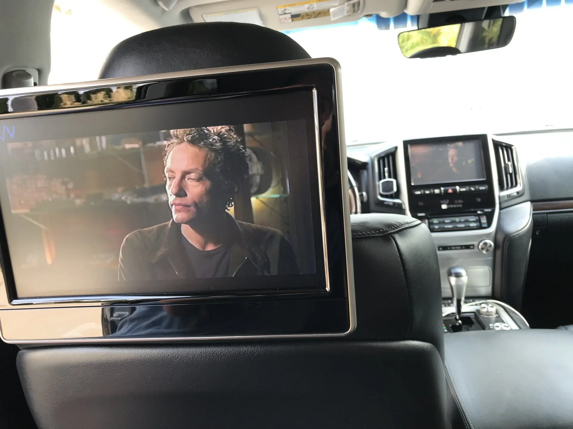

AV Source in the rear did nothing. Last night it mirrored (audio and video). AUX in rear which did nothing last night now has audio from the front but just the "AUX" Source icon on the screen.
Tried using HDMI and DISC on both screens.
Drivers side was fine:

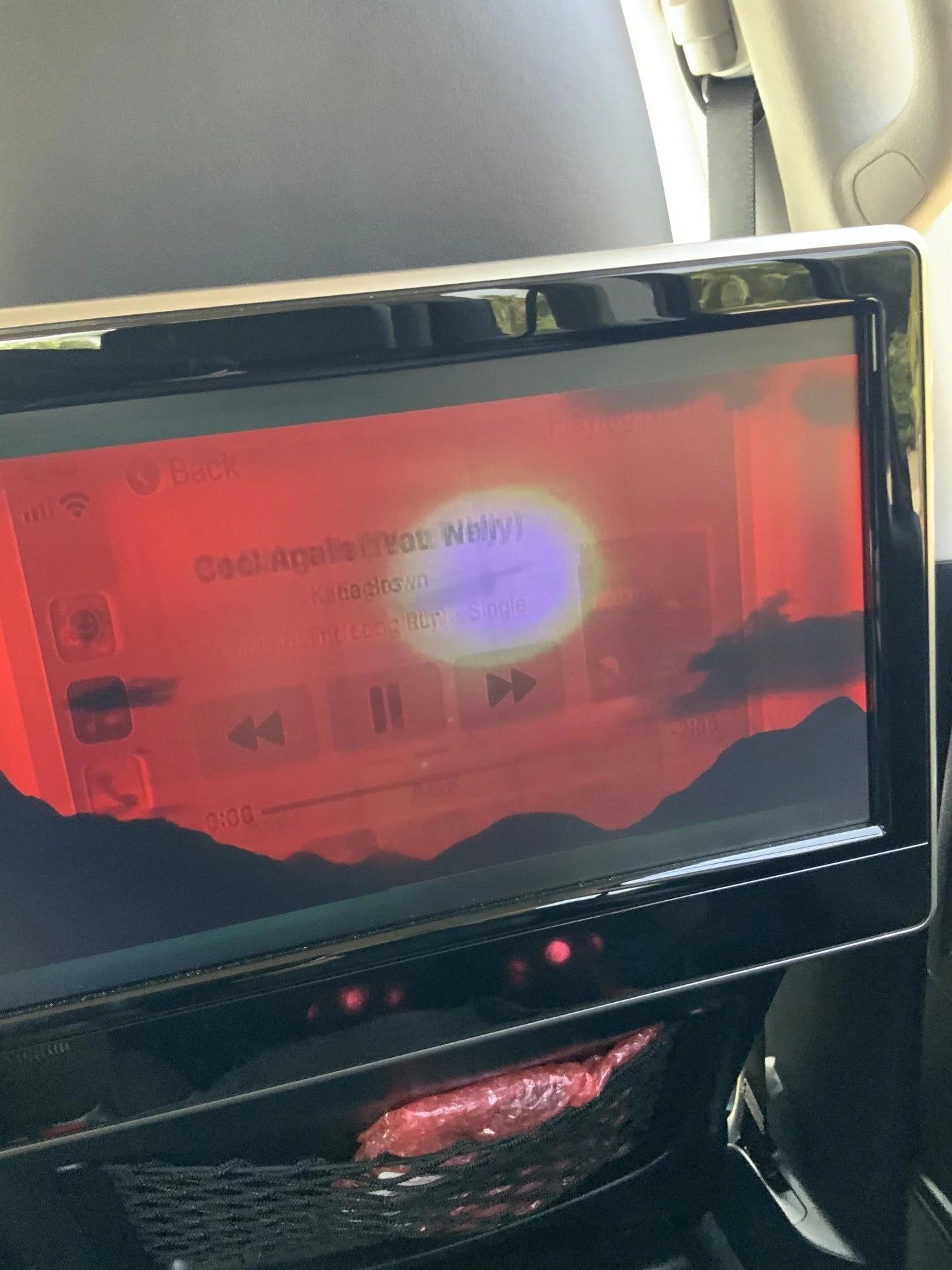

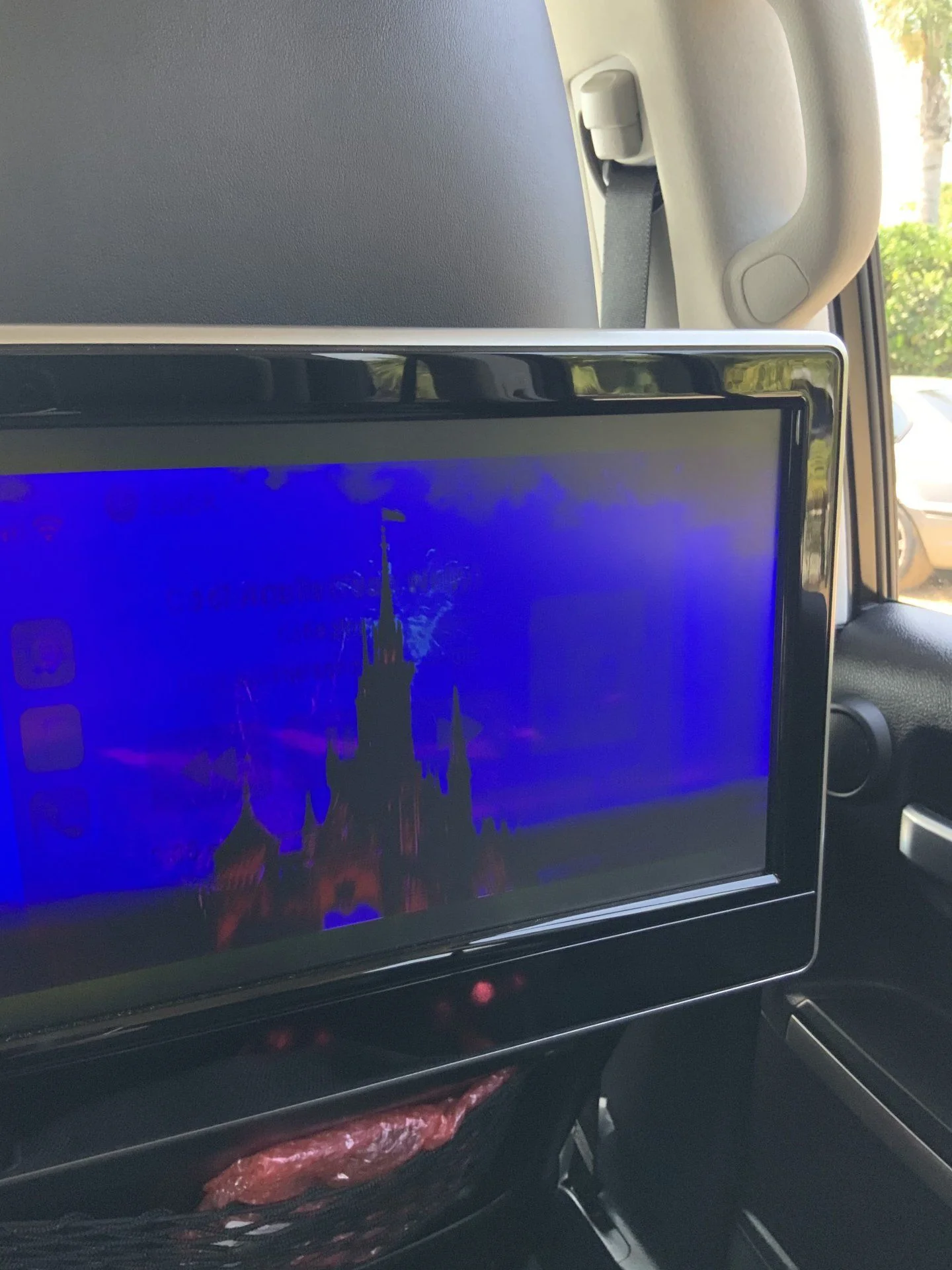

Passenger side was dark and ghosting Apple CarPlay...
Ghosting can be seen here as well...
Even with CarPlay disconnected the ghosting remained. Weird.

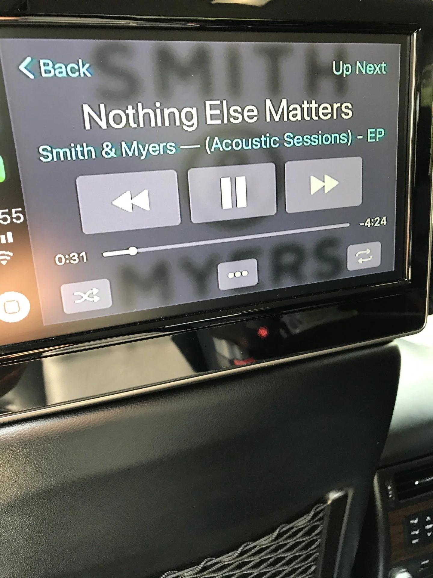

I did a bit more testing today. I had no issues using the AV source in the rear this time. Every time I switched to it, it mirrored the front unit with both audio and video. In reverse all the camera views came up as normal on the front screen and the rears did not change.

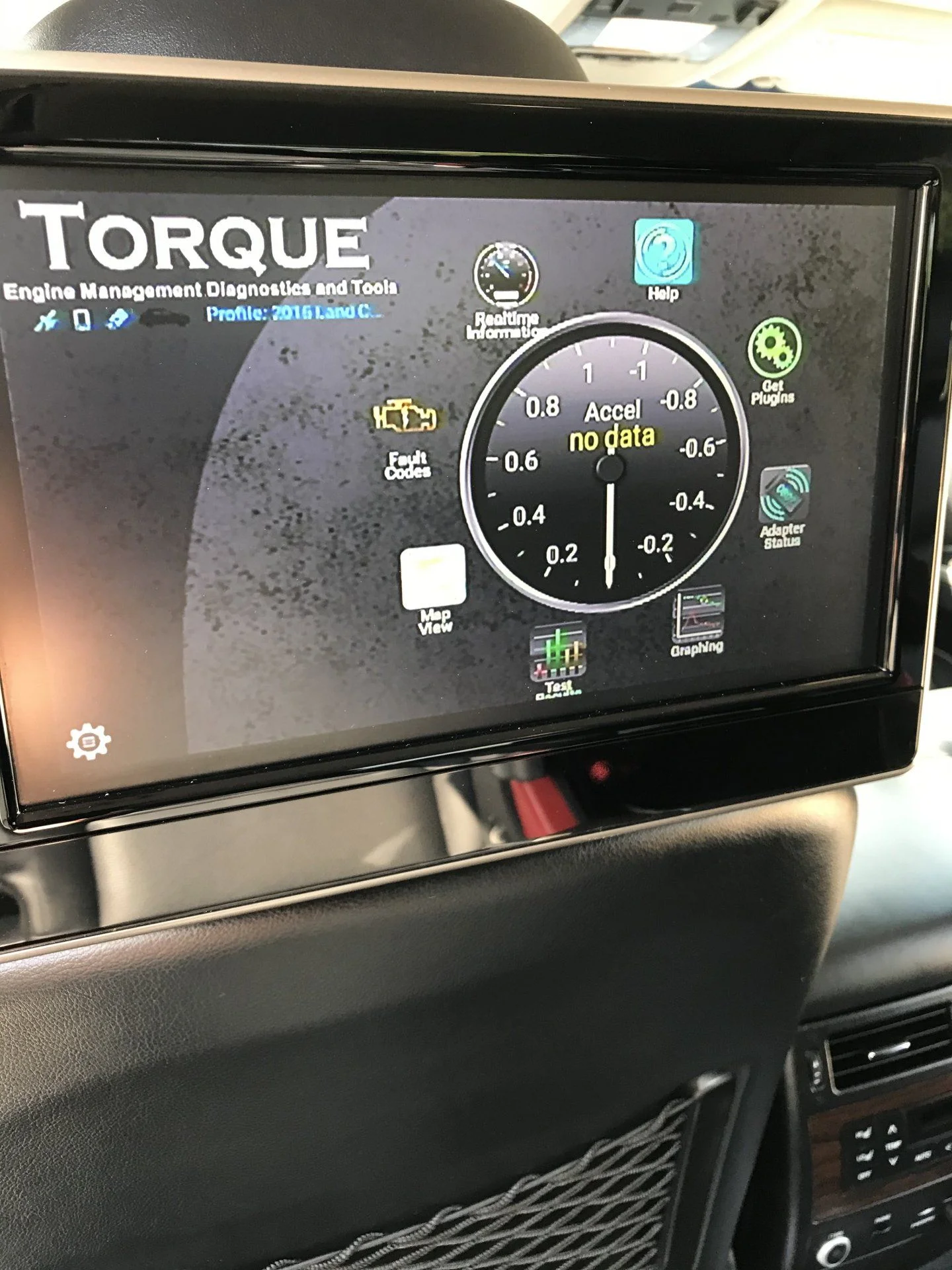

CarPlay showed CarPlay. Waze showed Waze. Netflix showed Netflix. Torque showed Torque. Media Monkey showed Media Monkey.
Anything I displayed on the front went to the rear screen with AV selected...

I still have the ghosting in the right rear screen. I have not heard yet from EC on the ghosting but did update them with an email stating that the rear AV seemed to be working now.
I also tested two different sources on the rear screens and can say with certainty that it can be done. I don't know how I did it but I had HDMI on the right rear from an ipad and AV with netflix on the left rear. The audio was not ideal with the wireless headsets. The left rear played Netflix wireless flawlessly. On the right the wireless kept picking up both sources and was switching back and forth like crazy. Untenable. Both audio plugs with wired headphones worked fine for each screen.
Once I switched sources using the remote both rear screens were on the same source again. I tried for 20 minutes to get back to having one display a different source but it's beyond the amount of time I want to put towards it. We have one kid. I'm sure someone with more kids knows exactly have to switch to different sources but I'm not that guy.

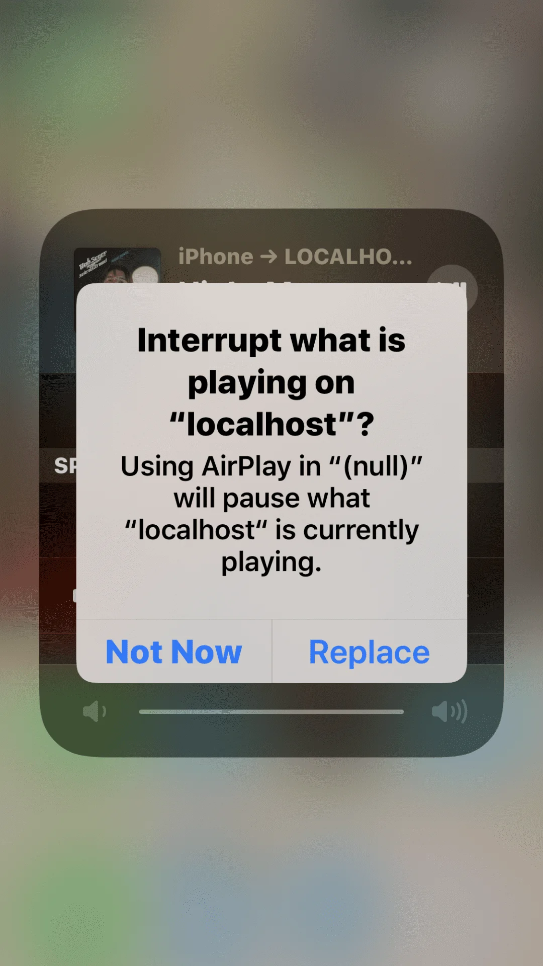

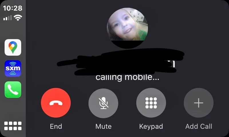

I also messed around with the Bluetooth and phone calls. I haven’t really sorted out exactly what is going on. When connecting to carplay the startup screen says not to connect BT but that’s not very realistic. BT is on to make phone calls through the OEM system. I guess I need to look at the BT settings on my phone to see what it’s connected to. You can also make calls through the EC system using Siri in CarPlay but maybe that’s wired? I need to pay more attention and try it out some more. I have used both and you can select which one to use on your phone the way you would chose “speaker” after initiating a call. So it looks like local host is wired CarPlay and BT is the OEM system.
No matter how I initiate a call I can change it on the phone.
At one point while listening to music I noticed the audio changed speakers and I was trying to figure out what was going on. I think it was switching between the AUX output of all the speakers and the small EC speaker?
These were the screenshots from the phone and the head unit...
I think what’s happening above is the ability to play the music through OEM system via BT or wired CarPlay?

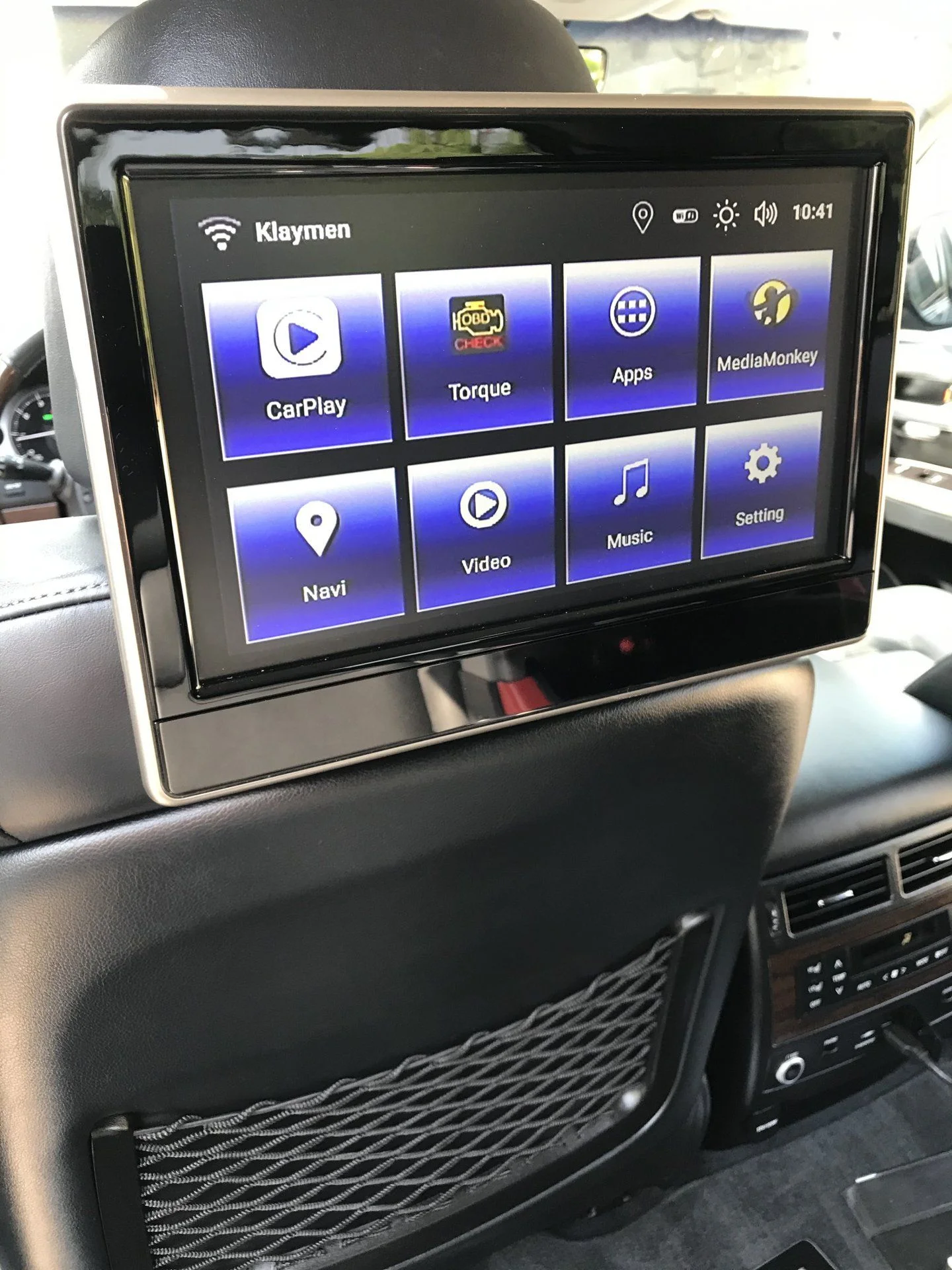

OK some great news for those that care about the rear screens...
Geoff's recommendation for a wireless mouse was excellent. I drove down the hill to Staples and picked up this wireless USB mouse...
This allowed me to control the EC environment exclusively with a mouse if I desired. No setup. Plug in USB dongle to USB 1 or USB 2, pull battery protector tab on mouse. Use mouse. Mouse arrow shows up on the rear screens.
I started with the rear screens in AV and it controlled everything in the EC environment. The front unit changed as well when it is in AUX mode. So if I changed the app in the back it changed the front to the same. Audio and video. Doesn't seem to be possible to use 2 different android sources split front and rear at the same time. I think that's reasonable.
But then I changed the source on the front screen to SAT and it switched to the OEM system, and I left the rear in AV. I got SAT radio on the front with audio from the OEM speakers and the rear screens remained on the EC unit. I could then use the mouse to make changes on the EC unit which no longer affected the front...

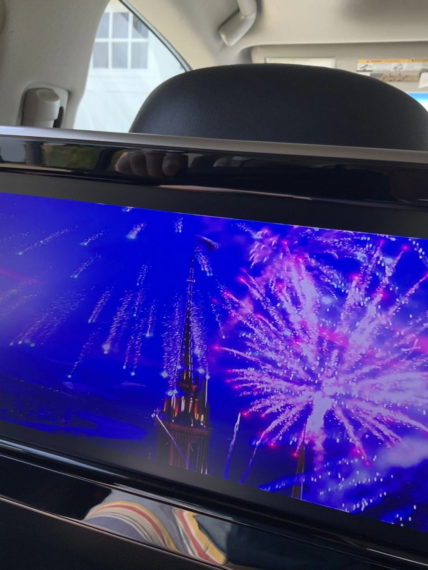

CarPlay in rear with SAT/NAV split screen in front...
Android home screen on rear with SAT/NAV split screen up front...
Netflix on rear with SAT/NAV split screen up front...
The one thing I could not figure out how to do from the rear using the mouse was escape CarPlay to get back to the android home screen. On the head unit up front you push the home button while in the EC mode. Not sure how with the OEM system running up front. Getting back to the android screen from Netflix is easy as there is an available back button.
I think this is pretty sweet. I don't know that I would use it a lot but some others might find it very useful. Just realize this is me sitting in my driveway putting this thing through it's paces to try to test everything out, not real world trips. Your mileage may vary.

The ghosting issue also affects the HDMI and DISC sources when I’m in the OEM system so it must be some kind of bleed over from the EC unit but not sure why it would be on one screen. If I need to I’ll unplug the rear screens and the kid can use the OEM stuff like she always has.
