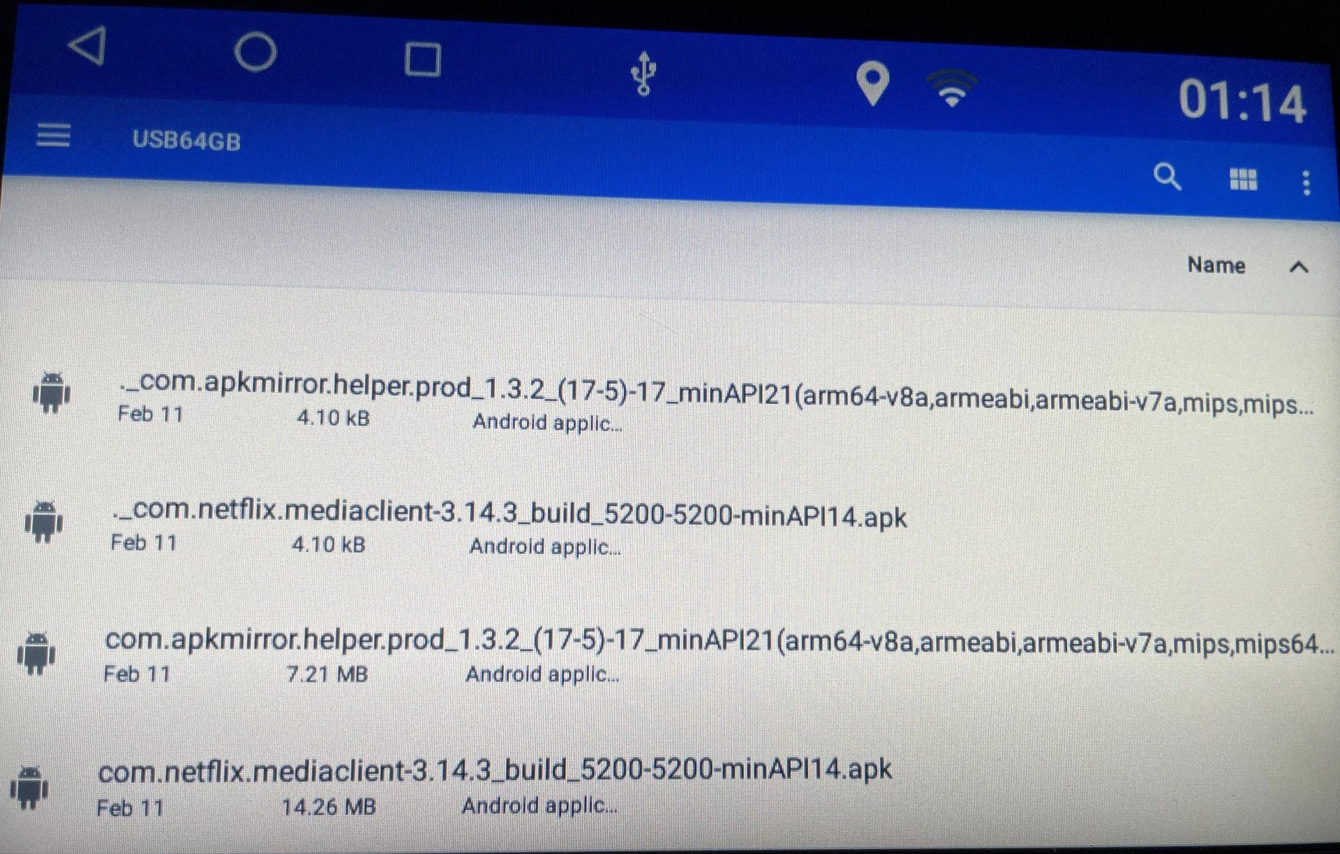

I used the app that shows up with a name of "Files" in my app list, which I believe is that ES File Manager app I mentioned. I just had to select the USB drive, find the APK file in the list, and tap on the file to initiate the install. After it installed, I started the Netflix app, entered my login info, and was all set.
And here's what the APK files look like in the native Files browser app - now that I look at them, they're nowhere near as large as when I downloaded them, so maybe that's part of the problem, but still doesn't explain where to find them within APK.

I'm using Windows 10 and Firefox on the PC side of things. On the USB drive side, I'm using a SD card with an NTFS partition in a USB 3.0 SD card reader. It looks like your USB drive is getting recognized just fine, so I doubt there's an issue with your USB drive. When I installed Netflix yesterday, I had downloaded a couple of APKM files as well as the APK file I linked above. The APKM files would not prompt me for installation, only the APK file did. I didn't know what APKM files are until a few minutes ago, but apparently the format allows for the Play Store to do more efficient downloads (only get the parts that are needed for the specific device) and need to be installed with a special app (Split APKs Installer and it sounds like the APK Mirror Installer app can also install them). So if you happen to have a need to install an APKM file, make sure you install that app from the Play store.
The Netflix APK file I did install is 57MB in size, so you would want to verify that it shows up as about that size (it may report as 56MB depending on what calculation is being used for MB as some use 1000 bytes while others use 1024 bytes).
It sounds like 1 potentially big difference in our workflows is your mention of selecting the APK Mirror Installer as the installer - I don't have the APK Mirror Installer app installed. When I tap on the file in ES File Manager I'm simply presented with the option to install it (there's no mention of any app, I assume it's just using the device's native installer). So I would suggest trying a combination of downloading the APK file I provided the link to and perhaps uninstalling the APK Mirror Installer app and see how that goes.

Finally got this to work, thanks for your help! I changed several variables so it’s hard to say exactly what worked:
- reformatted the thumb drive to NTFS
- downloaded the APK file you sent directly to the drive within a Windows 10 environment instead of Mac OS
- used the native package installer instead of APK Mirror Installer
