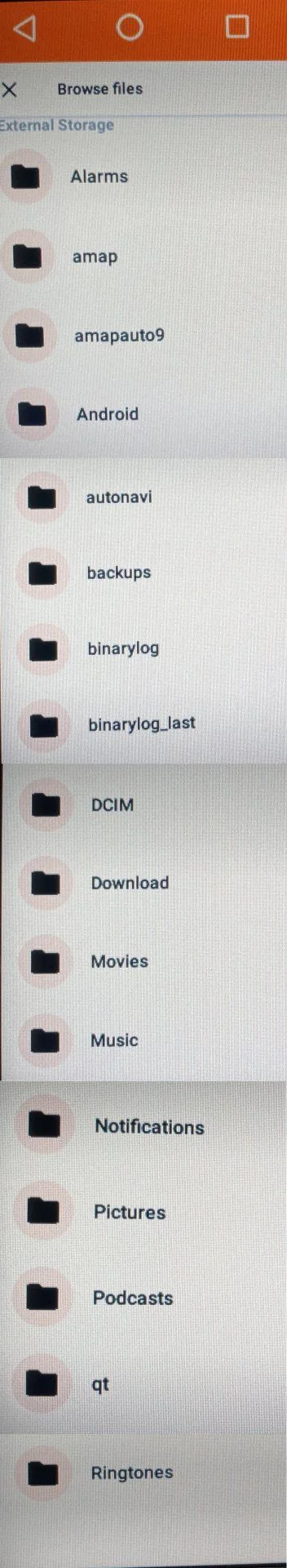

Something went wrong in the quotes above so I can't quote it, but some of the Android apps treat USB drives and SD cards as folders off of the main volume, so they may be hidden inside a folder rather than show up as a separate drive. If you post a picture of what you have in the file browser at the top folder level, I may be able to guide you to where the USB drives are. I'm kind of new to Android too as I've been primarily a Windows and iOS person for a long time. I've had a Samsung S8 kicking around to "play" with for a few years, but never spent much time poking around with it until I got the EC Offroad unit. But I am a software developer, so I can usually figure this stuff out if I spend some time with it (and some quality time searching on Google...).

Thanks for the offer to take a look - here's what I see in the browser inside the APK Installer:
And here's what the APK files look like in the native Files browser app - now that I look at them, they're nowhere near as large as when I downloaded them, so maybe that's part of the problem, but still doesn't explain where to find them within APK.
