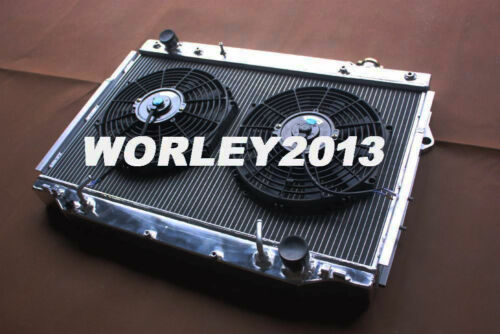

Had to notch the aluminum angle on the side of the radiator at bottom below the filler to clear the core support and radiator mounts.
Have to add a small nipple for the bypass hose the runs to the head behind the distributor.
The fan shroud mounting holes have to be moved over a few inches.
The lower outlet tube is 1/8" smaller than the factory so you'll need an extra hose clamp or make another lower hose.
I already had a trans cooler in front of the radiator, so not having one in the bottom of the tank was not an issue for me.

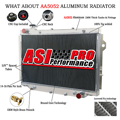

What does USA stock mean….

It doesn’t look like the Chinese version though the reviews do state trimming the fan shroud. If there’s heavy modifications like adding the top nipple then you’re better off just going the Ron Davis route few $100 more.
I’m really thinking about ordering the eBay aluminum one without the trans cooler stuff.
not so worried about things lining up perfectly, I need to reroute the lower hose right now, and thinking of upsizing the outlet and inlet to 2” to match the Cummins to simplify the hoses for tight bends and then delete reducer I have
The ebay version for <$300 has 3mm walls for the tanks. At least mine does. They weld easily with a Tig. The tanks are nearly thick enough to just drill and tap vs add a drilled and tapped boss for the nipple.
There are versions of this Chinese radiator with the trans cooler by the way. They're all over the Australian ebay site, some seller here is flogging a bunch of them.

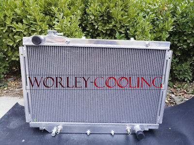

Six months in my 4 row version for $300 off ebay is fine. It was missing the trans cooler but I have another one in front of the radiator anyway. Had to do some nibbling near one lower corner is all. If you are willing to pay $1500 for an aluminum radiator I will offer to make you one custom in any thickness you wish and I'll even anodize pictures of your friends and family into it. Versions are also available in silver or 24K gold. PM me for details :)

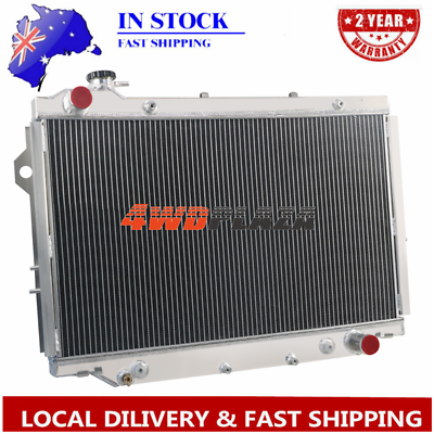

I got this 4-row aluminium ebay radiator for my HZJ80:
I picked it up for $275 AUD shipped on an offer, but it's not actually installed, just sitting in the box for a rainy day. Looks reasonable though, can't see anything wrong with it.
I'm actually going to put a new OEM radiator back in next, which I've already picked up. I figure the old one has lasted 25 years (and counting) so a new OEM one seems like the way to go. That said, I might change my mind in the future, and a solid aluminium radiator for $275 seems like something I can safely drop money on now and mostly recoup later selling it on if I decide I don't need it.
I'm interested in increased cooling capacity as well, huge issue with the 1HDT at arid elevations (most of my driving is at 4-8k feet).
These 4 rows seems to have a core 2.75" thick....my current CSF is 1.75" thick. There's an extra inch between the fan and OEM radiator in there?
