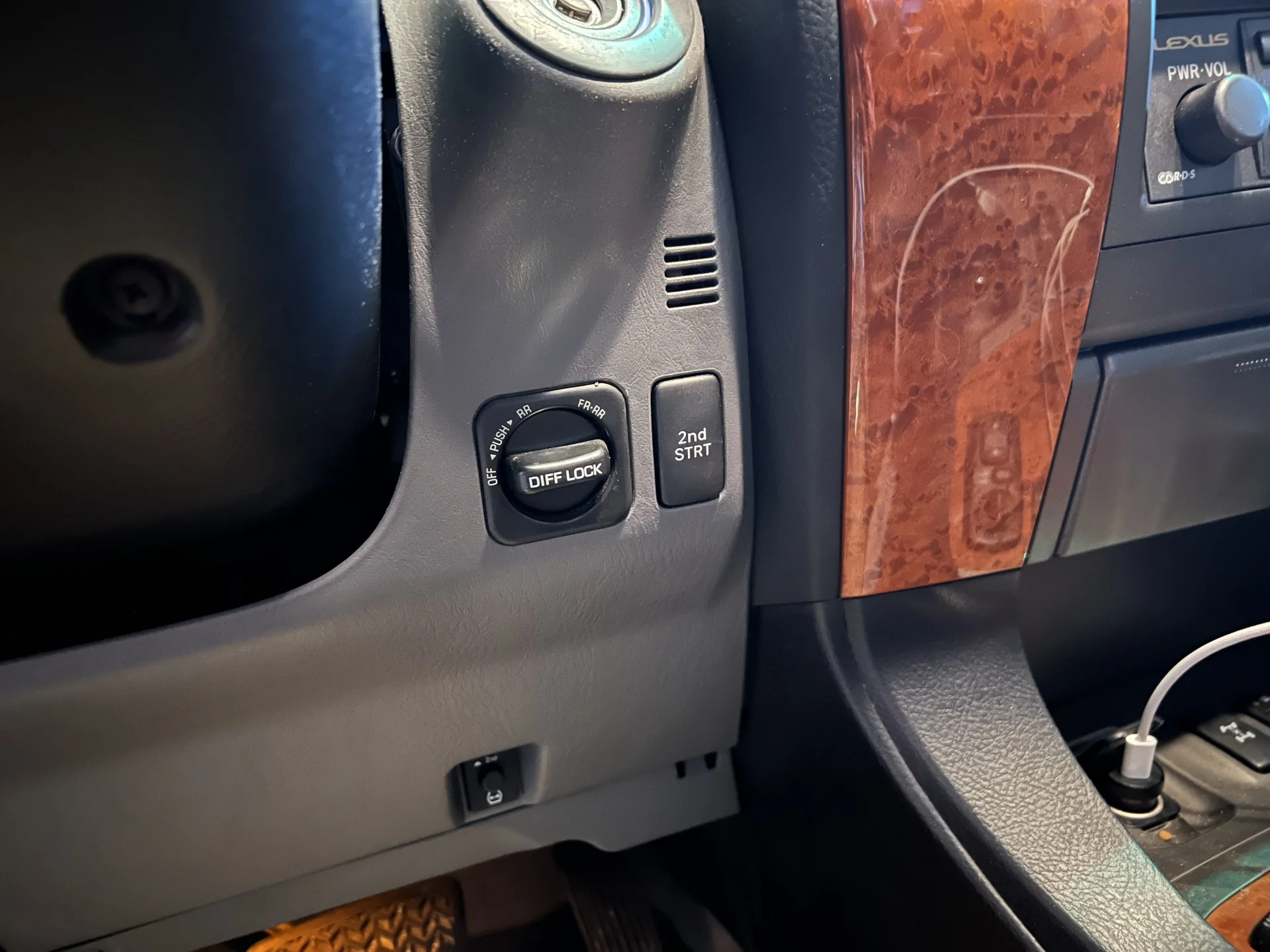

There is a blank hole tight next to the ‘2nd start’ button for a factory Toyota front/rear locker switch like you would get in a LC. It's almost as if it were made for one! I would guess the 460 has something similar.
