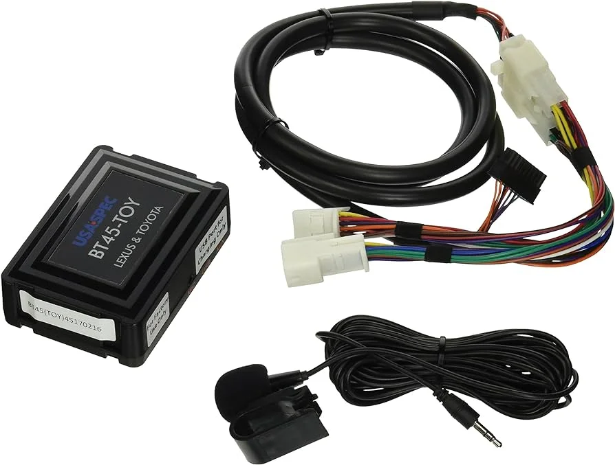

I'm putting a plug out for those who are frustrated with the lack of modern music options in their LC100, and don't know what to do. Today I bit the bullet and spent $200 on the BT45-TOY adapter and CAS cable and 1 hour total for the installation. It was the best move I could have made. I picked up all equipment from Crutchfield here in Charlottesville, but you can locate the same at various retailers online (cheaper, too).
Here's the adapter in case you've never hear of it:
Amazon product ASIN B0178G5RRE
If you have the navigation unit, you'll also need this CAS TLC cable:
I was going to make a video, but honestly this one helped me out and I couldn't have added anything that he doesn't cover:
Once you get the trim and radio unit off, it takes about 10 seconds to connect the adapter. No more cassette with aux cable!

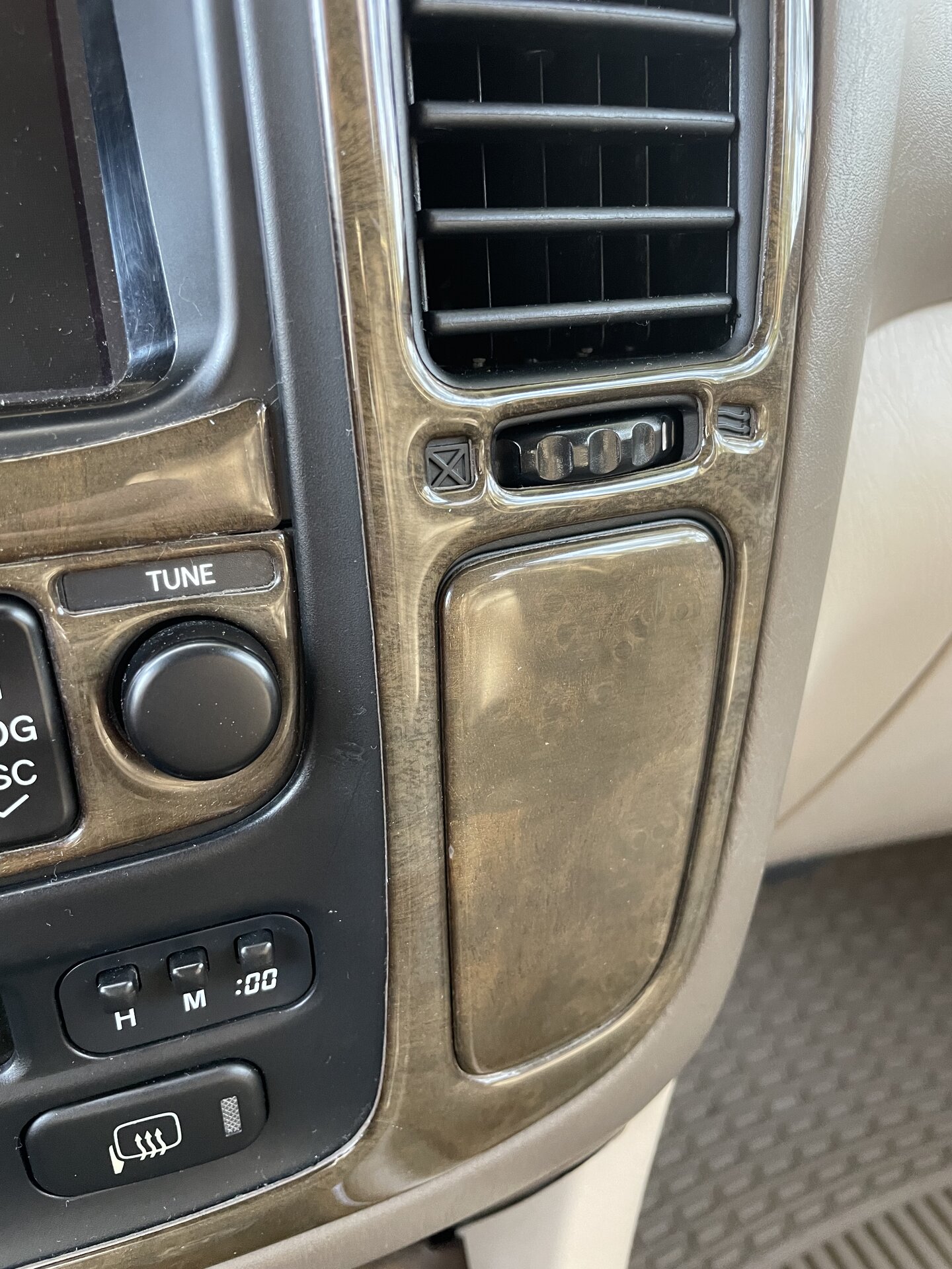

My Bluetooth calling works great; I stored the unit behind the right blank dash panel and ran the audio cable behind the steering column, and then from the floorboard up to the driver’s side pillar. I’ve had no issues with people hearing me clearly.

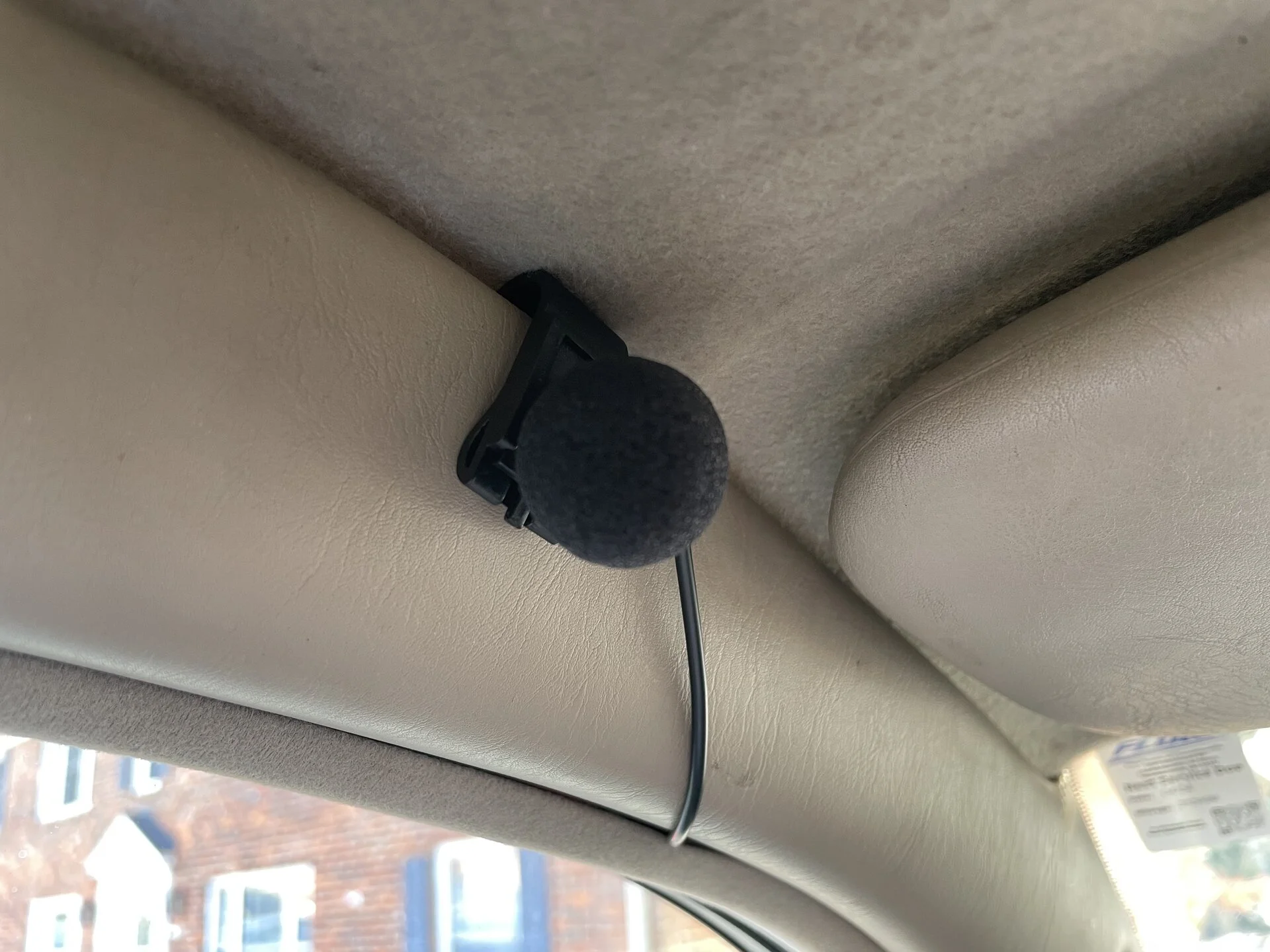

I have my mic on the upper driver corner of the windshield behind my visor. Sound is decent but I wanted something discreet over optimum sound quality. Folks can tell I’m in the car but sounds fine.
