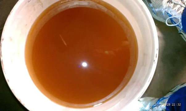

went for a ride today in my 87 4 runner and started missing on number 3 then I lost another cylinder and then I felt like I lost a third cylinder. I thought maybe the fuel injectors we're getting clogged again. got home and drained the tank and this is what I found!

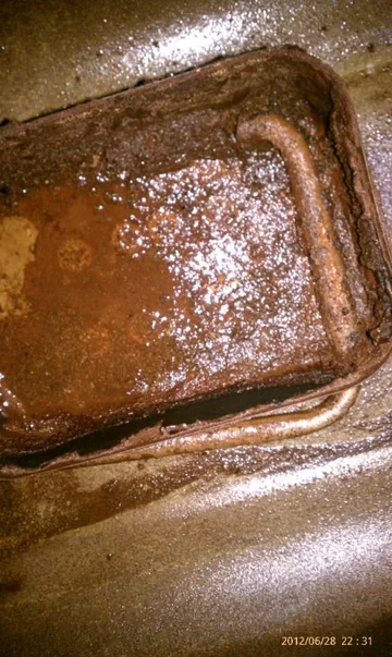

then I decided to go ahead and just drop the tank and then this is what I found inside the tank!
this truck has been sitting for about 6 years with the gas almost empty. so if you think you're gonna let a vehicle set for any amount of time go ahead and fill it up before you park it!

Great advice David and it applies to all your powered equipment such as lawn mowers, weedeaters, boats, etc. A full gas tank will have less condensation. Thanks for the pics! - Sorry about your problem though. Gonna replace the tank or try one of the liner systems out there?
We have used coatings in tractor tanks before and it worked great. I have some por15 tank sealed I'll give a try. Going to get after it with a wire brush and sand paper with HOT water and soap and see how clean I can get it first.

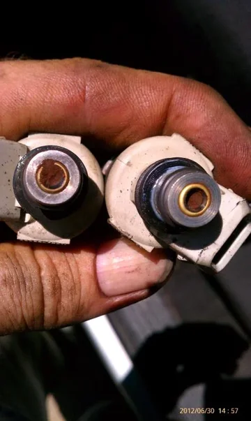

Stopped up a bit! B12 took care of it! Now to seal the tank and blow al the lineage out. New filter and put it all back together.
