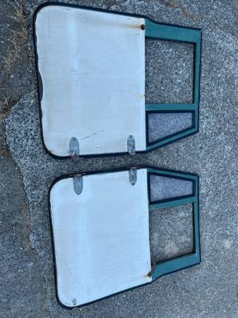

Marks doors are in much better condition then mine.
Pm your mobile number so I can send you pictures of the doors.
The doors that are with me are completely rusted at the bottom..
I sent you a message with my number. I do have a lower that I can use as long as the upper is in good shape.
