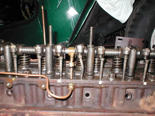

I did this for an entirely different reason, but the idea is the same at the head.
I drilled and tapped the head for 1/8" NPT, the fitting is 1/8" NPT x 1/8" compression that I thru drilled so that I could feed the tubing through it to the rocker assembly, the ferrule seals it. Beats the hell out of RTV.;)
pic
A pic is worth a thousand words--thanks cruisernerd!
