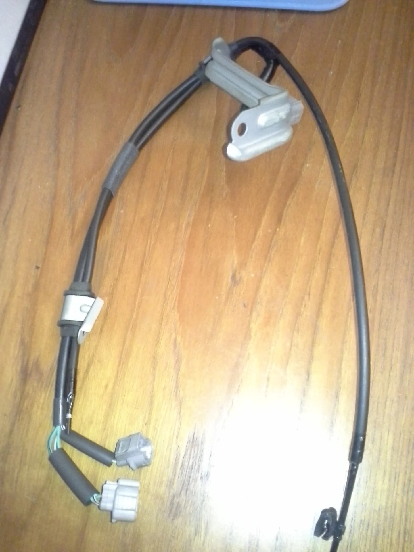

Worked a bit more on my E-locker install tonight while it is not raining. Wondering who has installed them in 1989-94 pickups and what routing works best for the wiring? I have a new harness for the 24" or so at the locker end. It has a pressed metal part that probably bolts nicely onto a '97 to '02 4 Runner, but I have no obvious spot under the pickup bed. Trying to avoid the exhaust and then enter the cab at the back of the driver's side. Not sure where I will run the breather hose either, but that is less crucial.
If you hadn’t seen the factory route in a 80, they pull the harness down to the axle housing from the DR corner & bring it forward & to the 3rd member.
The exhaust is all over on the PS for the later 1FZ’s /‘95-97
Maybe try sliding the small metal tab to bolt to the e-brake cable tab on the housing - that’s the 80 series method from recall.
Exhaust is on the driver's side. I am leaning towards attaching to an e-cable bracket and then up to the cross member, then along the frame rail. Just won't look too clean, and I'm pretty good at driving through brush, trees, snow, etc, which damages exposed cable and wire. I once tore a speedo cable right off in snow. I would like to not repeat that stunt with my new harness and actuator.
Imo its a bit of a trade off either way.
In the rear i chose up, away from the leaf. Its relatively well protected there via the diff, dl and tank.
Up front i was trying to use the path of least movement, while trying to negate potential damage.
Buy or build a motor guard.
Good point @gnob -since the back axle on a 80 is a 4-link / sheds sticks & roots better than leaf sprung setups.
