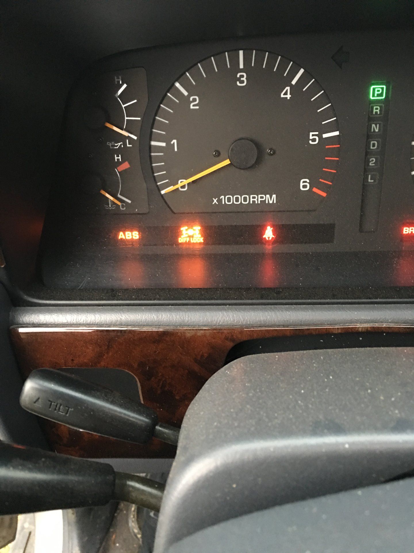

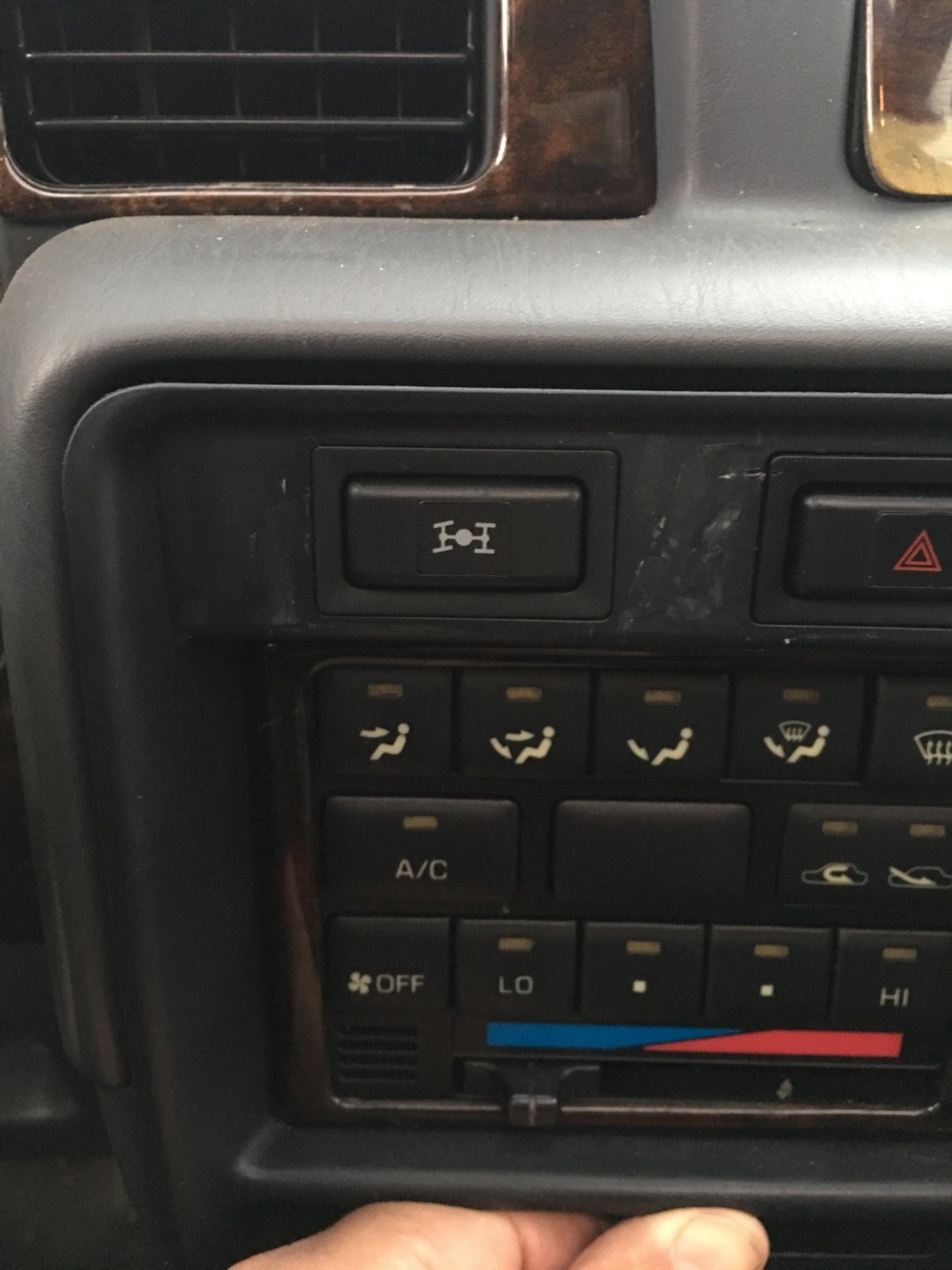

So I went out to the Duiser today and looked for the blank spot for the CDL switch. I don't see a spot for it.
I know that the Toyota security systems were installed by subcontractors at Port when the LC's came right off the boat from Japan. I yanked this system when I swapped out the 4.5L for the 5.9. So, I could put it there. I'll break into the dash and see what I find.
This is the only available plug that I can see. It has a jumper plugged into it. I'll now try and get an end view of the switch to see if they match.
If anyone thinks I'm going down the wrong path, please let me know! This appears pretty straight forward though.
pull the security and move it to left of wheel.....

CDL switch ordered! It's only a matter of time until I'm pulling Dyno results! I'll post'm up!

Got the switch installed! Works perfectly. Time to book the Dyno!! :D
