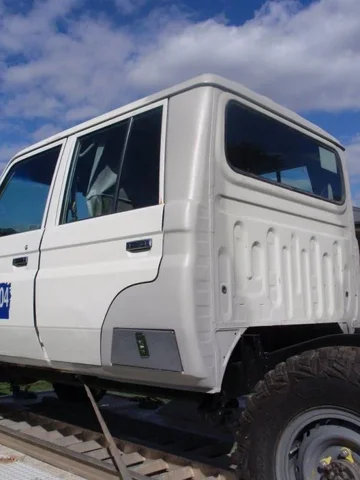

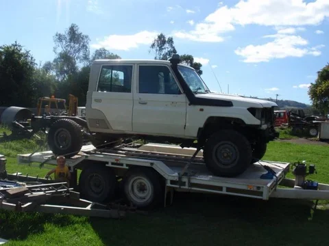

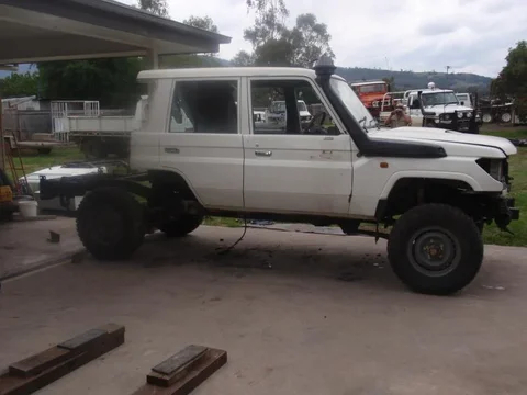

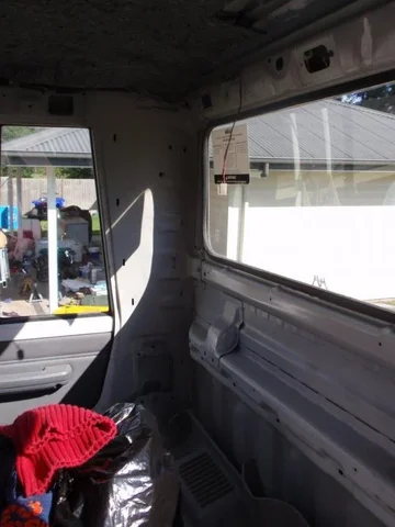

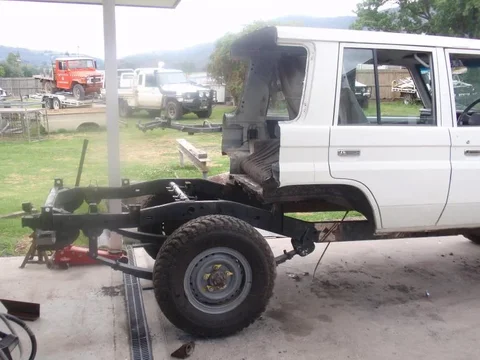

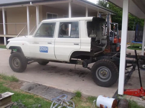

here is my current project

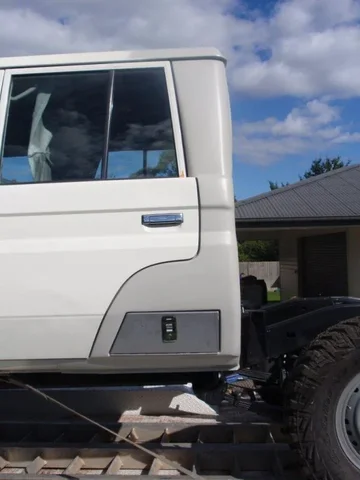

i have used a 2008 vdj76x wagon and grafted a standard 79x rear panel into the rear to keep it as factory looking as possible.
the chassis has been lengthen by 700mm, this shall give me a bit longer wheel base than a stock 79x ute.
the tray size shall be just under 7 foot long.
has v8 diesel, 5 speed h151, part time transfer.
will get ome suspension
arb bar work, full cab re spray and custom tray.
lastly a custom built long ranger fuel tank.
will be ready in a few months

the wheel base is not much longer than a standard 79x cab chassis, the 76x has a shorter chassis to begin with, so not real long.
as for 70x heaven sometimes i wonder, u get a collection then move them on and start again,
nearly at that stage now, time to move a few on and start again :)
yeah I reckon you're right....its probably only 350mm or so longer than a 79. I just stretched an 80 series 350mm to accommodate a 79 series cab and style side. 80 and 76 series are about the same

curious, what is the final purpose of the vehicle? i was thinking a bit longer wheel base yet with a 7' bed on the back.:hhmm:
hi wayne
final purpose of the vehicle is to have a landcruiser dual cab i can put staff in and use for work, and also have a weekend vehicle i can chuck the kids into with the bikes/dogs on the back and go away and still tow the camper trailer if need be.
waiting on some funds to complete. once i am back into it i shall keep pics up to date
