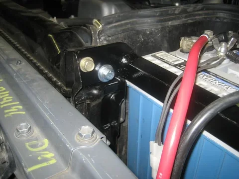

Group 31 homemade bracket

OK...Here is the bracket. I still have to tap the end that goes under the fender in the first pic. A small bolt should hold it in place. I also had to find bolts that were about 1/4" longer to hold the bracket into the radiator support.

I did forget to mention that I had to trim the radiator bracket slightly. You can see it in the last pic. I saw this as a small tradeoff to have the batter held down tightly. I was able to trim it with just a small cutting wheel on a dremmel tool, so it was really easy.
