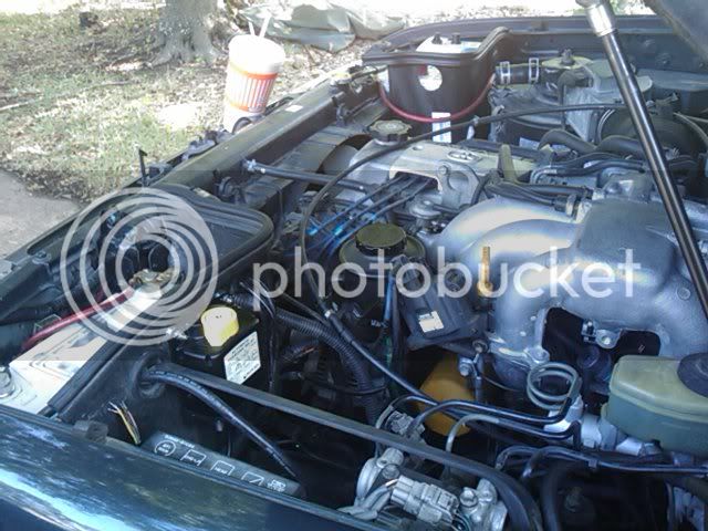

An update:
Sears Diehard Platinums, P2 and PM-1, Blue Sea 7622 ML ACR, Relocated Charcoal canister, relocated ignition coil, PAIR valve removed, temporary battery hold down. (I have not completed the wiring yet.) The Charcoal canister bracket is going to be chopped/welded to act as a platform for a BEP 720 MDVS on a '95 FJ80 which is also getting the dual battery treatment.
My Blue Sea system has worked flawlessly since I installed it. I'd check them out especially since their isolator was like $75 on flea-bay. It is an easy job and doesn't have any confusing wiring (important for electrical knuckleheads like me).
An update:
Where did you put the charcoal canister? :meh:
It is moved to the side of the power brake booster and sits between it and the fender well area... No brackets but it does fit pretty snug. (I am using the ponitiac charcoal canister which has a larger diameter than the OEM Toyota version.)
