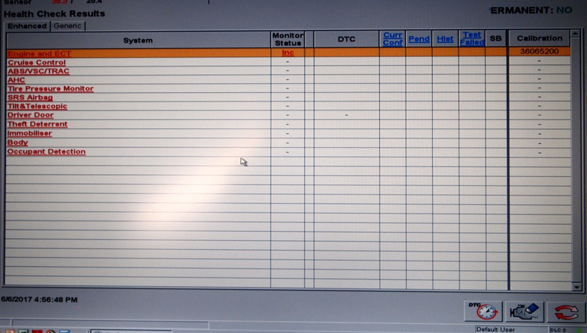

The only thing I'm still getting is a "Engine and ECT: Monitor Status; Inc, Calibration; 36065200" I'm new to using TechStream, so please excuse my ignorance, what is this?
I don't know what that is either. I have it also. I think it relates to the controller or the OBD2 port.
or session ID. IDK!!

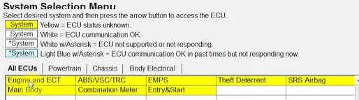

Inc = Incomplete? In the System Selection menu what color is the Engine & ECT box: Yellow- White-
see pic.
see pic.

I believe it was white on all Health checks, but not in my save. I'll make sure to note next hook up.
Thanks for the links, I'll read thought before next hook up.
