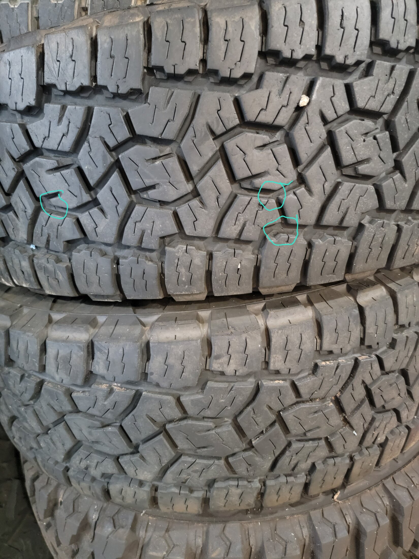

These were installed on my 2014 LX570 on May 22, 2020, at 64,000km. I'm currently at 126,000km, so that's just about exactly 62,000km, or 38,500 miles. Lots of gravel roads (frequently while towing) and lots of pavement towing, but otherwise normal, road-going use.

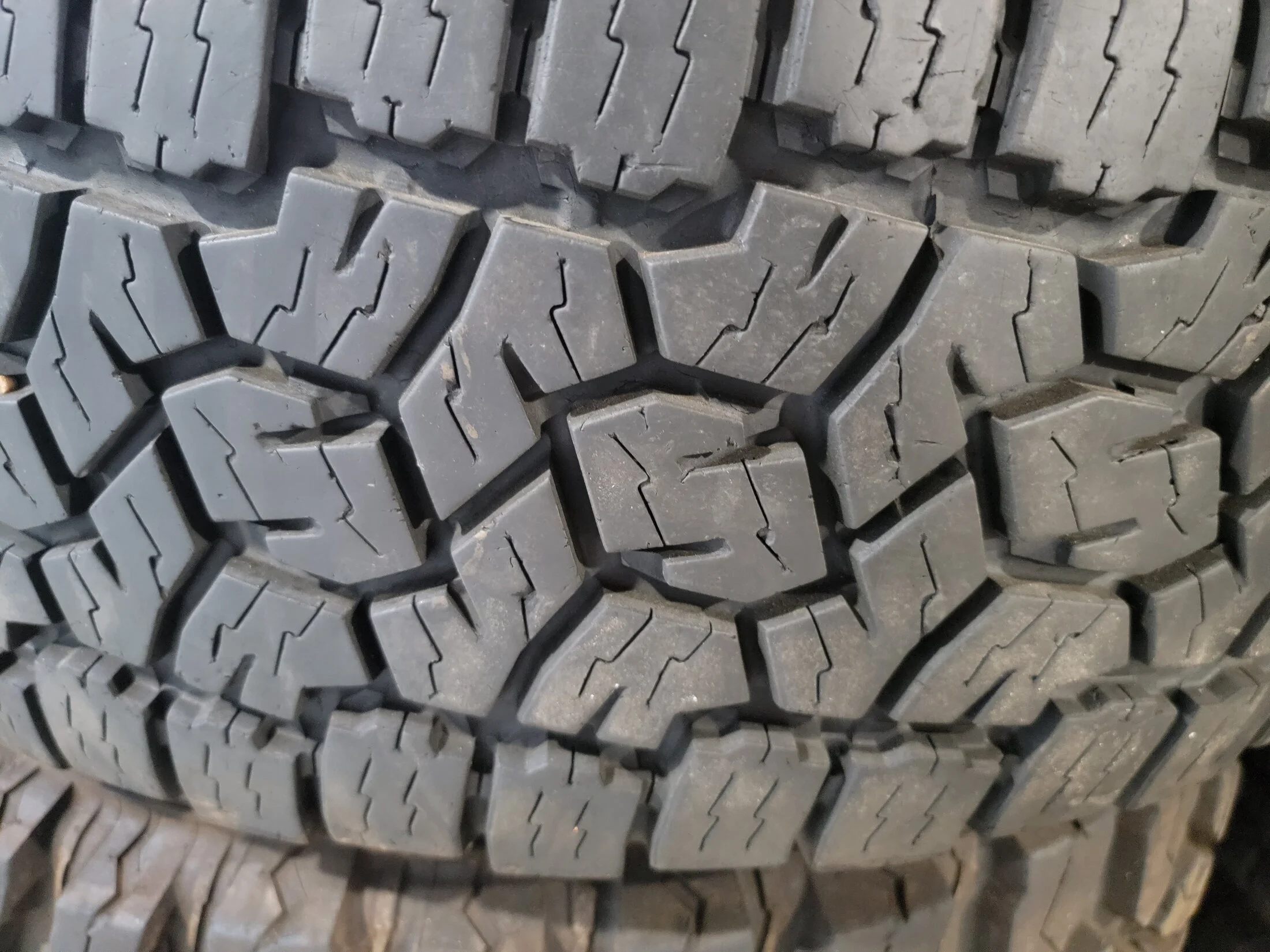

I've never seen such cracks on tires before, but all four of mine (haven't checked the spare) are covered in these. All cracks are located in between the protruding tread. The sidewalls seem to be fine.
I wiped down the tires a bit at the crack locations for photos, thus the colour difference there.
One of these tires started slowly leaking air the last few weeks, but others are holding fine. Am I correct in assuming these are no longer safe to drive on and I'll have to shell out for a new set next spring?'
It seems like dry rot, but given that the tires have only seen 4.5 years of use, and especially since they sat in my garage three of the four winters, that seems a bit quick for dry rot to kick in. Any thoughts?
Hmm you probably said it. Frequently towing. This together with gravel n stuff is just something that puts way more stress to your tire.
Not the first falken I’ve seen this on, though I haven’t owned any.
Interesting. To answer your question, it's probably advisable to move on to a new tire as these are compromised.
The why is probably more difficult. I'd imagine it could be a combination of heavy towing, cold weather, combined with potentially a manufacturing rubber formulation defect. I would look into warranty as IIRC, AT3Ws have a 55k warranty?
That said, I put my AT3Ws through hard use and heavy towing and never saw this over the 35k miles I ran them. Even sold them for $200 bucks after as they had plenty of tread and still looked great.
I've seen this in other brands as well but usually earlier in their lifecycle.
I have seen similar wear and "cuts" on E rated Toyo AT3s that saw moderate off road and rocky terrain. For me personally, after 38,000 miles of use and offroading I'd chalk it up to being par for the course. With that said, as @TeCKis300 mentioned, it's definitely worth attempting to warranty them out. Maybe get a pro-rated credit for another set of tires.

The tire might not be leaking air in the treads. If there's any corrosion on the wheels that can cause leaking along the bead. Also a bad valve stem. The tires are multiple layers of rubber vulcanized, so just because there are cracks in the top layer doesn't mean the rest of the tire isn't fine, and it's unlikely IMO to be leaking from them unless (a) you've had a nail which compromised all the layers and patched it, or (b) the tire is dry rotted on the inside and the only thing holding it together is the outer layer. B seems highly unlikely.
That’s not dry rot. That’s superficial surface cracking. Every KO2, Nokian, and Michelin that I have run in the last 10 years has similar surface appearance.
I've ran several sets of KO2s on my previous Tacoma, but have never seen these kinds of cracks. Had a few Nokian and Michelin tires on previous SUVs, too. 🤷‍♂️

Update:
The tire shop asked me to bring the tires in for them to have a look, take photos, etc.
They did not think these cracks are dry rot, but could not tell me exactly why this is happening. They did point out (correctly) that I have more inside-tire wear than outside (on 3 of the 5 tires), so I need to get an alignment done. They stipulated that the cracks may be due to the alignment issue, and that "the factory" (which makes the final call on warranty issues) is likely to reject the claim because of that. They couldn't explain the presence of the same cracks on two tires that do not have uneven wear, and also were convinced that the four-digit tire manufacture date is month/year (vs. it actually being week/year), so potentially questionable knowledge there.
In any case, I've got zero leverage in the situation, so will wait to hear back what the factory says.
I do need an alignment, though.

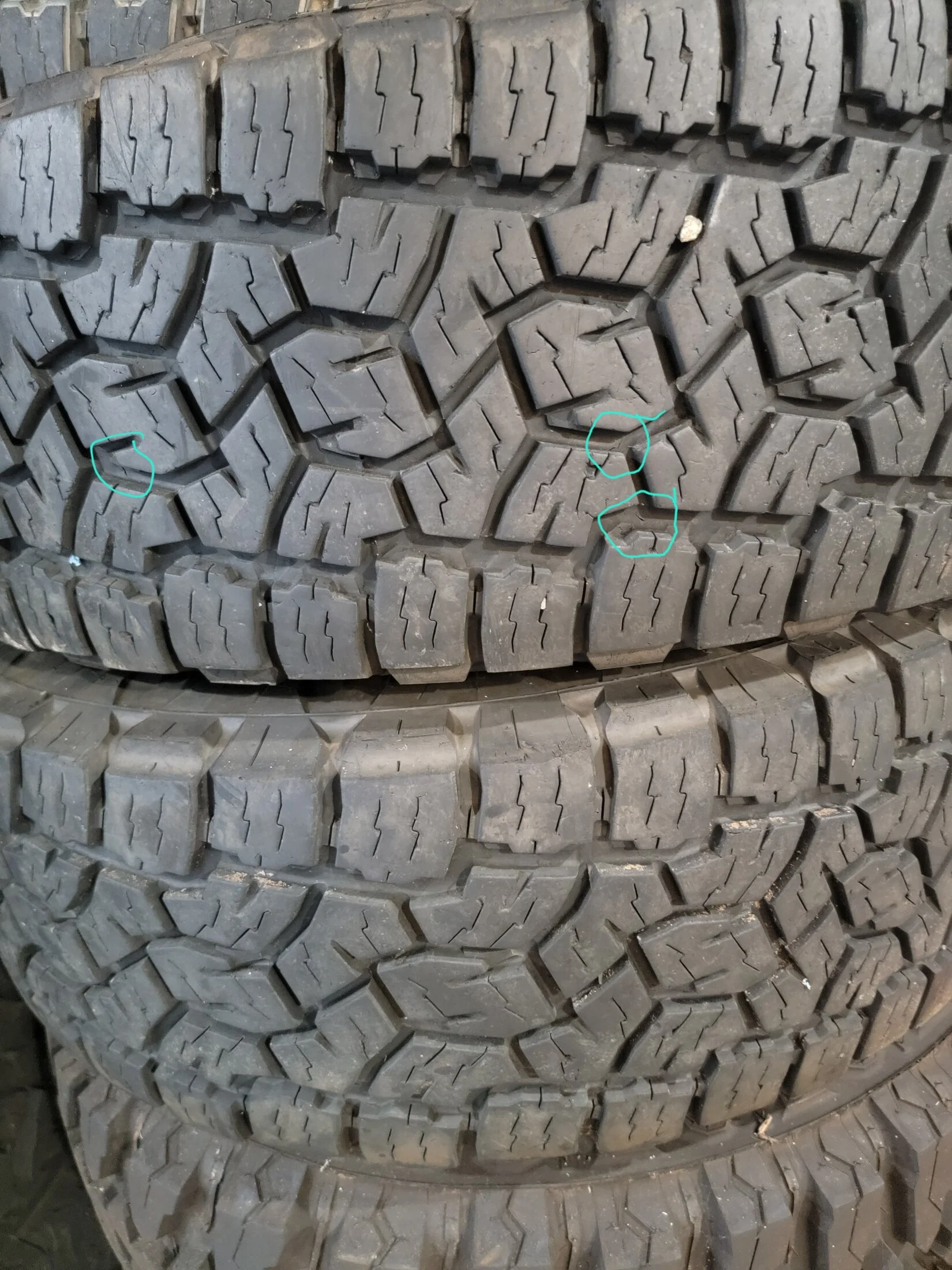

These are two of the three tires that show uneven wear:
