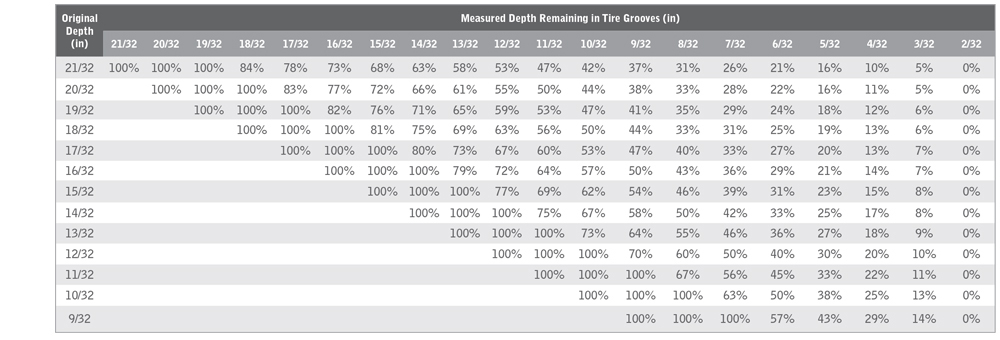

It's really hard to make a definitive case on those tires. To me they look like they've served you well under some challenging use and don't own you a dime. Those tires were probably 18/32 or 19/32 when new. At 6/32 you would only get 24-25% of value max anyway.

The LT-rated Falkens come with significantly more tread depth than my P-rated set did. According to Falken's website, my tires came with 13/32 from the factory.
Four of my tires are at 6/32nd, meaning just over 50% tread used. The fifth is at 9/32nd. Also keep in mind that I ran my winter tires during three of the four winters, meaning that my 38,000m mileage is actually quite a bit more than these Falkens have actually seen. I'd ballpark their real mileage as no more than 30,000m.

Tires should be replaced at 2/32. As such, there is only 11/32 of usable tread. Thus if your tires are at 6/32 then you have used 7/11 so more like 63%. At least that is my thinking and what is shown in the chart above.
