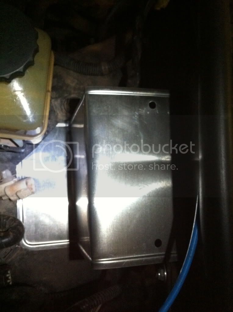

I used my old license plate to create the bracket :) Thanks AZ...
Mounted into the wheel well and on the bracket for the K&N.

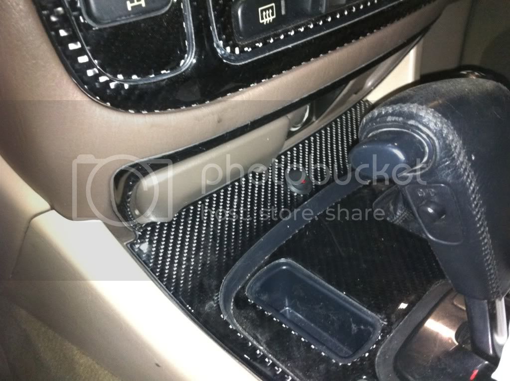

Switch is in front of the shifter where I'll have room to label and put the other 3.

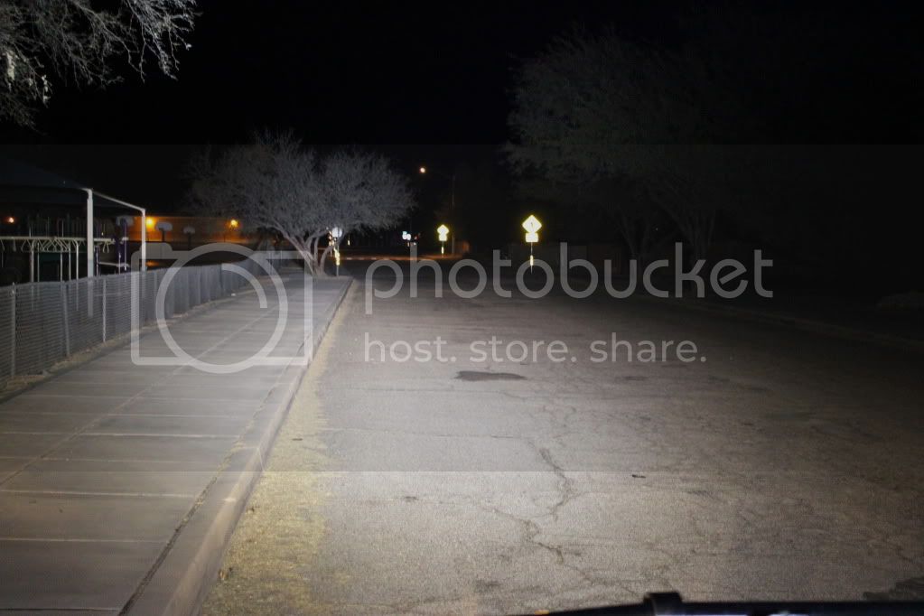

The lightbar does not throw nearly as far as my 8"HID's on the Tundra, but I'm also not planning on any 110 MPH runs down the roads in Mexico, Maybe 80 mph :) It puts out a great dispersal of bright light. The outer 8 LED's have flood reflectors and all the others are spots.
Here's some night pics:
Looking Mean!
Low Beam
High Beam

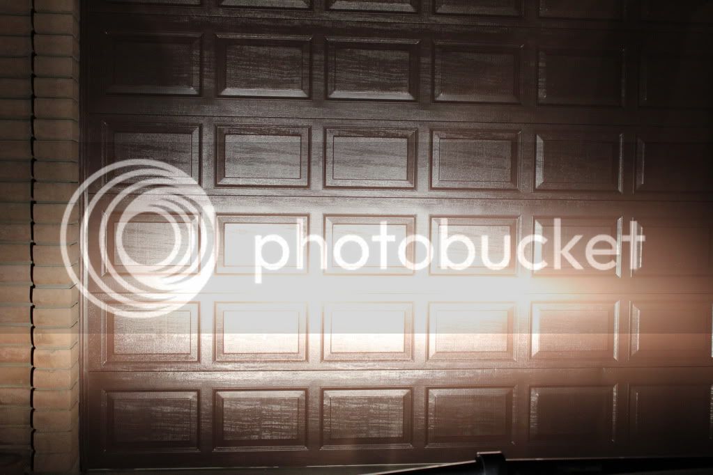

Rigid Lightbar
Low
High
Rigid Lightbar
A Little more exposure time
