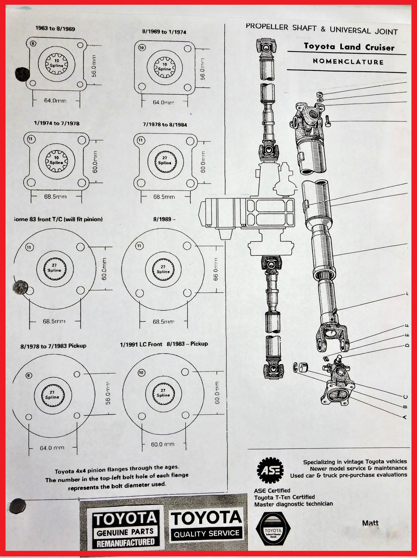

Hello Guys I have a 1975 SOA fj55 , I need a long spline front drive shaft (5inches is good )
I"m thinking a fj80 front DS ? But what are the bolt patterns ? Can i put my ujoint end on the Fj80 ? Are the ujoints the same size ? on most Landcruisers ? Thanks I did search ,
This thread and this pic should help you figure it out. Sorry too tired to go out and measure my 80. I will tell you that I have a 1st Gen Tacoma DC rear driveshaft on the front of my 80.
