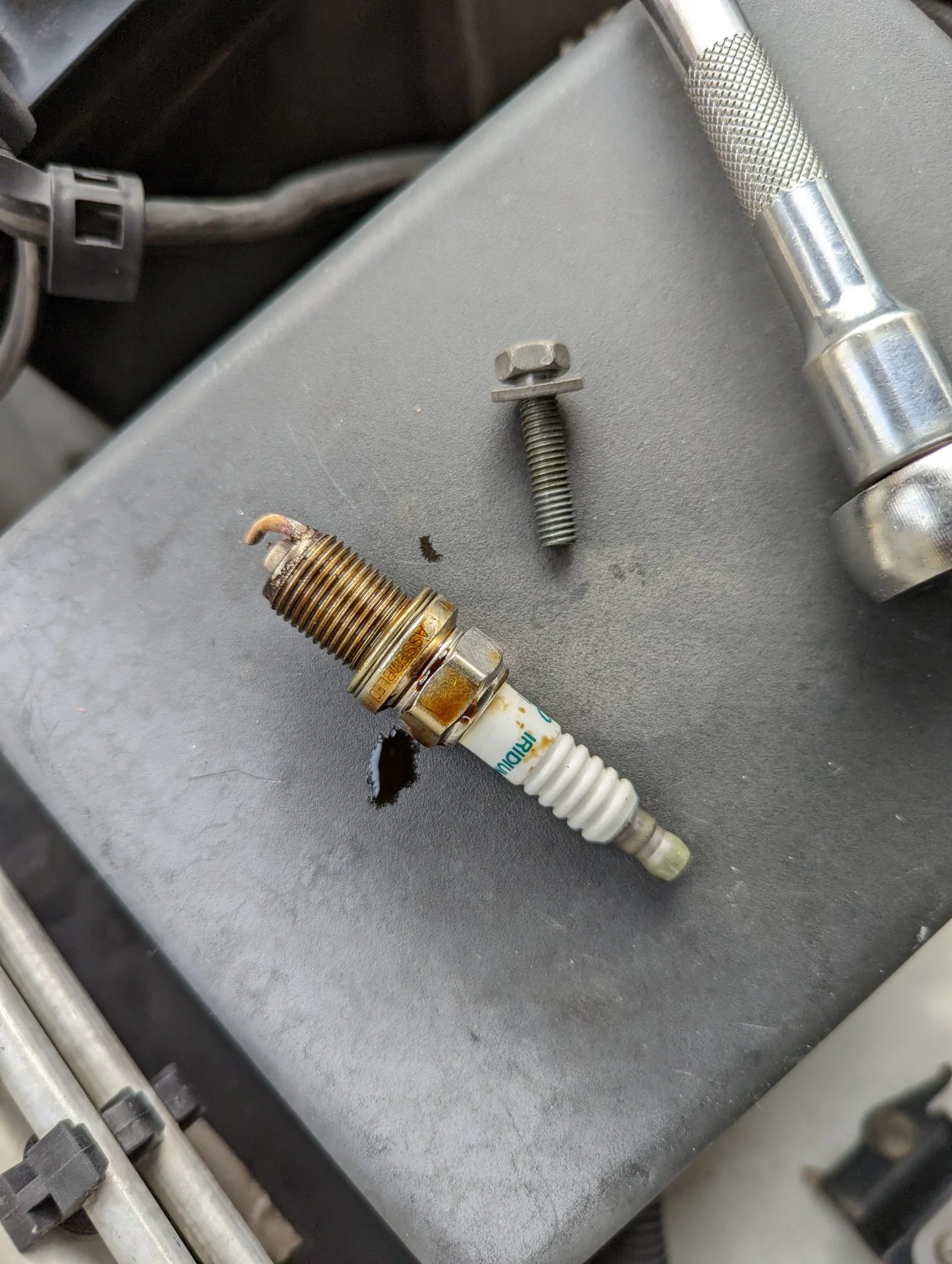

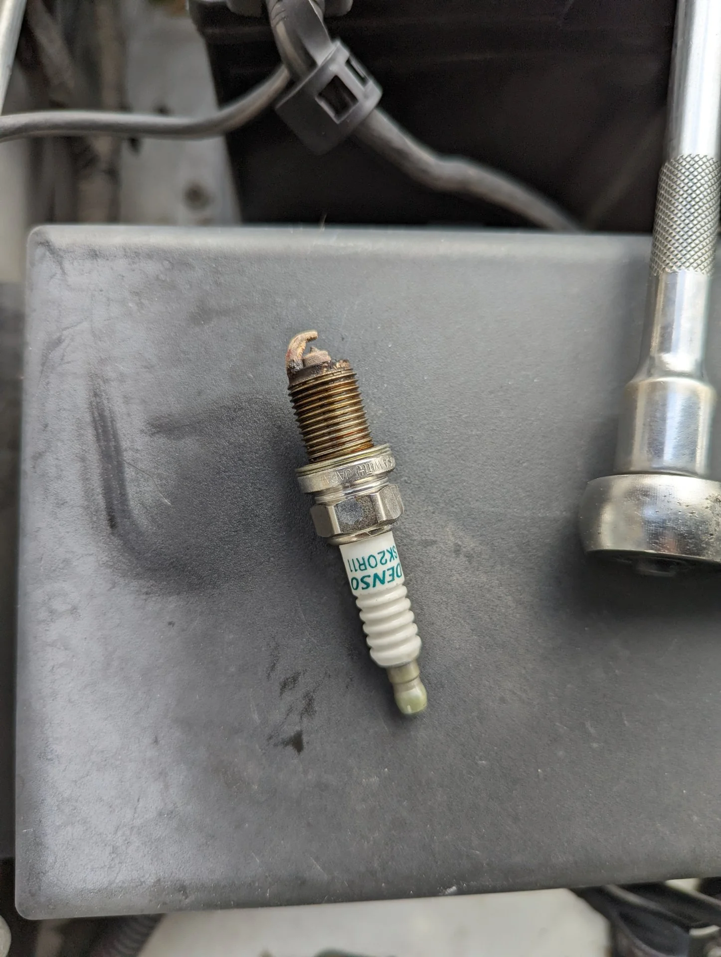

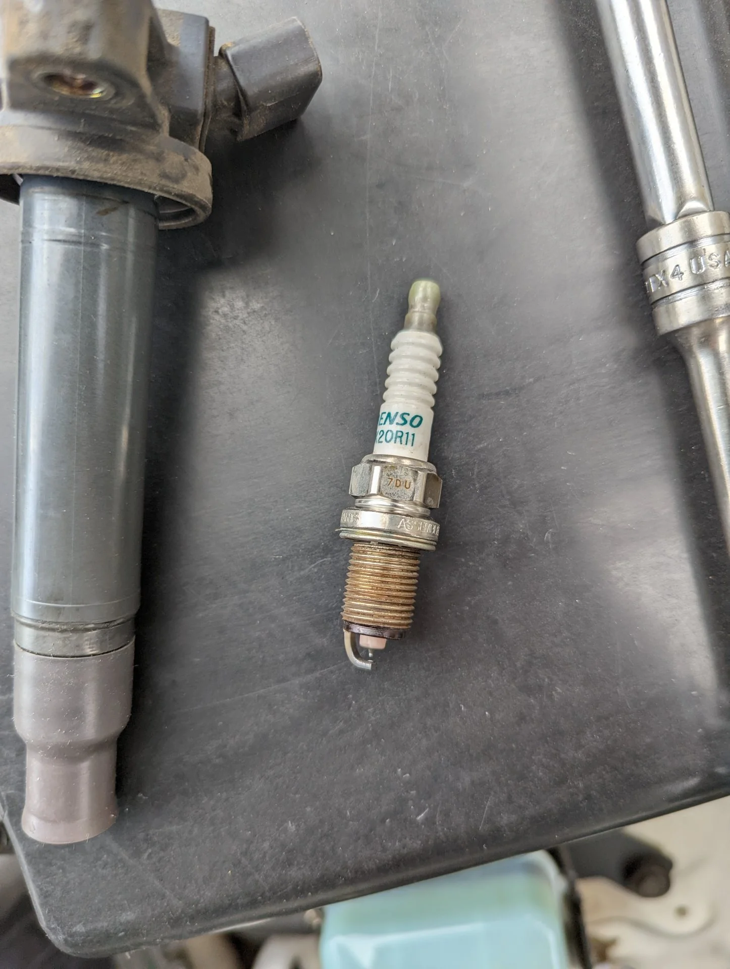

That being said, the noise/knock seems to be getting louder and is clearly coming from the drivers side only. I just pulled the four spark plugs from the drivers side and they were all pretty caked with corrosion/some kind of build-up. The threads are also coated with oil. The passengers side plugs were pretty clean. All coil packs looked excellent! I did replace all plugs to see if that would help. However, after letting it idle for about five minutes it didn't seem to change. I can report back after driving to/from work tomorrow.

Driver's side plugs:
Passenger's side plug:

The first plug you posted looks really coated with oil. Was there oil in the tube when you pulled that one? It is possible that could be the seals to the tubes. Do you have any oil wetness or stains on the engine block?

Replace spark plug tube seals. Those are leaking oil into the tubes. Use OEM seals. Also do the valve cover gaskets at the same time.

There were up to a few drops worth of oil in each spark plug tube on the drivers side. Thankfully not enough to fry any of the coil packs though! Passenger's side tubes were dry. Otherwise the engine is pretty clean, no wet spots anyway. Gonna start by replacing the spark plug tube gaskets and valve cover gaskets to hopefully fix the oil consumption/leak issue.
That's what I was thinking too. Thanks for confirming my suspicion. I will start with replacing the spark plug tube seals and valve cover gaskets and see what happens! I appreciate it!
