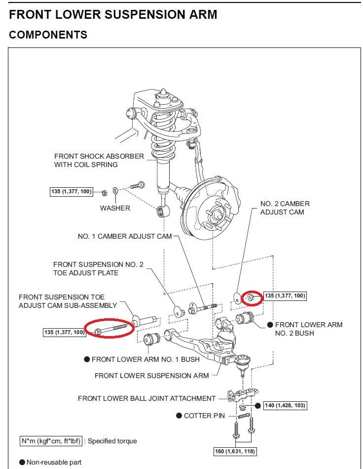

Mine (2009) does the exact same thing/sound while reversing and turning that your video shows. Anyone have a photo that identifies the lower control arm bolts that need to be tightened to 103 ft/lbs? I don't have the FSM. Thanks for any help.
Hi Jen, i believe the nut and bolt circled in red are the ones you want to check. I'm not sure of the torque specs - 100 vs 103 shouldn't make that much of a difference IMO. just don't let the ones labeled for cam/toe adjustment rotate so that you can keep your alignment.
bottom right is for the lower ball joint/steering knuckle correct? OP reports tightening the control arm got rid of the noise :meh:
Whichever they are, I will have them all tightened to those torque numbers. Thanks for the diagram, it will be helpful.
Wait....your cam bolts were loose?!?!
On mine, the nut circled in red on the RIGHT side of diagram above was not at 100 ft/lb. It was definitely not "loose", but it was clearly under 100 ft/lb, according to my torque wrench. The driver side needed more adjustment than the passenger side. Coincidentally, the clunk/pop was coming from the driver side before i adjusted the torque.
The bolt circled in red on the LEFT side of the diagram was almost at 100 ft/lb. Did not need much, if at all.
