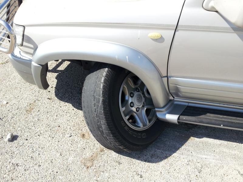

Not joking. If those bolts come loose, you tend to look like this (not mine, just illustrative). Imagine this at highway speed:
Yeah. That won't be pleasant.
Luckily, they were not that loose. Not even close to coming off or anything. Only 2 of the 4 bolts/nuts were just not tight at 100 ft/lbs torque.
