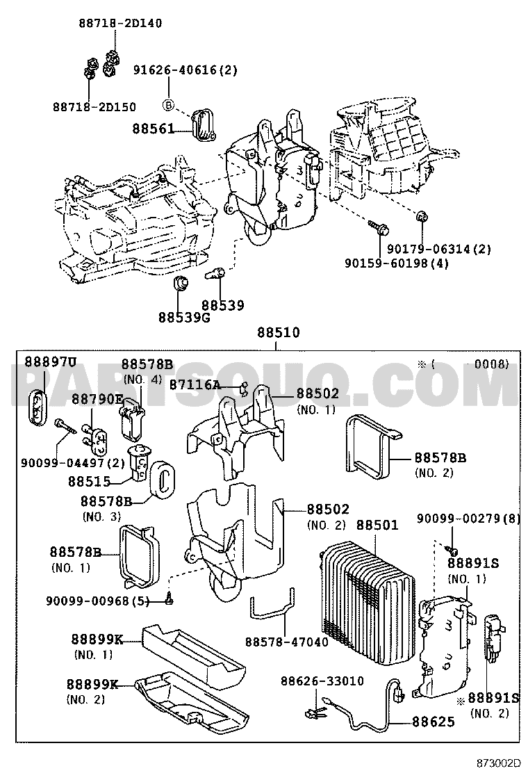

Toyota P/N 88578-47040. It was < $10 from the dealer.
No more drip!
I am having a hard time visualizing this. Where does the actual gasket go?
I had to go to an exploded view but now I understand what/where it is.

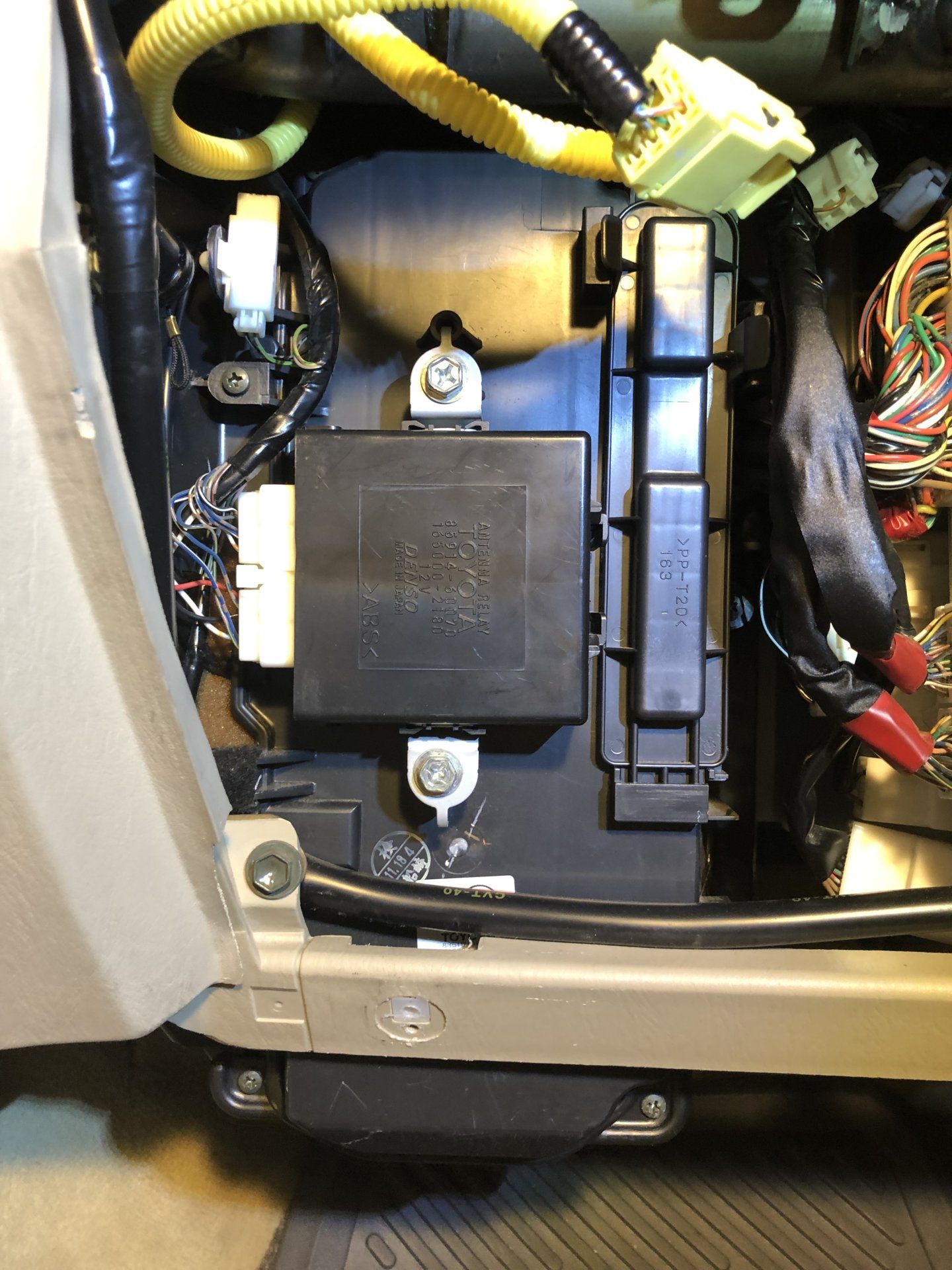

Just to make sure I have this right:
1.) I am disconnecting the antenna relay,yes?
2.) I am removing all 7, possibly 8, screws from that Whole panel, which includes the cabin filter access on the right?
3.) I am then attempting to fish that panel out ( I am assuming UPwards as 7/8’s of it is above the cross bar?)
Thanks all. My drain seems to be working fine so hoping it is just the gasket. Thanks for all these great tips.

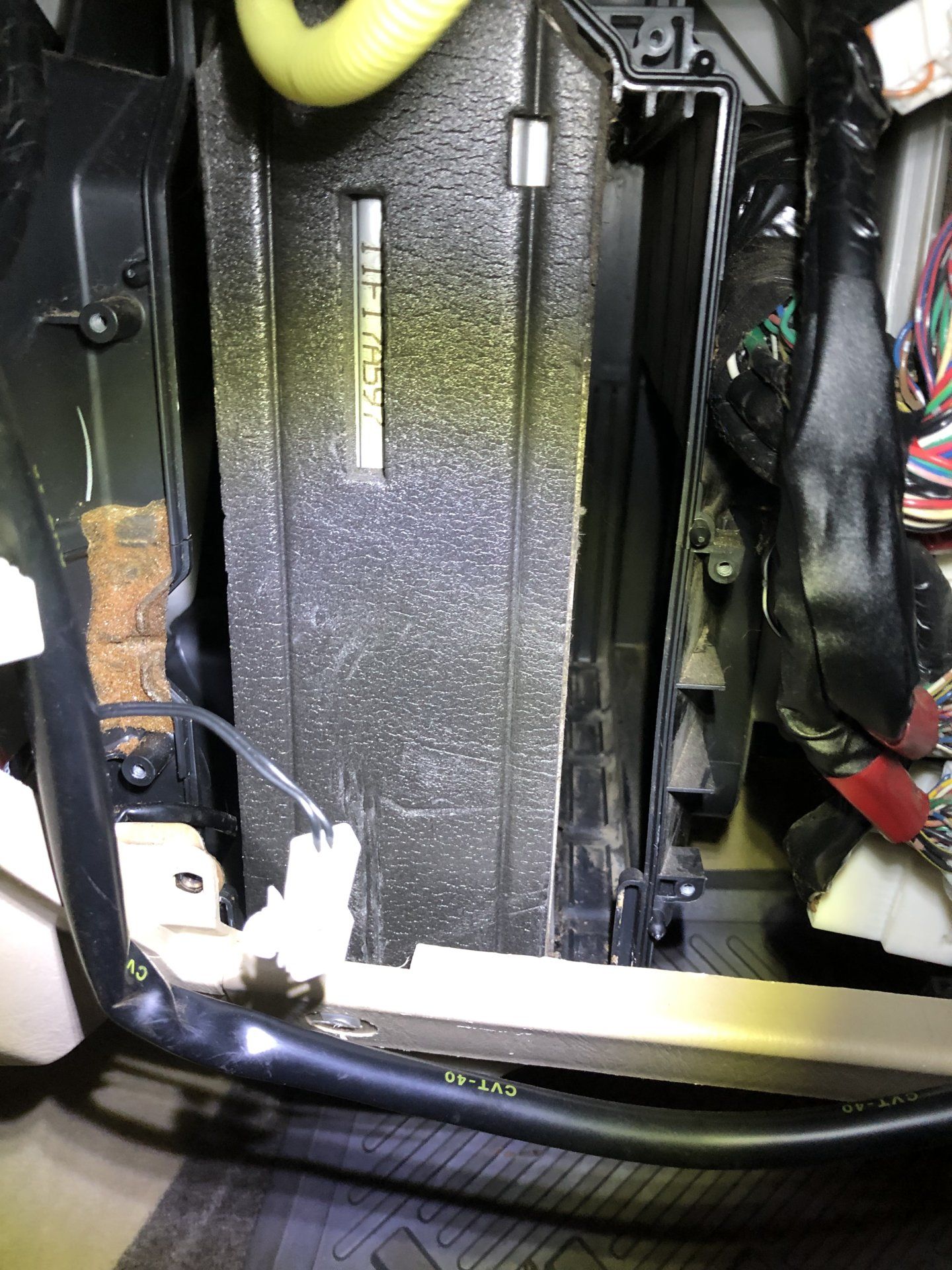

Yes, your steps are correct, in general. I think there are different approaches to #3. I actually removed my cover out the bottom, but to do so, I had to remove a screw for a brace (under the top edge of carpet on the transmission hump just to the left of your picture). I may have removed the screw at the top as well, but this allowed the whole dash areas to have enough flex to slide in the cover (still very tight). In my case, though, I was swapping the cover to add the filter access door. You do not necessarily have to completely remove the cover to access the gasket. If you could just slide the cover up a few inches, you may be able to access/replace the gasket without completely pulling the cover out from behind the crossbar. Keep in mind that this is only a suggestion as I have not done this, but it seems reasonable. If you look at the link in my previous post of this thread, you will see the pictures of the gasket.
Here are pictures of the screw for the bracket and me removing my old cover without the access panel.

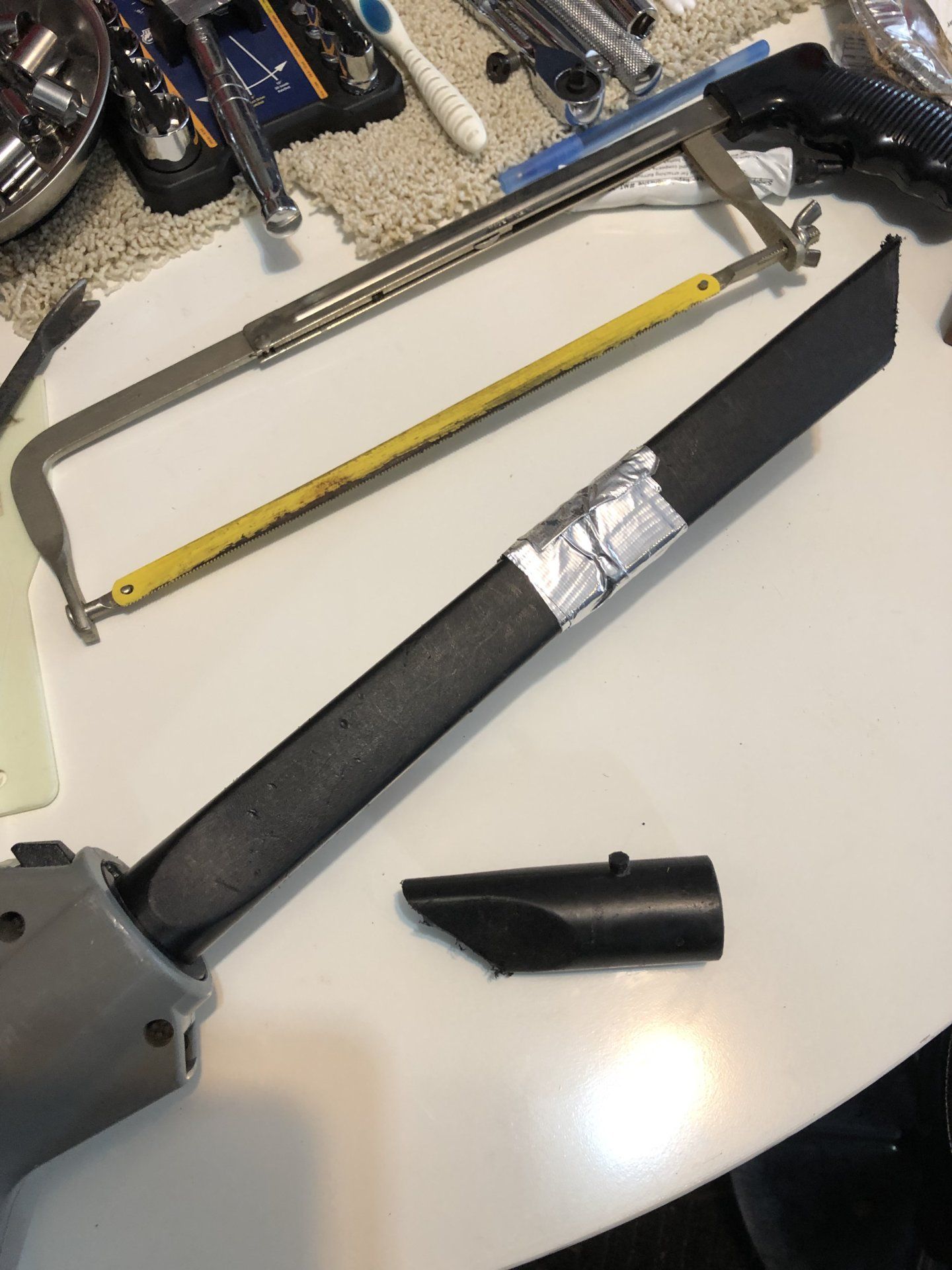

As suspected before, the gasket succumbed to old age and Alabama heat- not much of it left for pictures. Upside was that I crafted this nifty long crevice tool to get way back in the evaporator coil. I happened to have two of these from my Hoover vacuum and with the use of geometry, a hacksaw and some good duct tape, I now have a very clean coil cabin. The duct tape allows it to work on angles, too.
