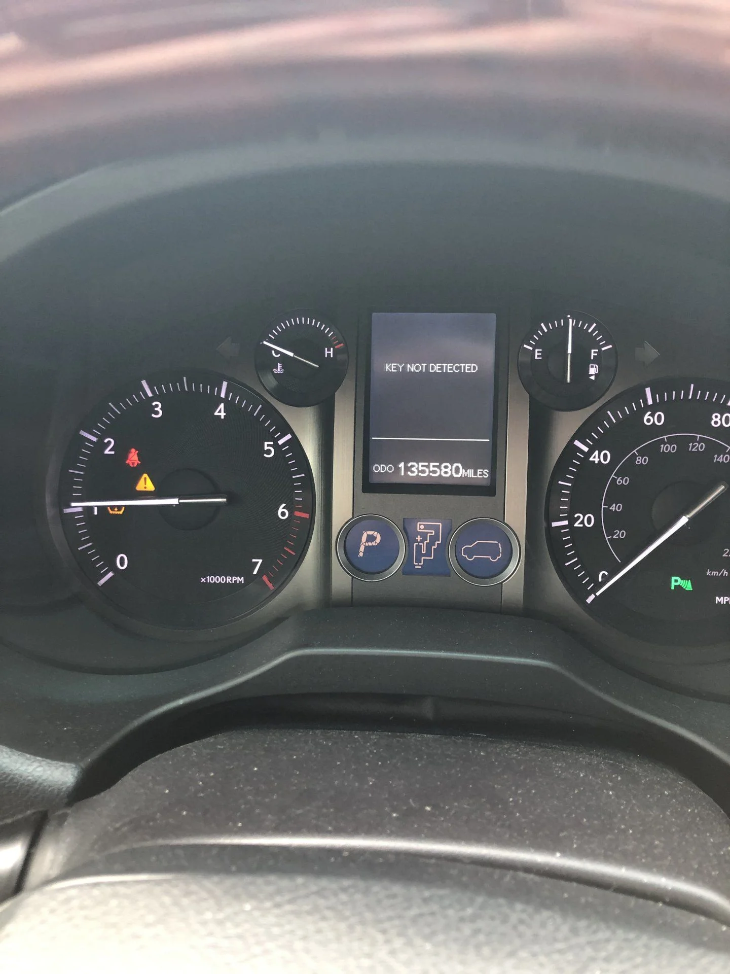

So my remote didn’t unlock the 460 today so I thought the remote battery was dead so I changed my remote battery and I still cannot unlock/lock the vehicle—well it worked once (lock) after I replaced the battery. I can still start it by putting the key on the start button.
Did the water fry the remote receiver? Or is it something else?

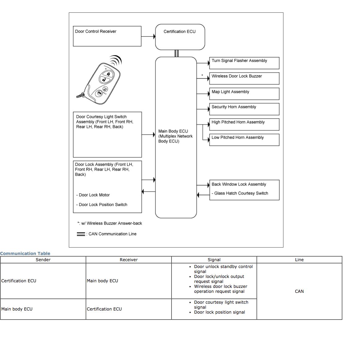

It could be the certification ECU or BCM but the latter would probably cause more things to not work. Do you have TS or OBD Fusion to pull codes?
Certification ECU is in nav area so probably not that one... Main Body Control ECU in is footwell area of front A Pillar

It starts up fine with only the TPMS light on and no apparent other issues as everything else seem to work. I do have an OBD II reader but not one of those you mention.

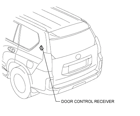

Interesting that the door control receiver is in the back so it is unlikely to of gotten wet. But it still might be bad as my range to lock/unlock has been diminishing the last couple months.

Edit, I really think the door control receiver is bad and is just a coincidence that it happened at the same time as the water intrusion from the sunroof.

You may want to go through the troubleshooting guide in FSM for this system:
WIRELESS DOOR LOCK CONTROL SYSTEM is located at this path:
/rm14k1e/repair2/html/frame_rm000000xx202px.html
If you haven't downloaded....install on a Mac/Win box. Navigation is via your web browser
