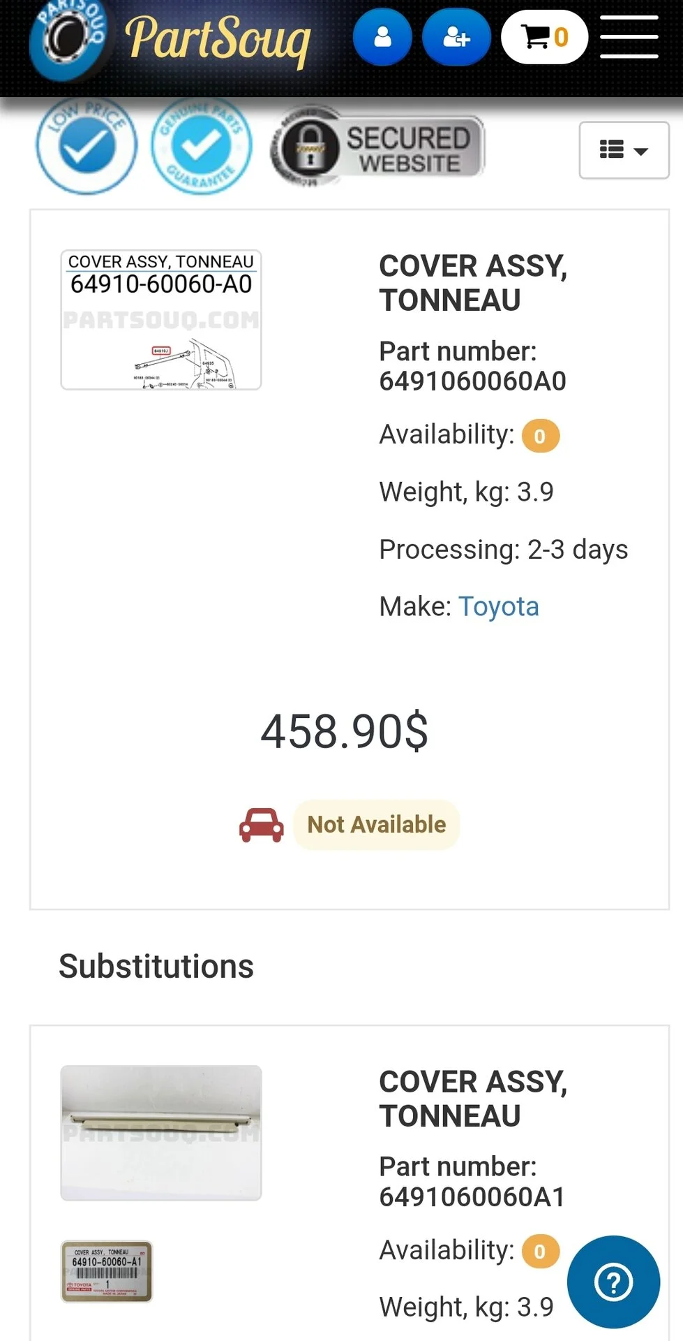

There's always the factory tonneau cover if you can find one:

For the tonneau you also need both inside quarter panel plastic trims - there are notches where the tonneau attaches that are not there on USA cruisers. The bulk will easily cost just as much in shipping.

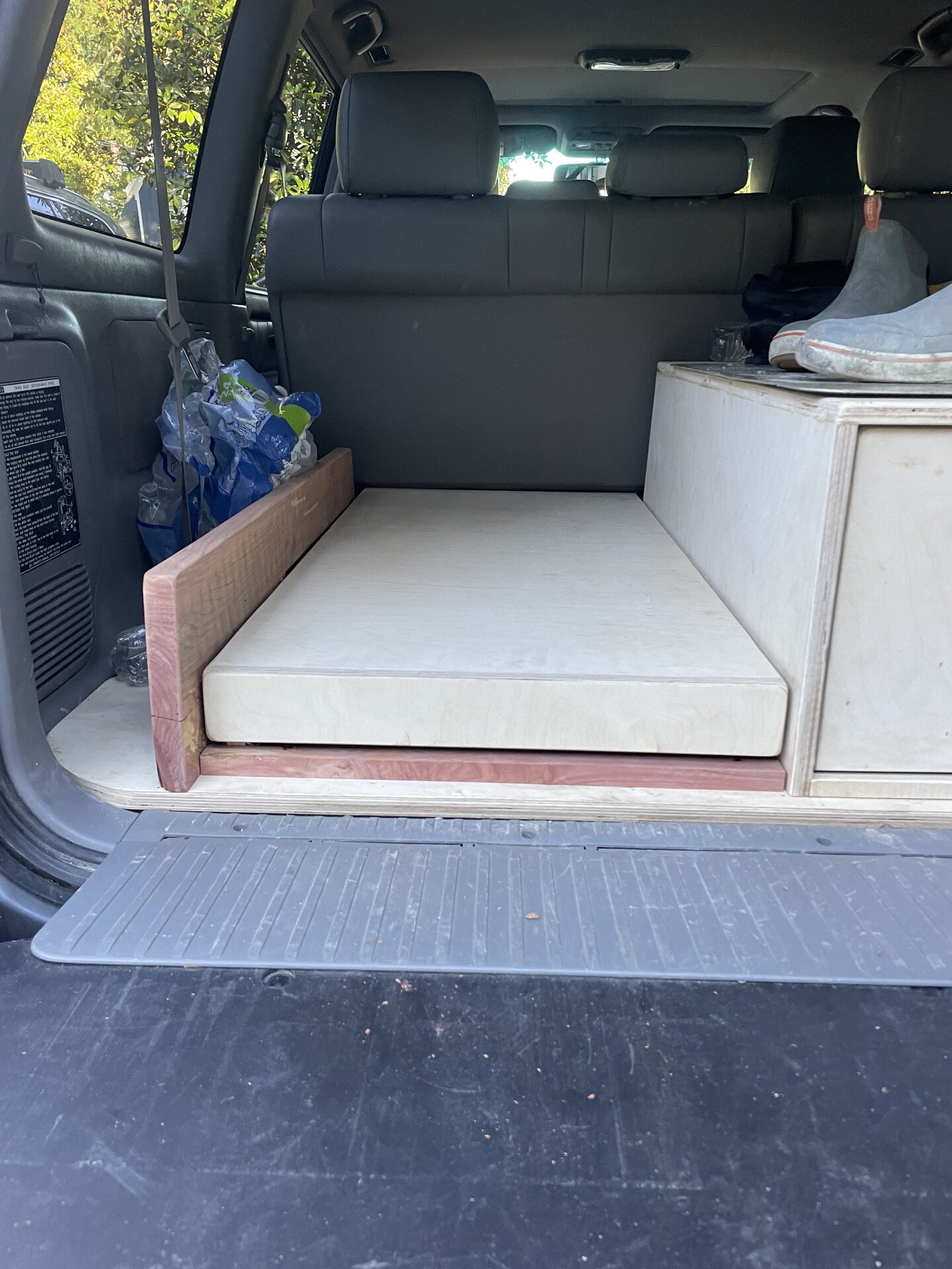

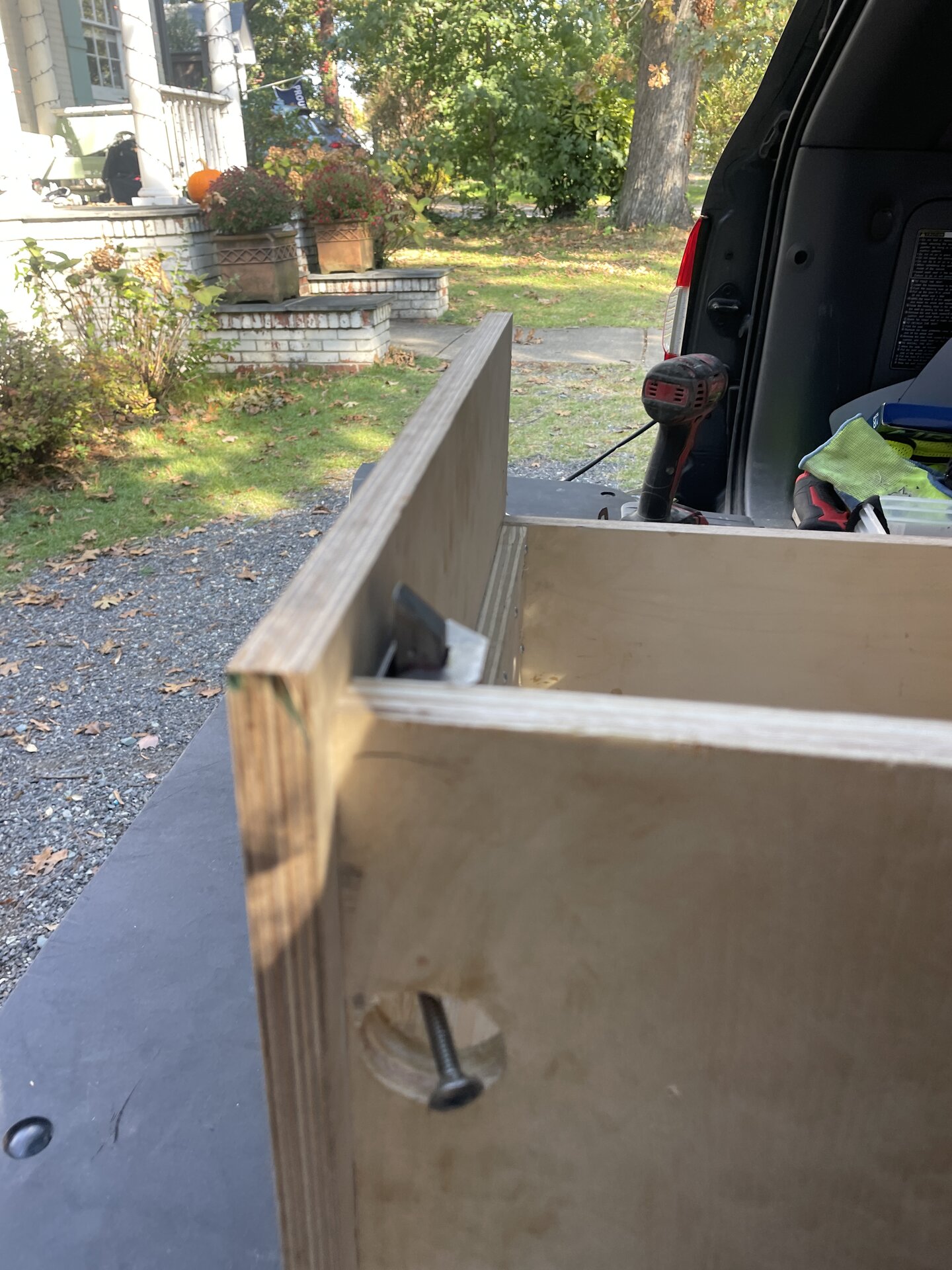

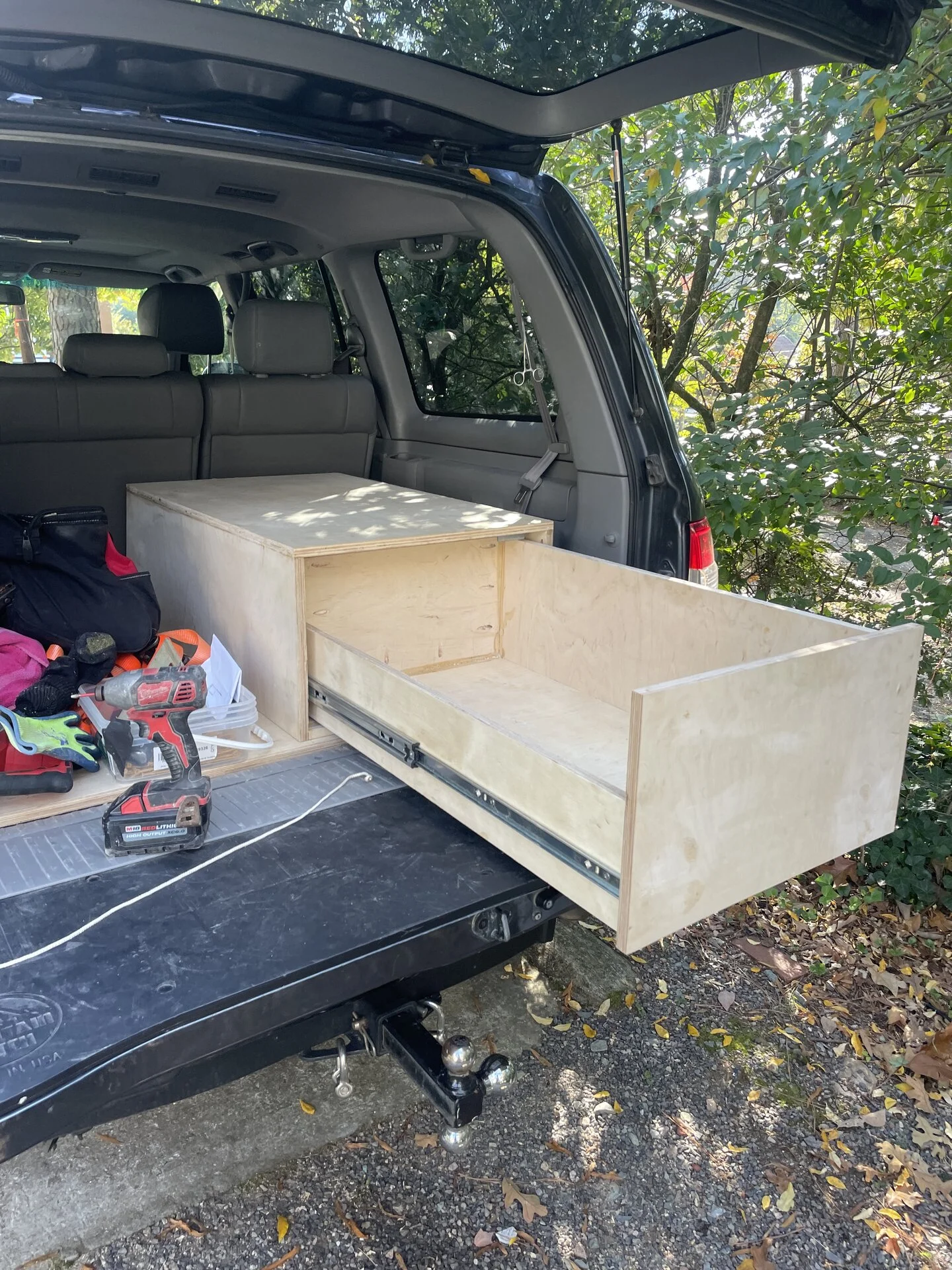

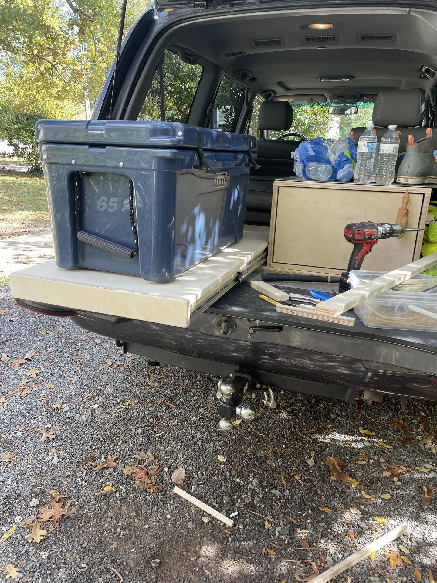

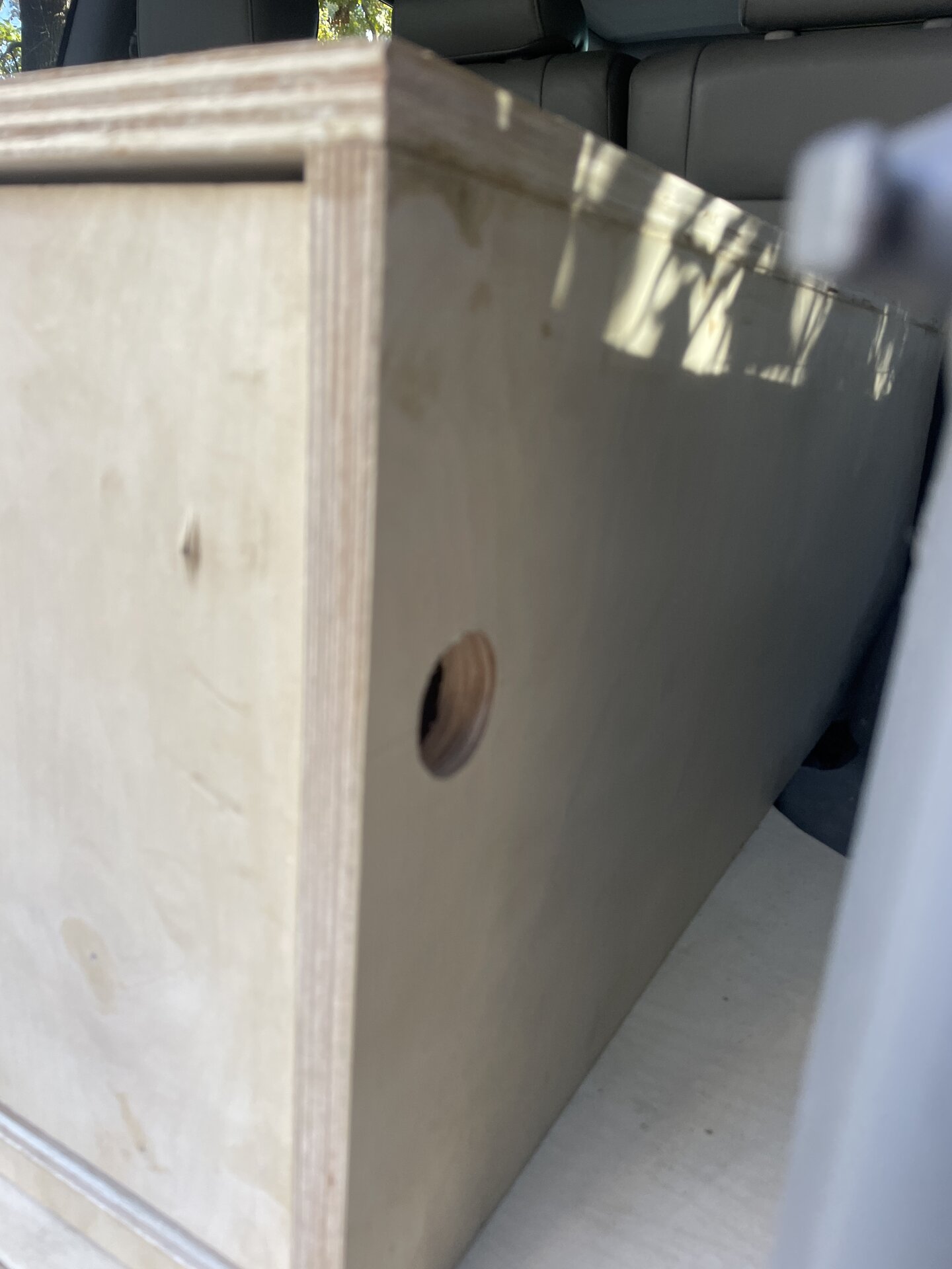

I made a custom sized cabinet that has a hidden locking mechanism on the side just for this purpose. Hides my tools, keeps them in one spot should I flip over and slides out so I can grab them. Enough to "keep the honest man out." The whole cabinet is screwed to a piece of 3/4 plywood that is bolted to the frame where the rear seats would be bolted. A rubber doormat from Lowes fits perfectly on top. I made a slide for my cooler beside it that can be used to carry other containers or boots etc.
Everyone wants to see it 😄😃

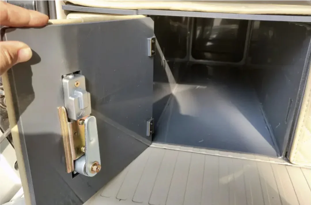

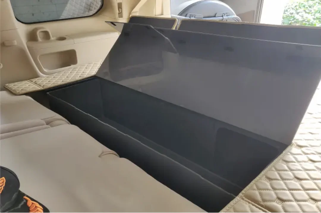

ok, wait, what's this. Cool. only 11 lbs. check it out. I think I can squeeze this behind my passenger seat. One of these in Matt black excites me more than a drawer system. light, portable, stores a ton of stuff, remove from vehicle when not in use. stackable, beautiful, and comes in 12 different sizes!
I made a custom sized cabinet that has a hidden locking mechanism on the side just for this purpose. Hides my tools, keeps them in one spot should I flip over and slides out so I can grab them. Enough to "keep the honest man out." The whole cabinet is screwed to a piece of 3/4 plywood that is bolted to the frame where the rear seats would be bolted. A rubber doormat from Lowes fits perfectly on top. I made a slide for my cooler beside it that can be used to carry other containers or boots etc.View attachment 3477908
wow you really went for it. lol, I have the same yeti (poor mans fridge).

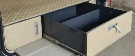

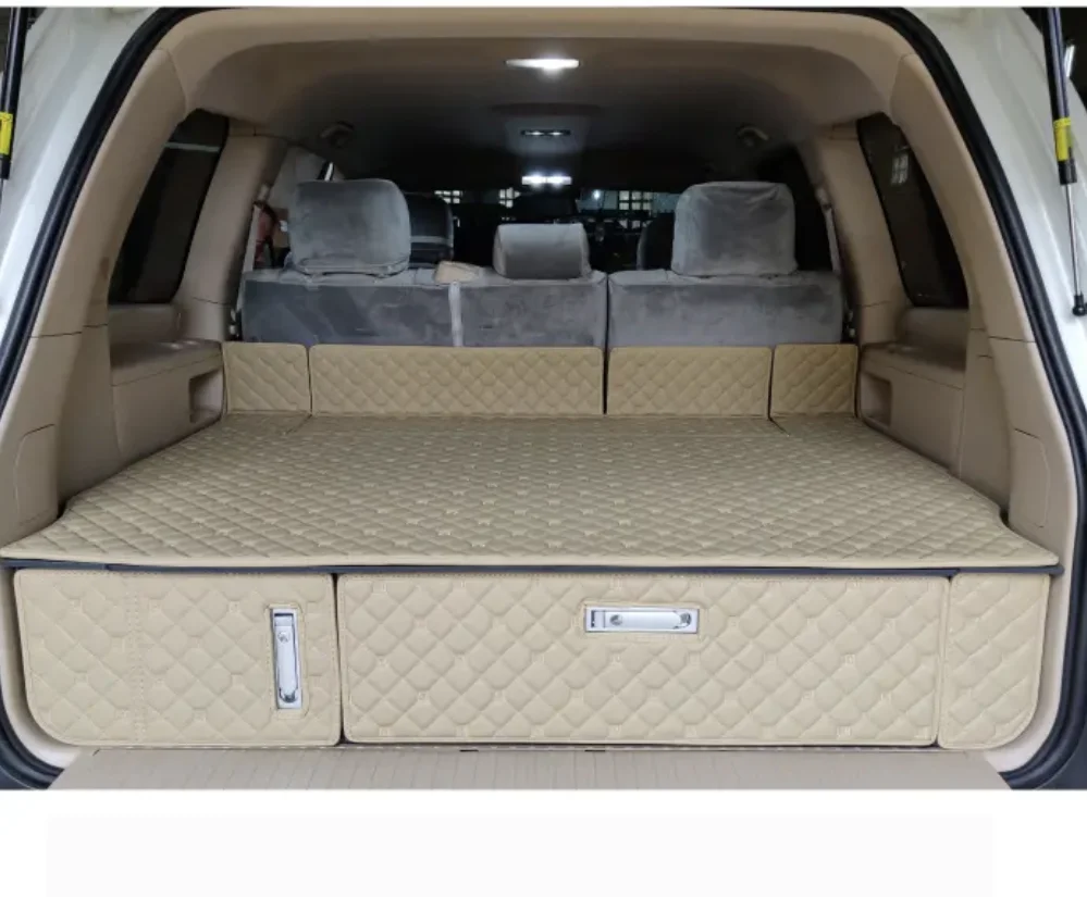

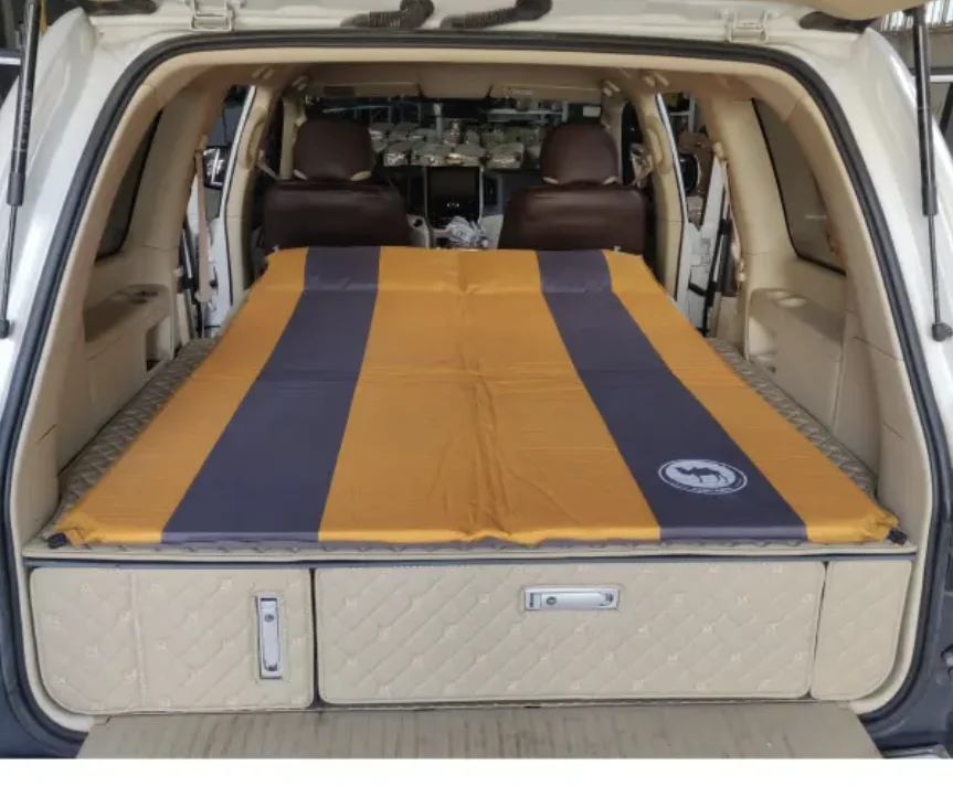

Here is a drawer system I am seriously looking at buying. It weighs approximately 75lbs and very affordable compared to every other option out there.
