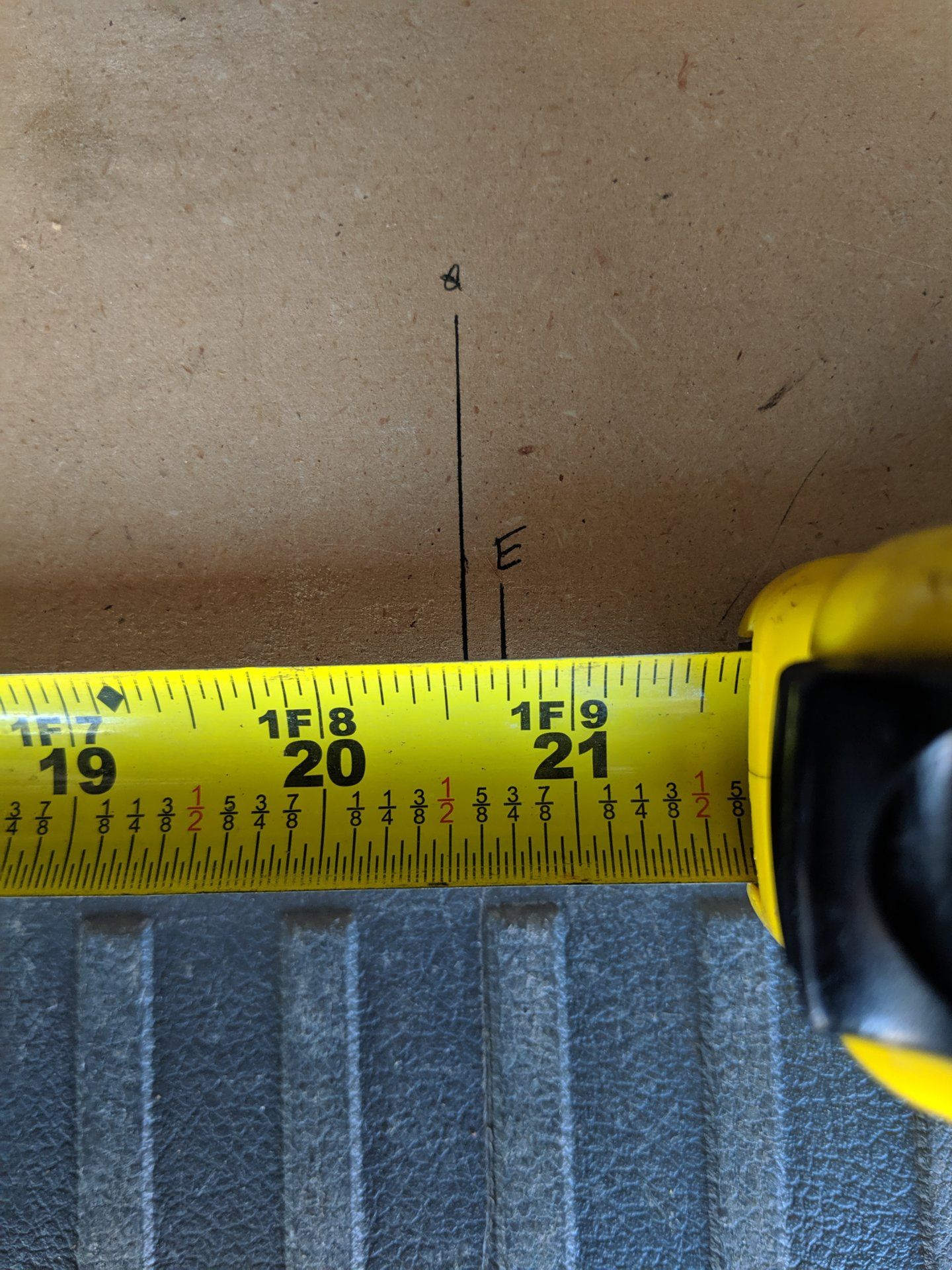

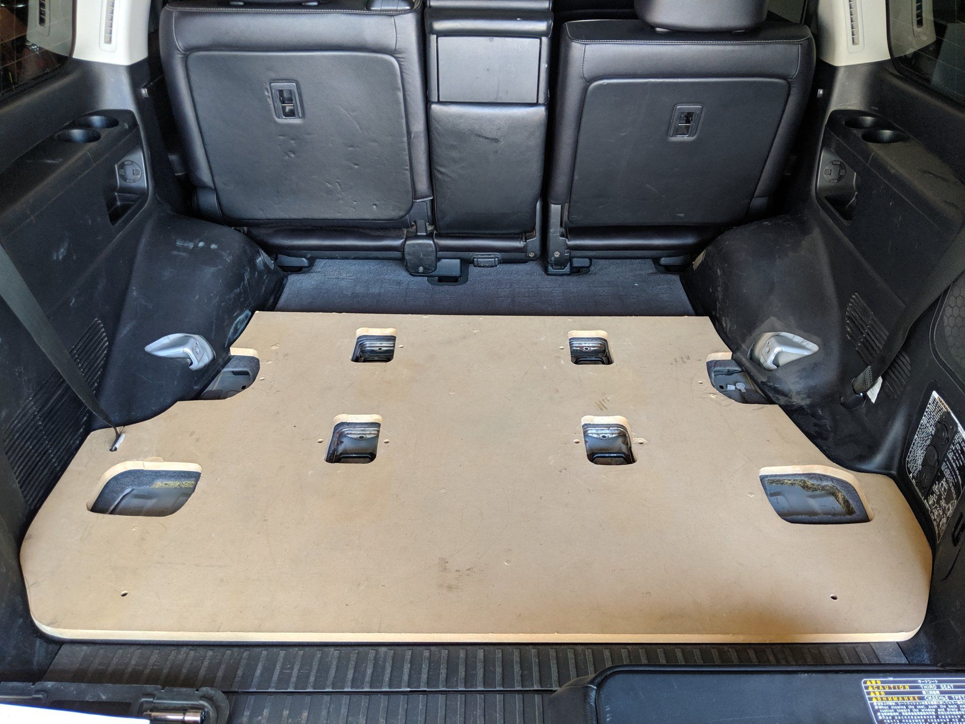

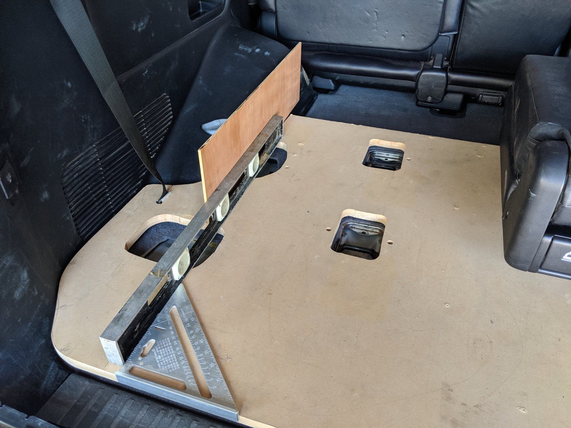

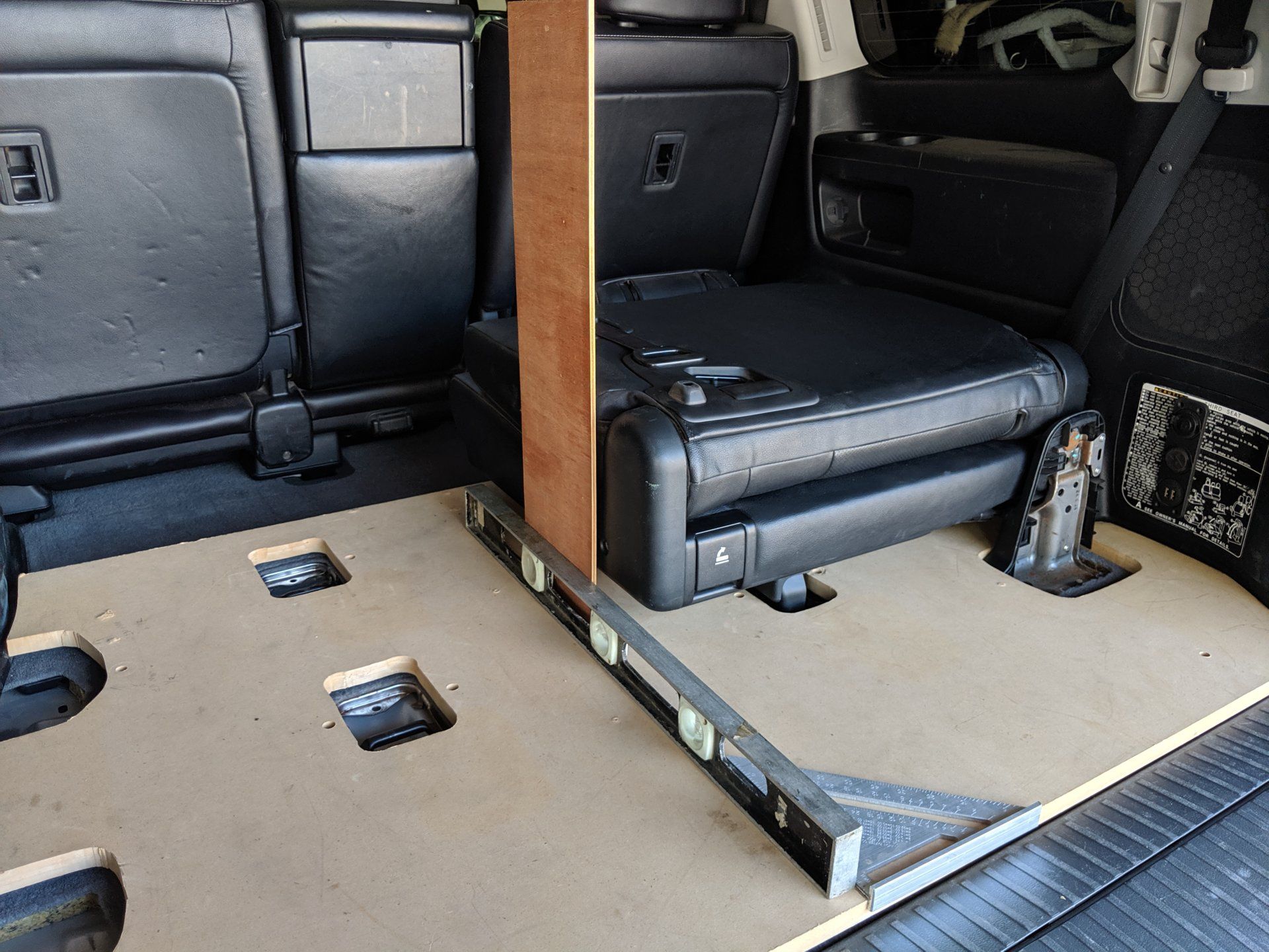

@linuxgod alright here's what I got for ya... the pics are really just so you can see what it looks like if you want to lay a base plate down, how I lined things up to measure, etc... I did not remove my carpet/padding though so the base plate would sit lower when I do, that would give you a bit more clearance behind the seat if you wanted to extend your drawer all the way back to the seat. Seat was pushed all the way back (ie max room for passenger) and reclined a couple clicks to comfortable position.
The plate is cut to match up w/ the drop on the floor which makes it 33 5/8" deep. The drawer can be max 20.75" wide. If you add a divider you may need to take into account the thickness of divider material depending how you mount it. Now if you built the drawer to hang over were the floor drops to where it is basically touching the 2nd row seats you can use the following lengths:
If drawers are 15" high, max length 37 5/8"
If 12" high, max length 38 5/8"
and if 10" you can go to 40 1/8"
Not sure if this matters to you or not, but I asked @Markuson if he could sit up if he sleeps on his ARBs, said he cannot. This is important to me because if I can't sit up even at 11" high, I guess going a few inches higher won't matter since I won't be able to sit up anyway. I slept on some totes that were 13" high with a 3.5" pad and it was fine sleeping.
FWIW the ARB drawer dimensions are 945mm long x 505mm wide x280mm high. Note the width is just UNDER 20" wide.

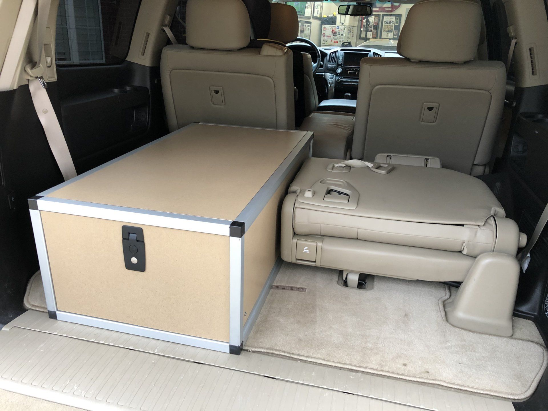

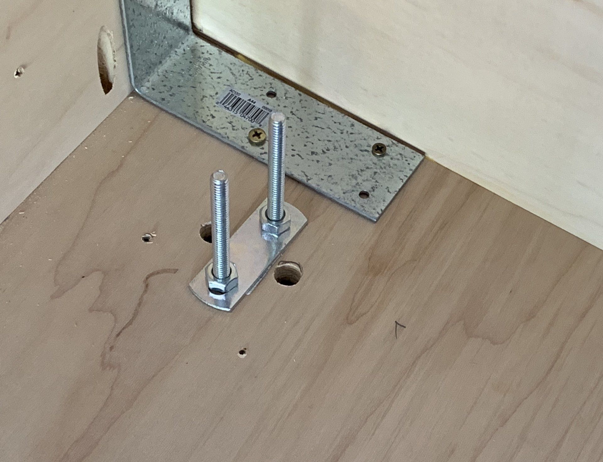

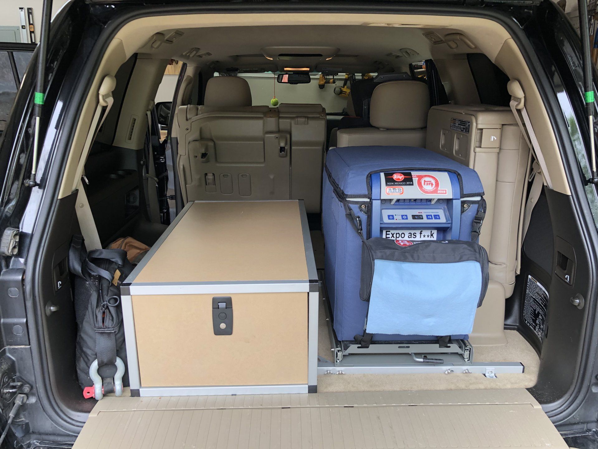

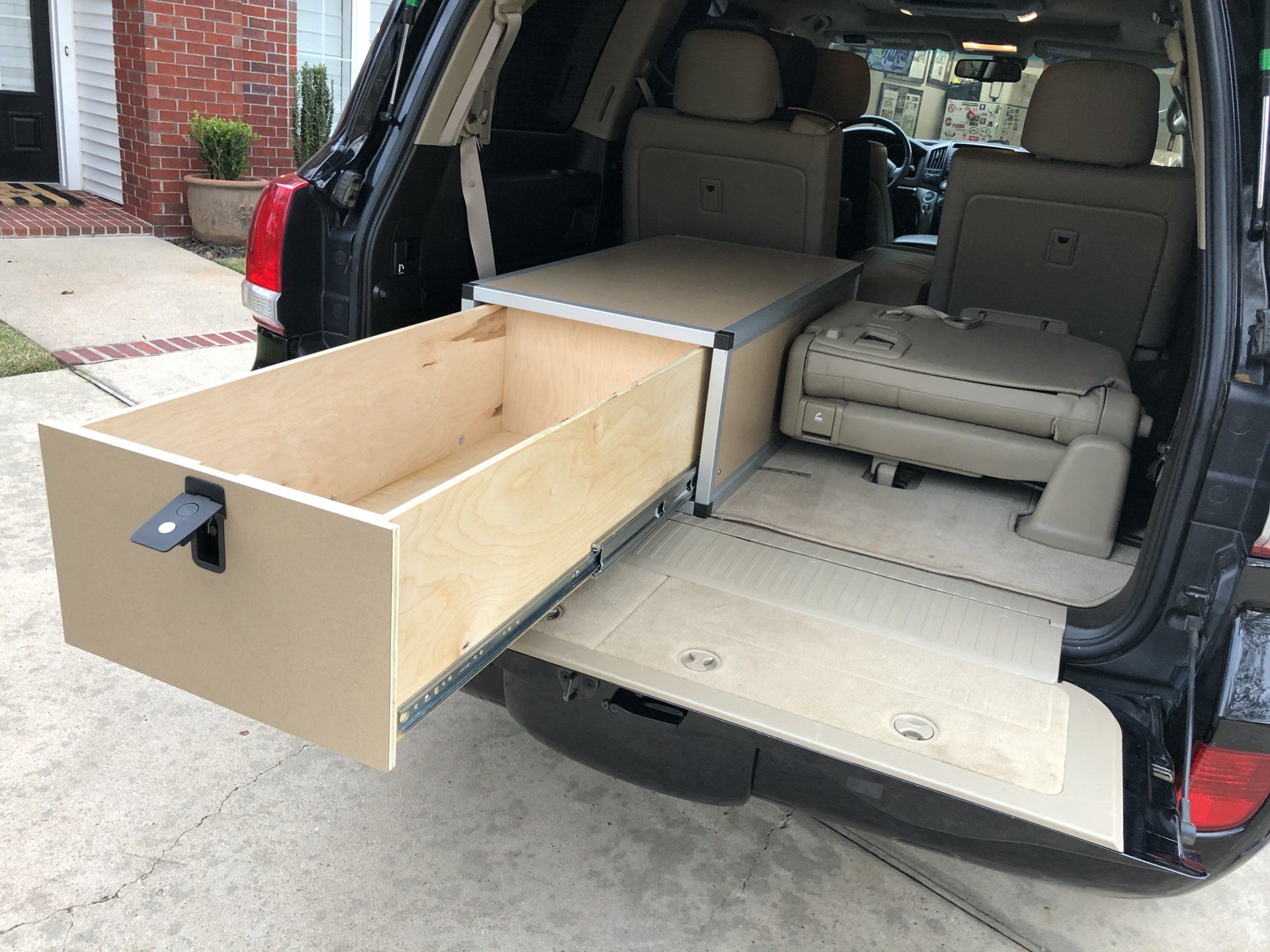

FWIW here’s my ‘half’ setup that i can run with one of the third row seats in place. Fridge slide section drops in without tools. 3 wingnuts and a j-bolt secure it to the drawer and floor. Love the volume of the drawer and the simplicity of the whole setup.

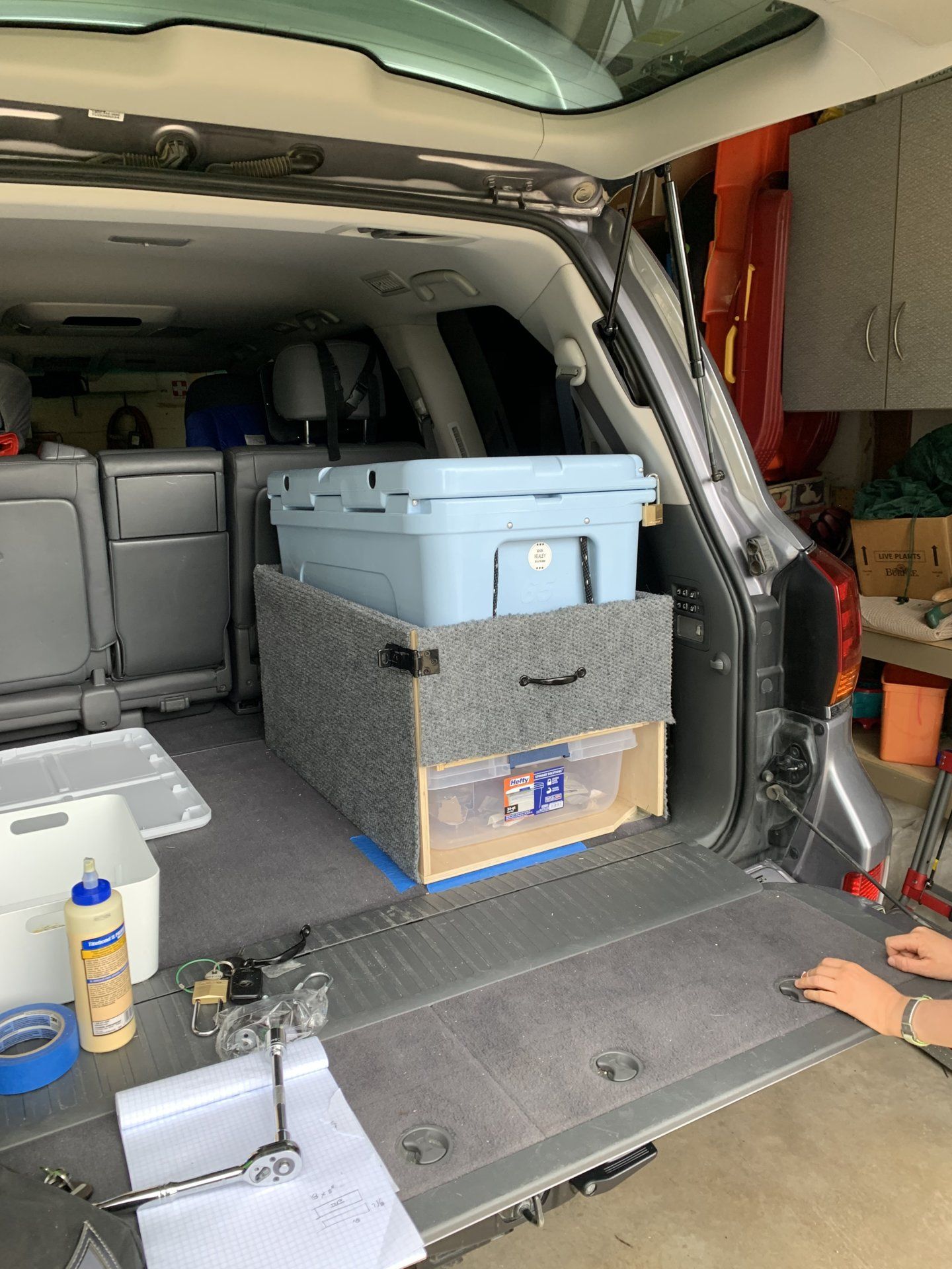

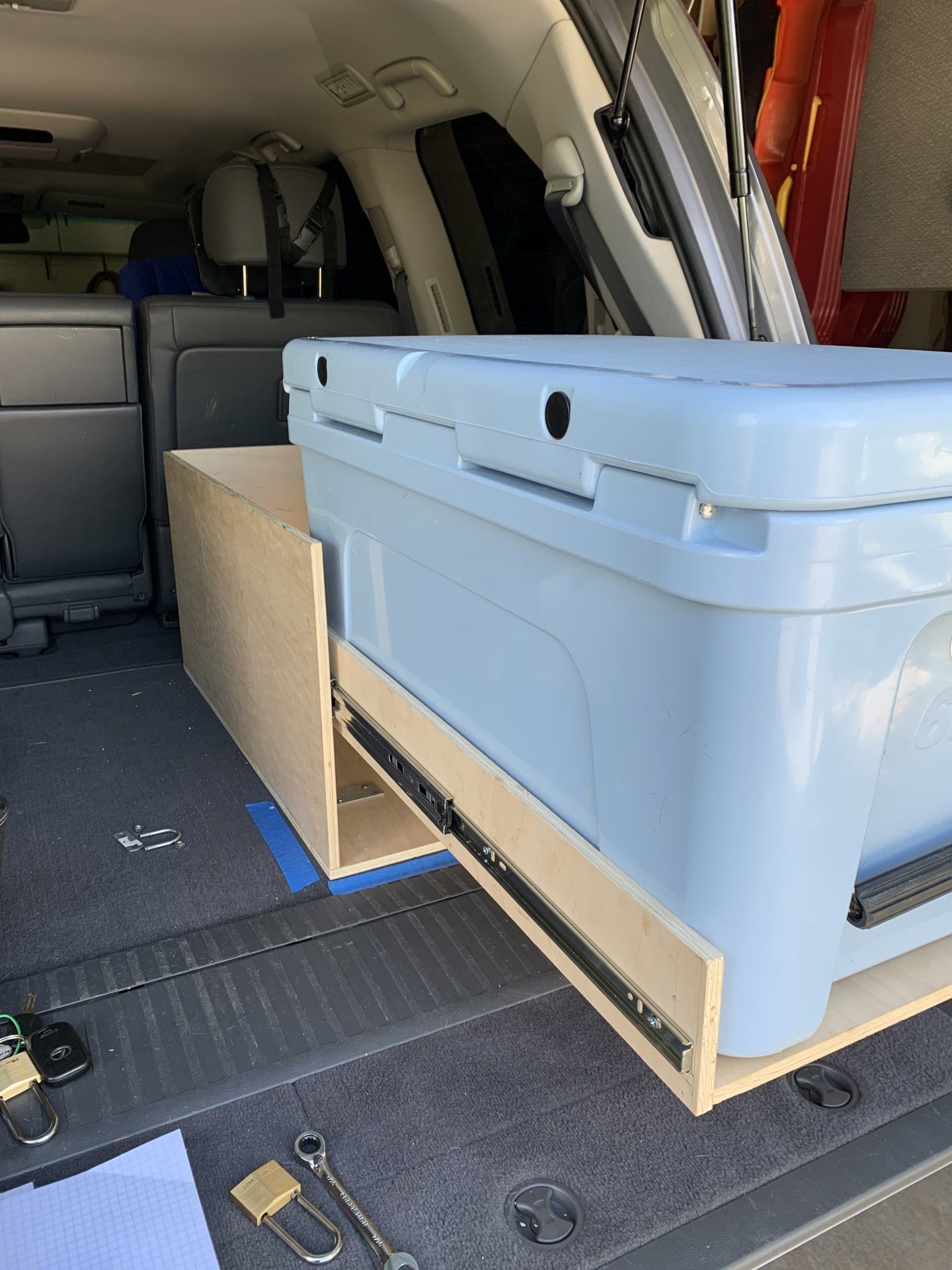

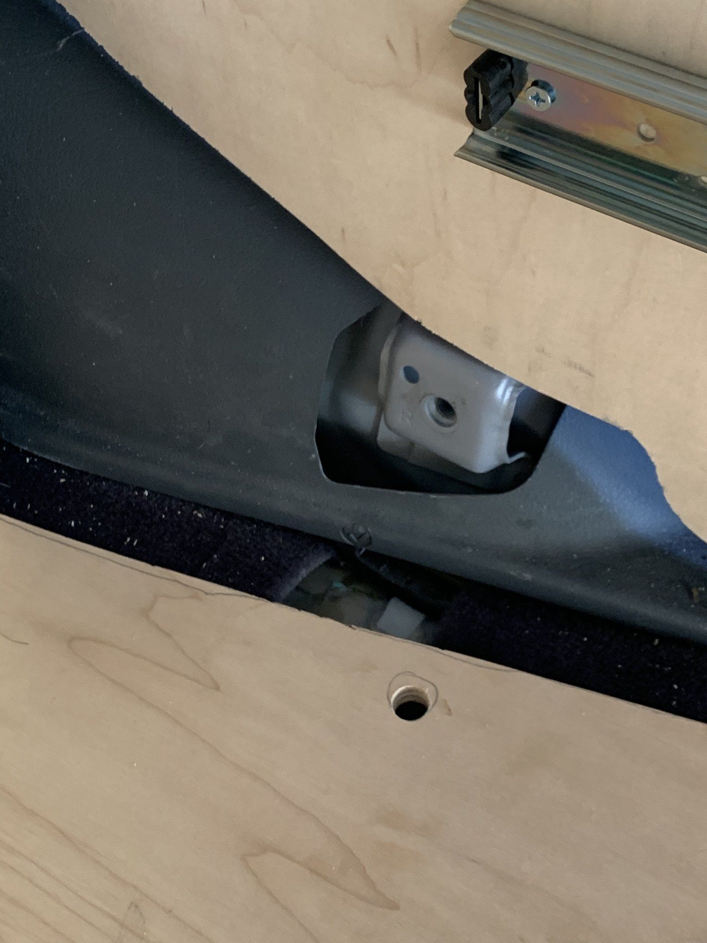

I started a DIY plywood box to slide out our Yeti 65 coolbox and made good progress. I'm handy so I winged the design. Got all the pieces cut and will assemble next weekend. Happy to share what I did. Toughest part was figuring out how/where to mount to the floor without drilling into the frame :)
@colodad that's good to hear. I would definitely be interested in seeing what you came up with for the floor attachment locations.

How did you mount this plate to the floor? I am going to do similar. Put an ARB drawer on the DS and build a cubby to hold three water cans side by side and a dry goods box on the PS. The PS will either be another drawer, the water/dry box cubby or the seat depending on need, but the base will remain fixed.
