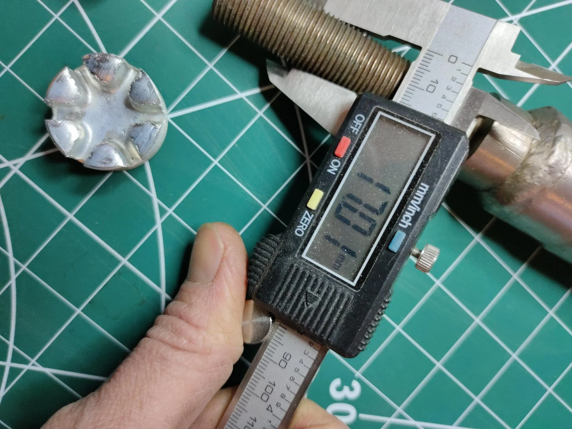

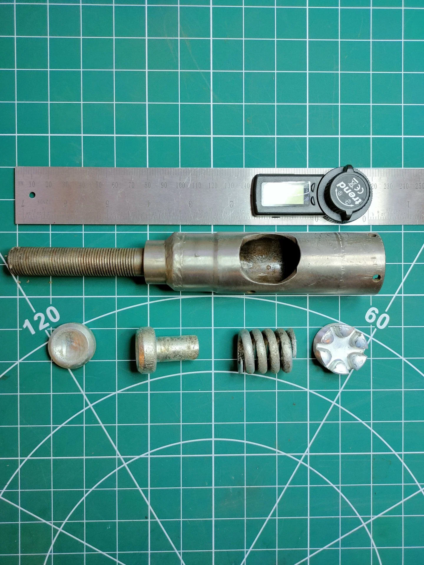

I have a late 75 Fj40 with a 2f . A some point it has been fitted with Power Steering, the Koyo box has a Pitman arm connect to this drag link. I wanted to either refurb or replace it but it doesn't look like any I can see on the parts stores. Any ideas what it's from. The rod connected to it is Toyota as it's marked.
Thanks. Loider
I have now worked out what the PO has done. This is a Power Steering Box of a Mitsubishi Fuso Canter Truck with Mitsubishi Pitman Arm and Drag Link which is connected to the Toyota Rod. This appears to be a clever solution using the original steering column and original linkage and center arm.
