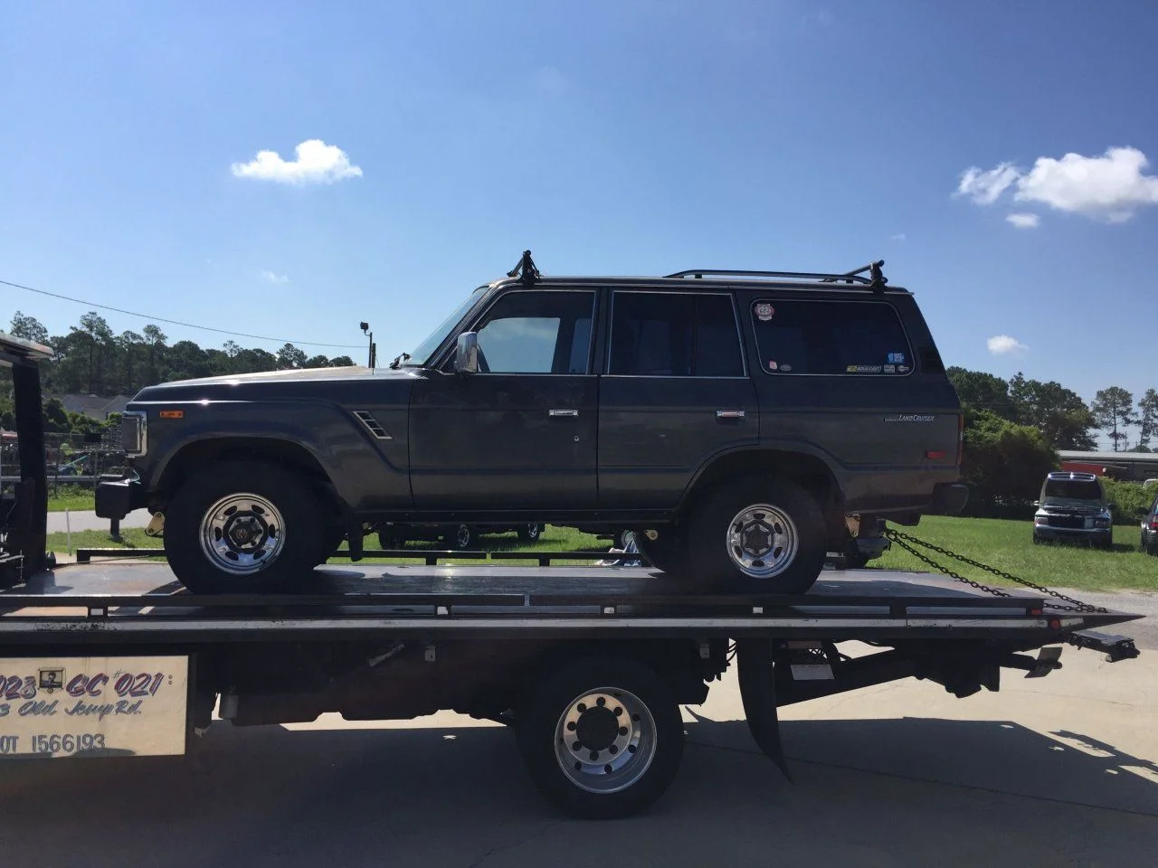

That's pretty much it other than some shakedown driving. I'll post more when it gets back from the exhaust shop. In the meantime, here's a pic of the Ghost on the flatbed; I hope this is the last time I ever see this scene!

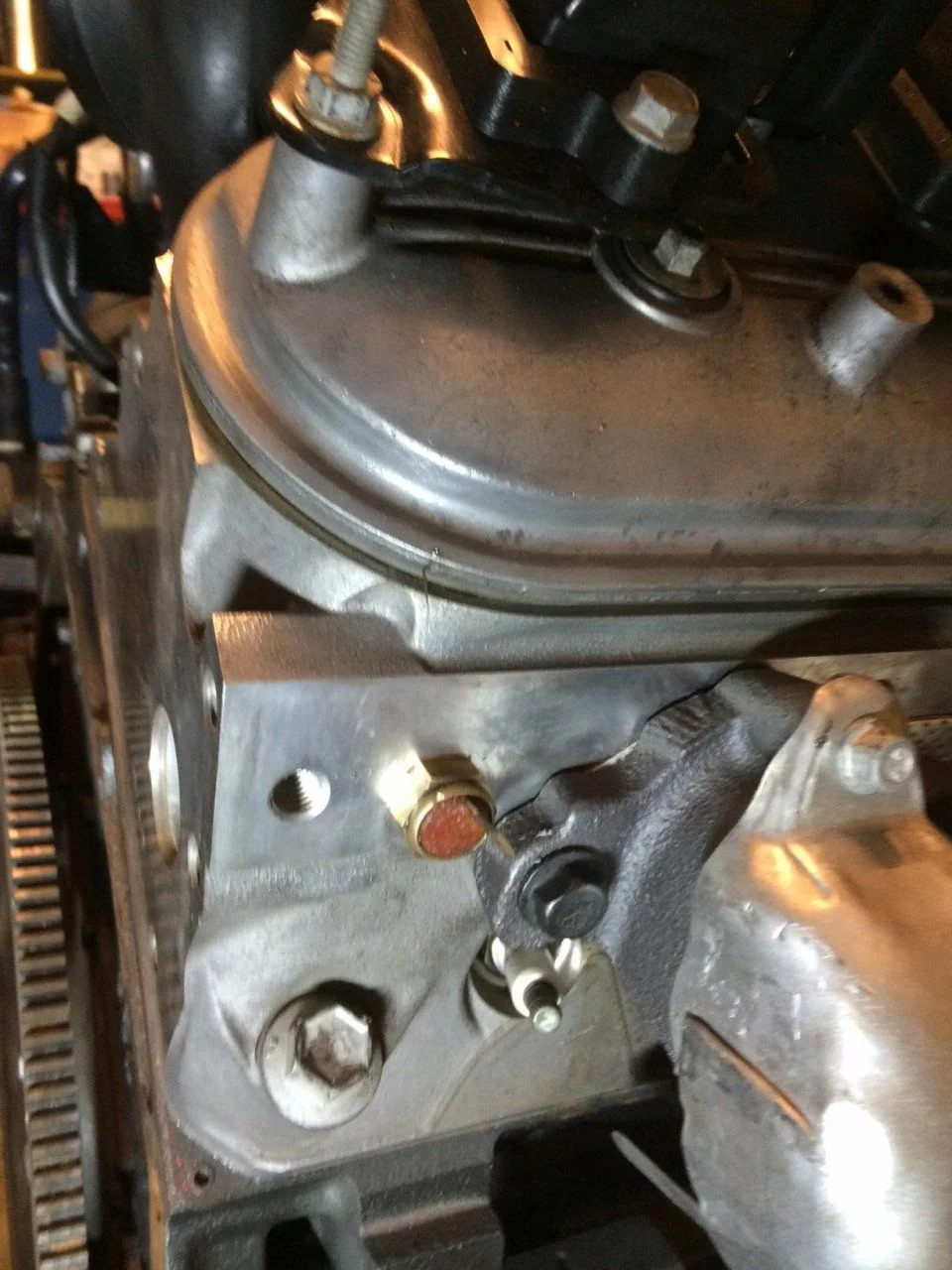

There is a plug on the PS head by the fire wall, same as the DS head, backward. Pick up your temp there.
Agreed. Installed my stock water temp sender here:

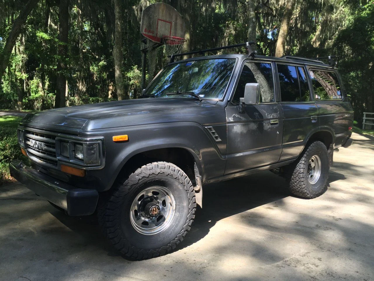

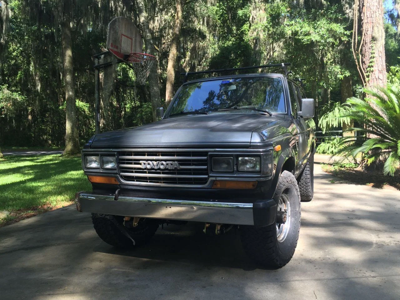

Here's a couple of pics I took the day I left it:

By the way, I wasn't planning to spend significant cash on anything other than the engine swap, but I have to say I couldn't be happier with the unplanned purchase of the OME suspension and the BFG KO2's. Both were badly needed and I'm super happy with the look. I ended up going with 33x12.5 tires, and I think they filled out the wheel wells perfectly. However, as you can see above there's a little bit of rake to it; I installed a light duty front and a medium duty rear OME kit, and that med duty kit is really beefy! I was planning for the long haul - swing-out bumper, rooftop tent, fridge, drawers, gear, etc, but I don't know if it'll make much difference.

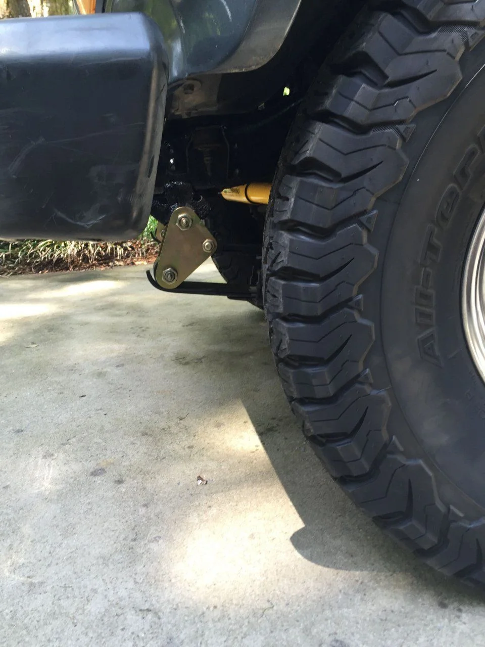

That said, for anyone who has installed these OME kits, please take a look at the front shackles in the pic below; I'm not sure we installed them correctly. It seems that if they were reversed it might raise the front end up just a little...
Awesome that it's working so well.
I know both you and your brother's locations say Brunswick
but is that a Florida plate and the St. Pete bridge I spy?
Keep us posted on how the 12.5s do on stock rims please (wear, handling, etc). The dearth of decent load range C or D tires in 16" sizes has me looking to go back to 15". 33x10.5 are just a skosh narrow for my liking and would like to run the factory steelies as you have. Looks great and I'm stoked you have it on the road!
I say shackle is correct. Mine is in the same orientation and the anti-inversion pin is supposed to hit the frame on extreme compression. Mine had a little rake as well and as much as I had seen others say it. It took about 1000 miles and driving around with it loaded up to get the springs to settle. My lean is pretty much within 1/4" and the rake is very slight ( as expected due to input form Bryce at cruiseroutfitters).

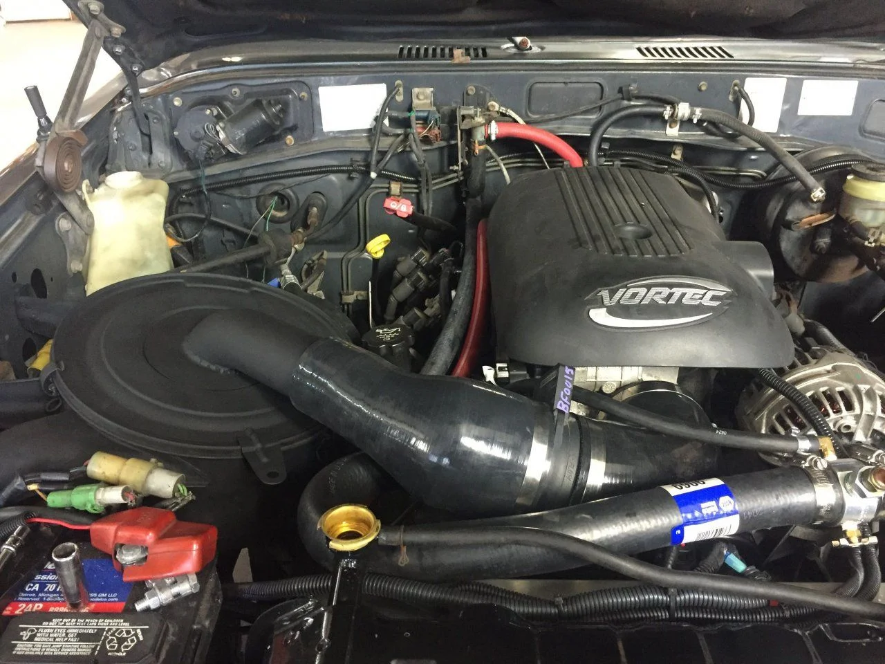

So my bro, @Dsellers, surprised me with this yesterday:
Very sweet custom-modified air intake inspired by Forge Specialties (@35inchoverdrive). I'm having serious withdrawals being away from the Ghost right now, but clearly it's in good hands...
We just ordered up some new EBC rotors and Green Stuff pads, Wagner brake shoes, new Wagner headlights (low and high beam), and a Blue Sea dual USB port. But I'm super stoked about this sweet intake!

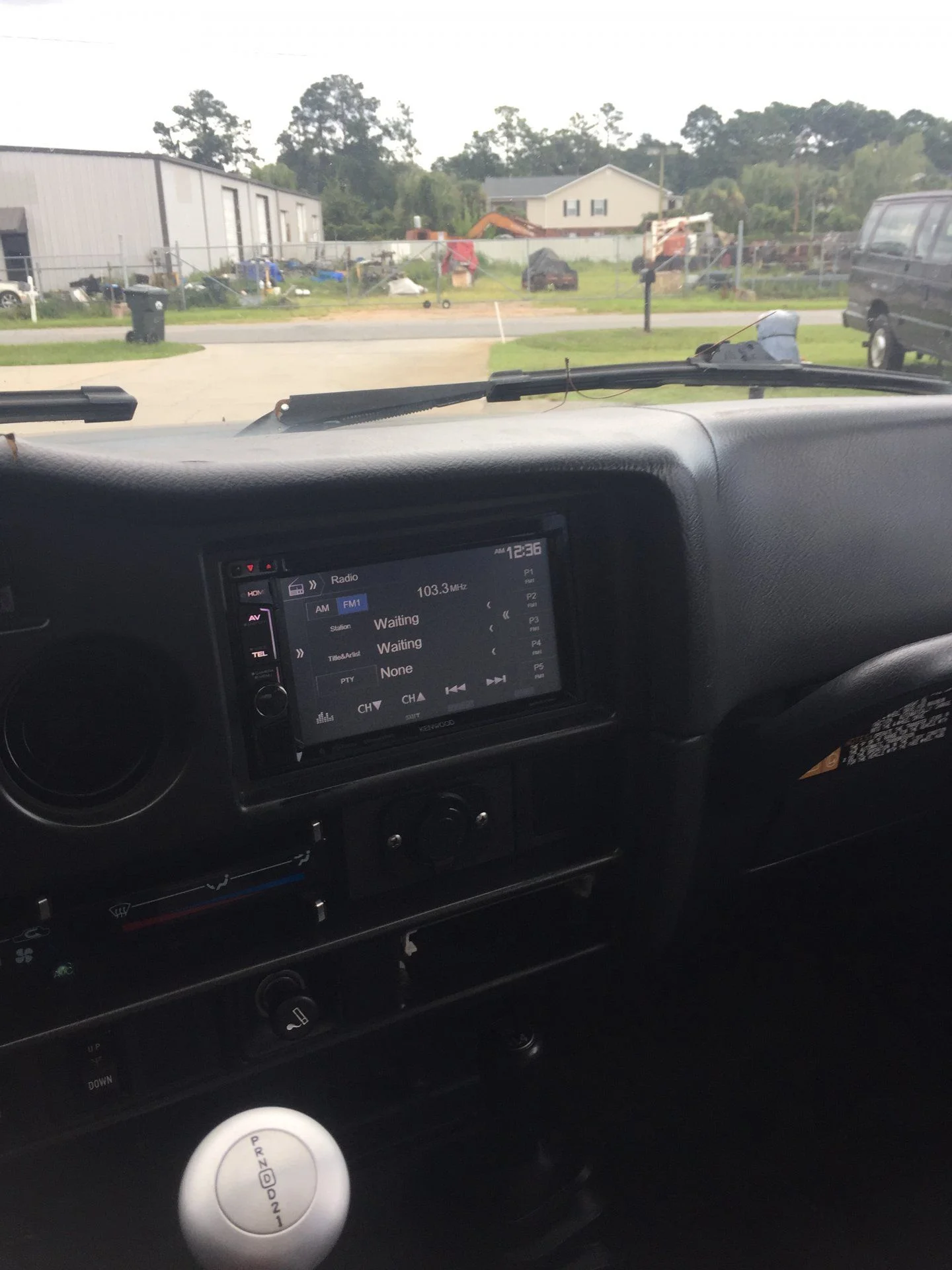

- New Kenwood DVD head unit and Kicker speakers all around

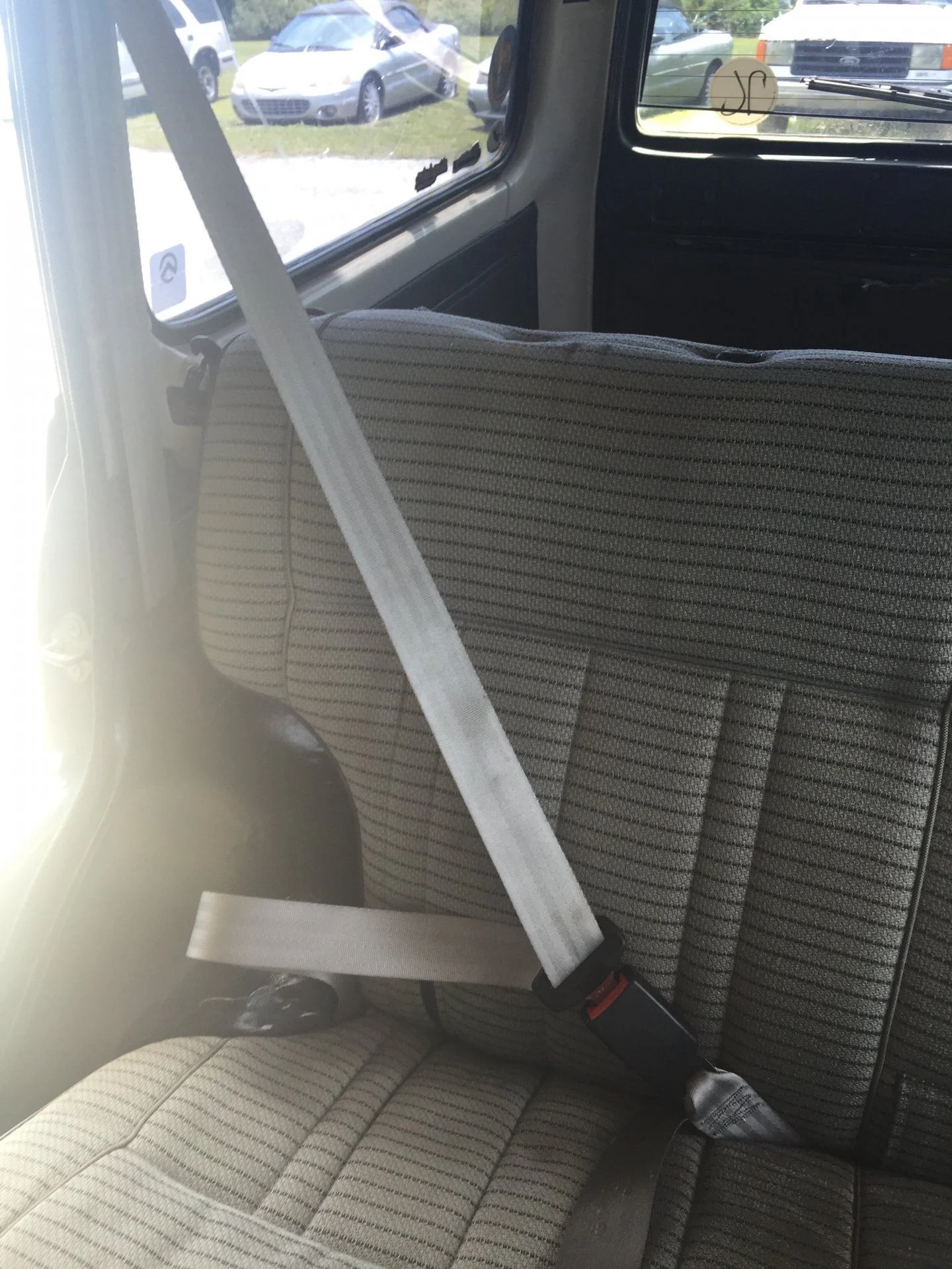

- Installed rear 3-point seat belts from Seat Belt Planet

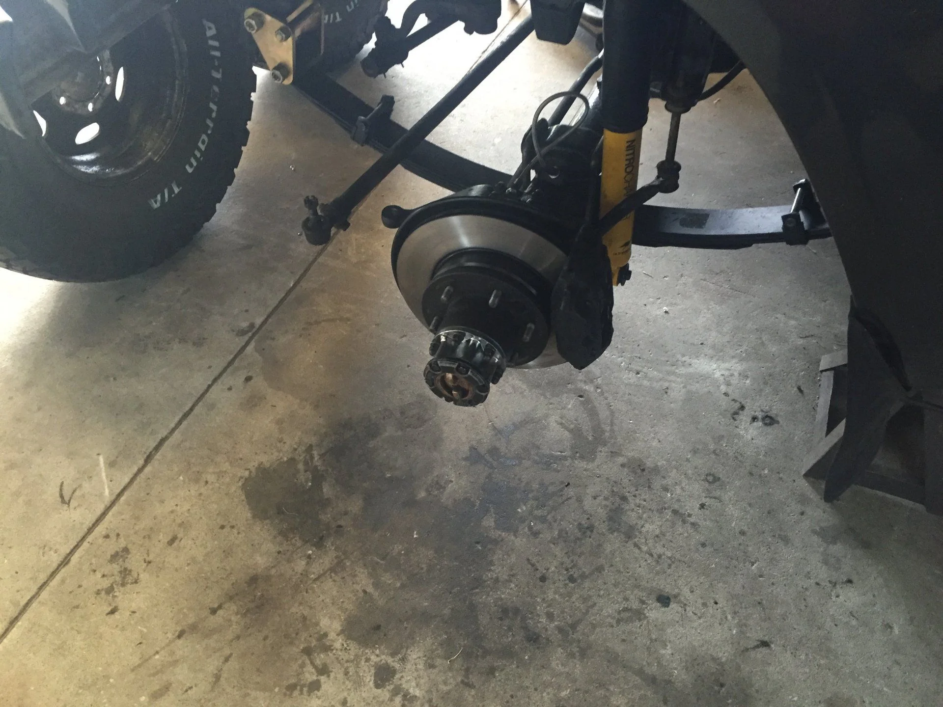

Pics of the driver's side knuckle rebuild, rotors, and then the seat belts:

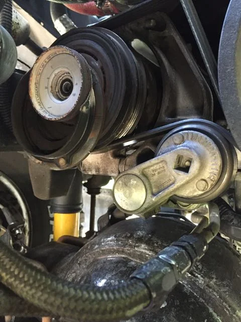

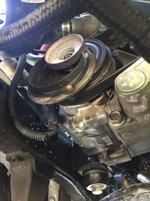

So I went back to Georgia and drove her home at the end of August. Halfway through the trip up I-95 I noticed it was getting warmer inside and I had not turned off the a/c. However, it had definitely stopped working. Made it home, though, and when I checked it the next day, this is what I saw:
The clutch on the a/c had seized, so I removed the belt and left it alone since summer was pretty much over. I would wait until spring before putting on a new Denso a/c compressor, dryer, and new o-rings and belt.

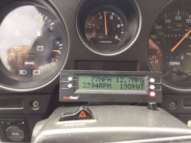

We road-tripped it quite a bit last fall, testing out the Vortec and the rest of the upgrades as much as we could. Drove it seven hours to Asheville for Overland East; you can see it cruises very nicely above 75 at 2400 rpm and 13mpg... Those Derale electric fans and the new radiator have never allowed the engine to creep above 211 degrees, even on the hottest days of summer; the fans kick on at 209 and drive it right down to 190, then start the process over. We have the fan that sits over the a/c compressor hard-wired as well, so that whenever the A/C button is on, that particular fan is on.
