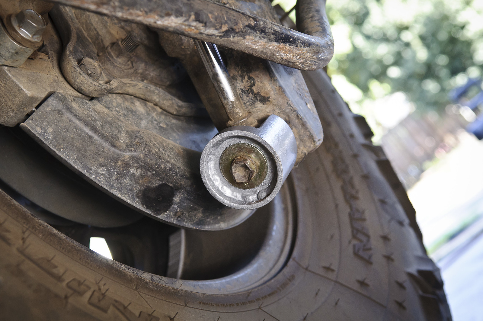

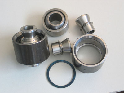

+1 except I don't think johnny joints are the bees knees. Tapped 7075 is indeed nice but expensive. Not worth the weight savings on an 80, especially for experiments that may require a rev 2 :)
I agree, I'd just stick to DOM links and knowing what I know now, 1.25 FK heims.
