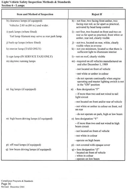

back to a serious note.
the following is taken directly fro the BC inspection Manual, what is your take on this?:
last page, sorry if they are blurry. i am having a hard time resizing these things...
if someone can walk me through then i will repost larger or i can send them off to someone that will do this for me...
let me know what you think of this in comparrison to what we were told earlier in the thread...
cheers
