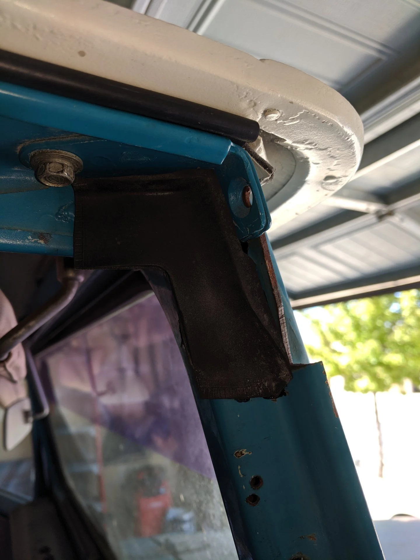

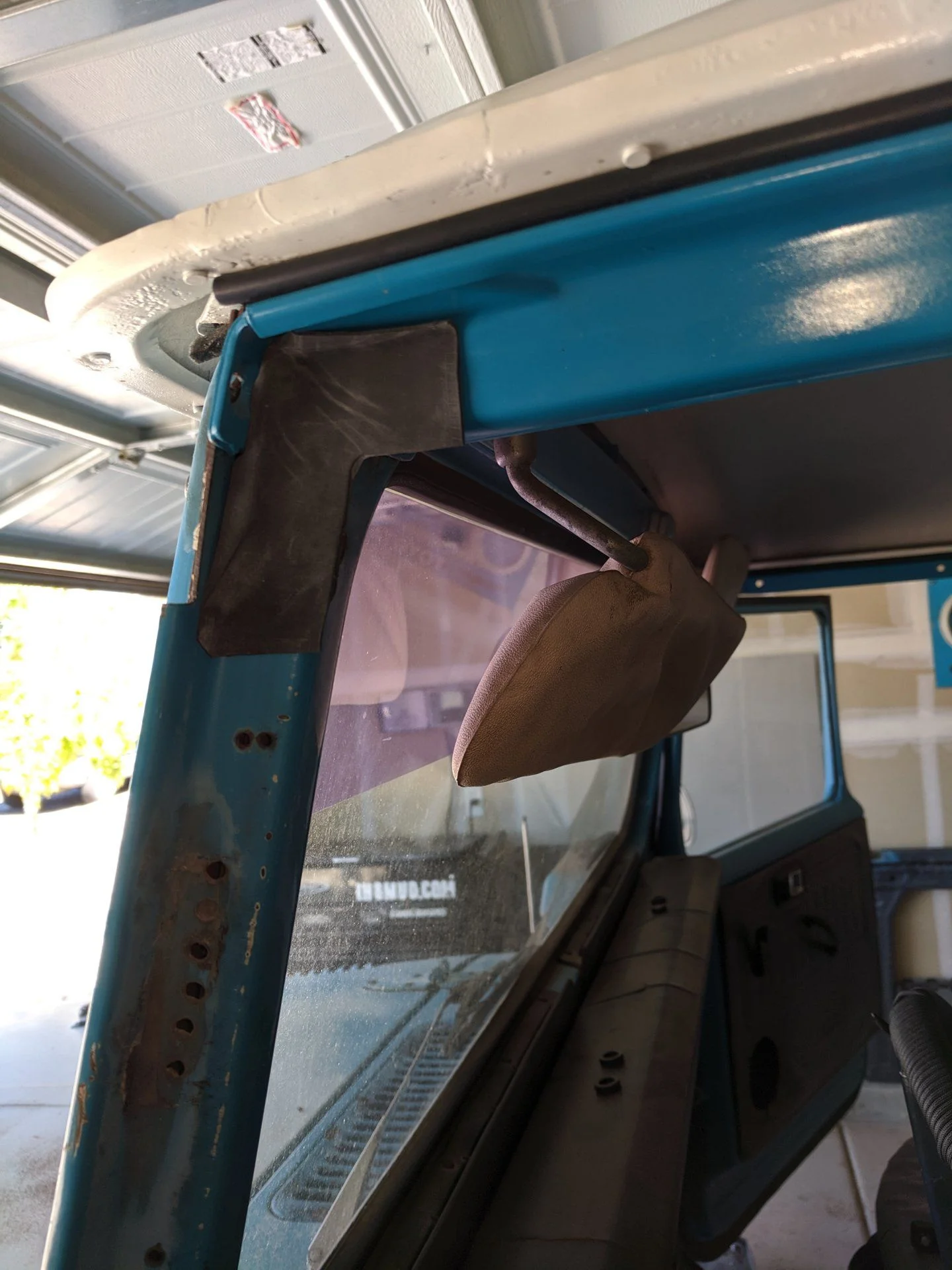

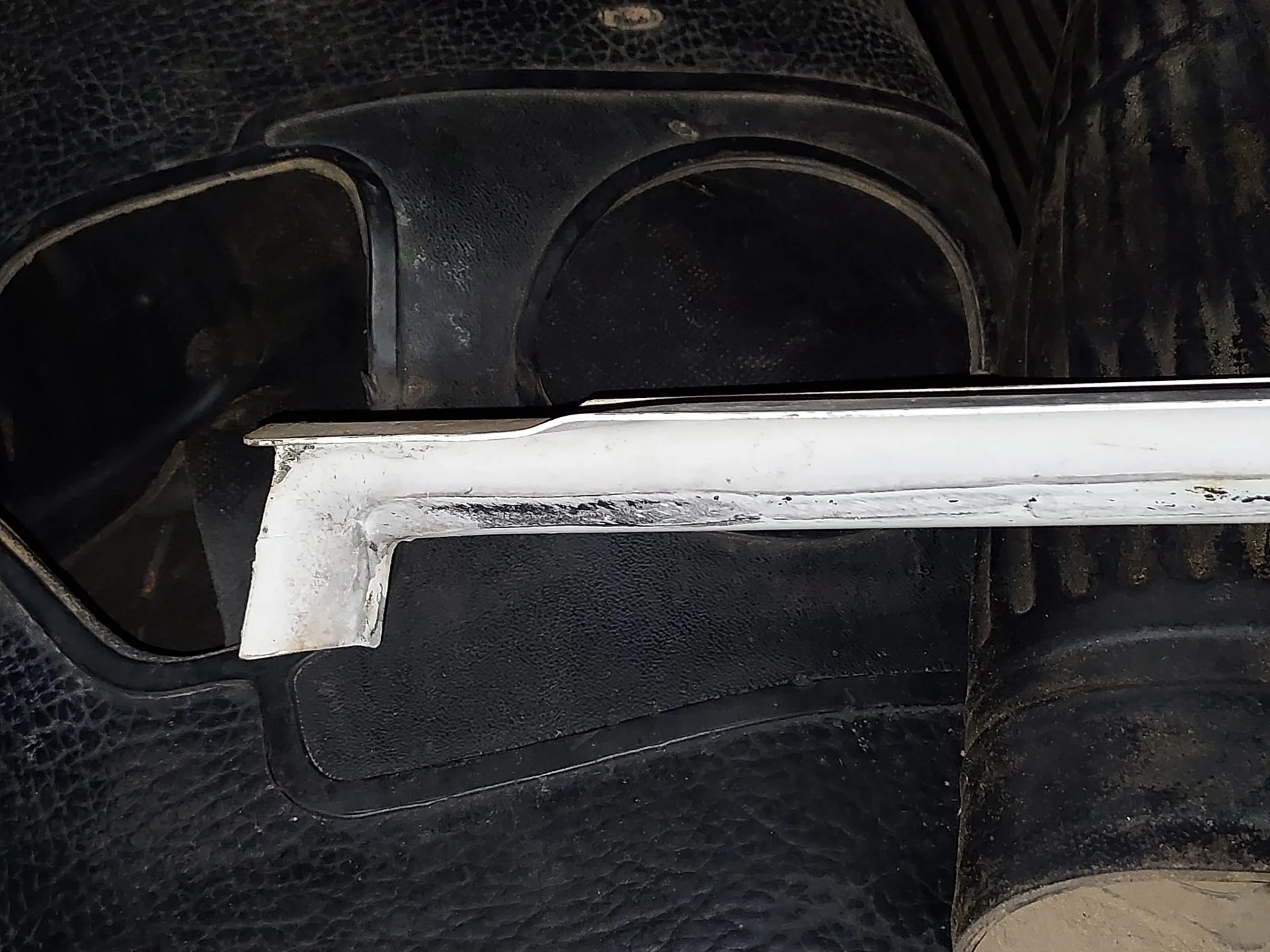

I recently put new door weatherstripping and have these pieces but I'm not sure how to install them. m top bow either doesn't look like the one in the pictures from @Racer65 website or I can't see how that goes. Can anyone help me out?
I think I figured it out or at least I did it this way.
I had to glue on the side onto the windshield part with the other part left unglued so that I can slide the bow top into it. Which was just a little tricky but I think it turned out ok.

It's still holding up so far. I think the key is just to make sure to get that 3M adhesive tacky enough before setting it. Good luck.
