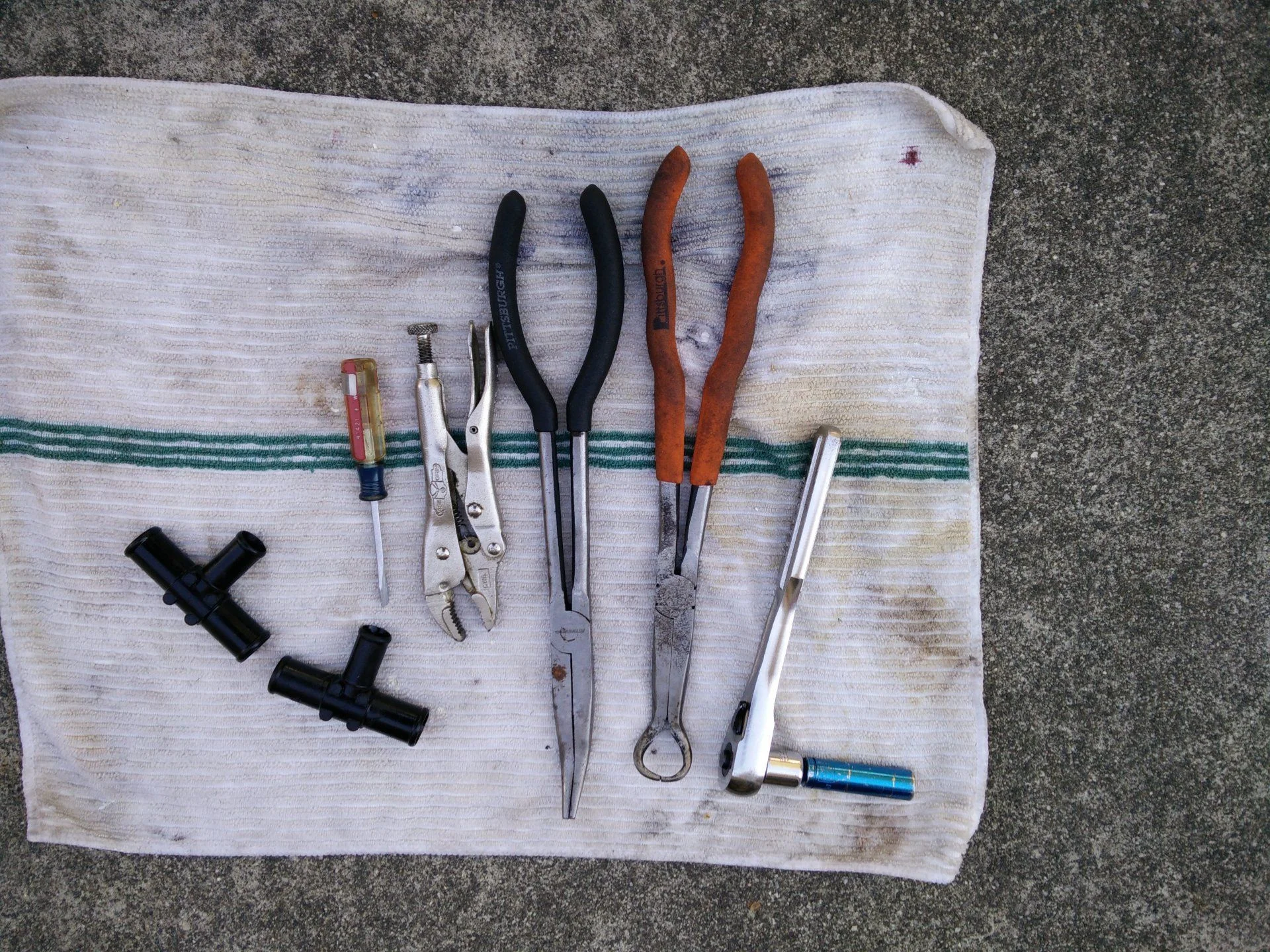

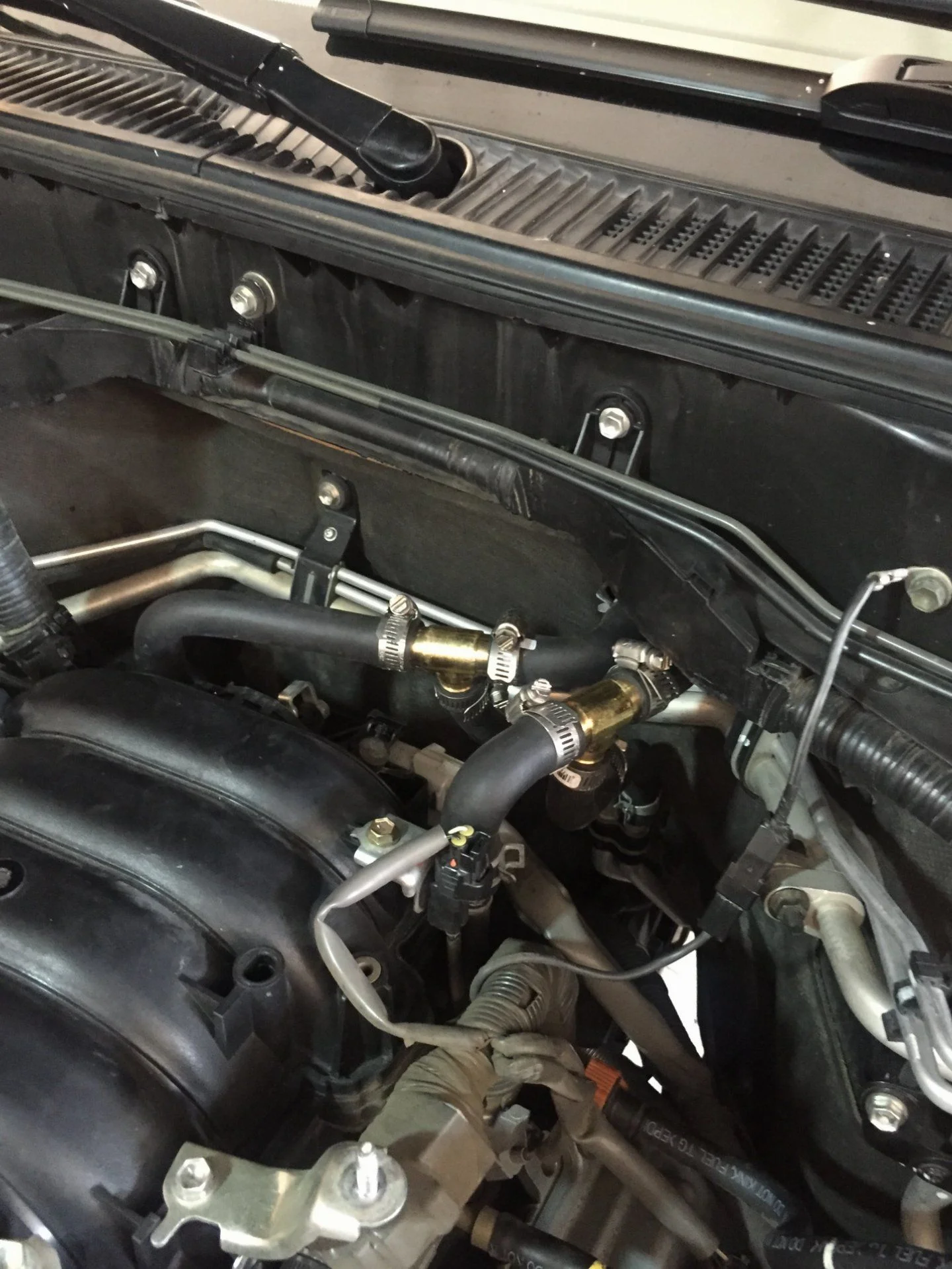

Took this threads advice and changed my Heater Ts too.
Used the 5/8" Brass barbed recommended - Amazon purchase for $9.56 each.
Indeed Toyota positioned those clamps in the worst possible way to take off.
I found it was easiest to use small Vice Pliers - clamp down on them and
rotate - see photo for the tools I used.
I joined the Heater T club!!
I found the plastic ones in great shape.
Still I feel more confident replacing them anyway - hate to loose my Engine
over something simple like this.
