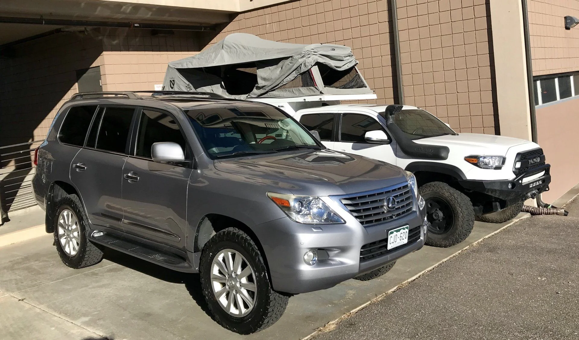

I downsized to 33x11 on 18" Tundra wheels + 25mm spacer. Slight rubbing on front fender liner at full lock in reverse and front mud flap had to go.
Other folks here have stuff 34s in, but get your saw out.

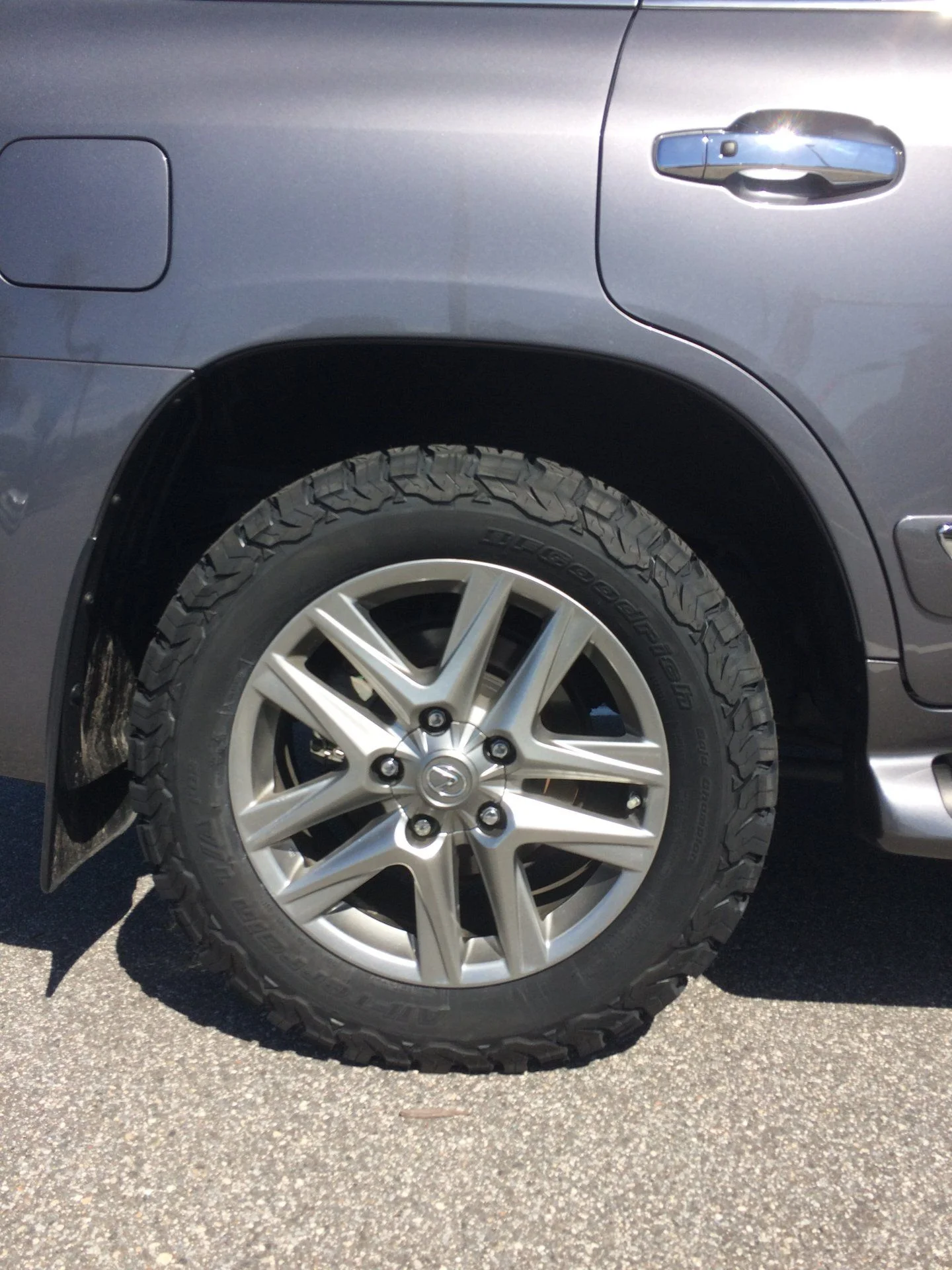

If you're downsizing to 18, the largest I have seen that doesn't rub is the BFG KO2 275/70/18. I mention BFG KO2 along with the size because other tires in that same size do rub, but I have a stock LC and changed these tires out from stock on my stock 2016 LC 18 wheels and have no rubbing at all. It's listed by BFG to be 33.2 inches.

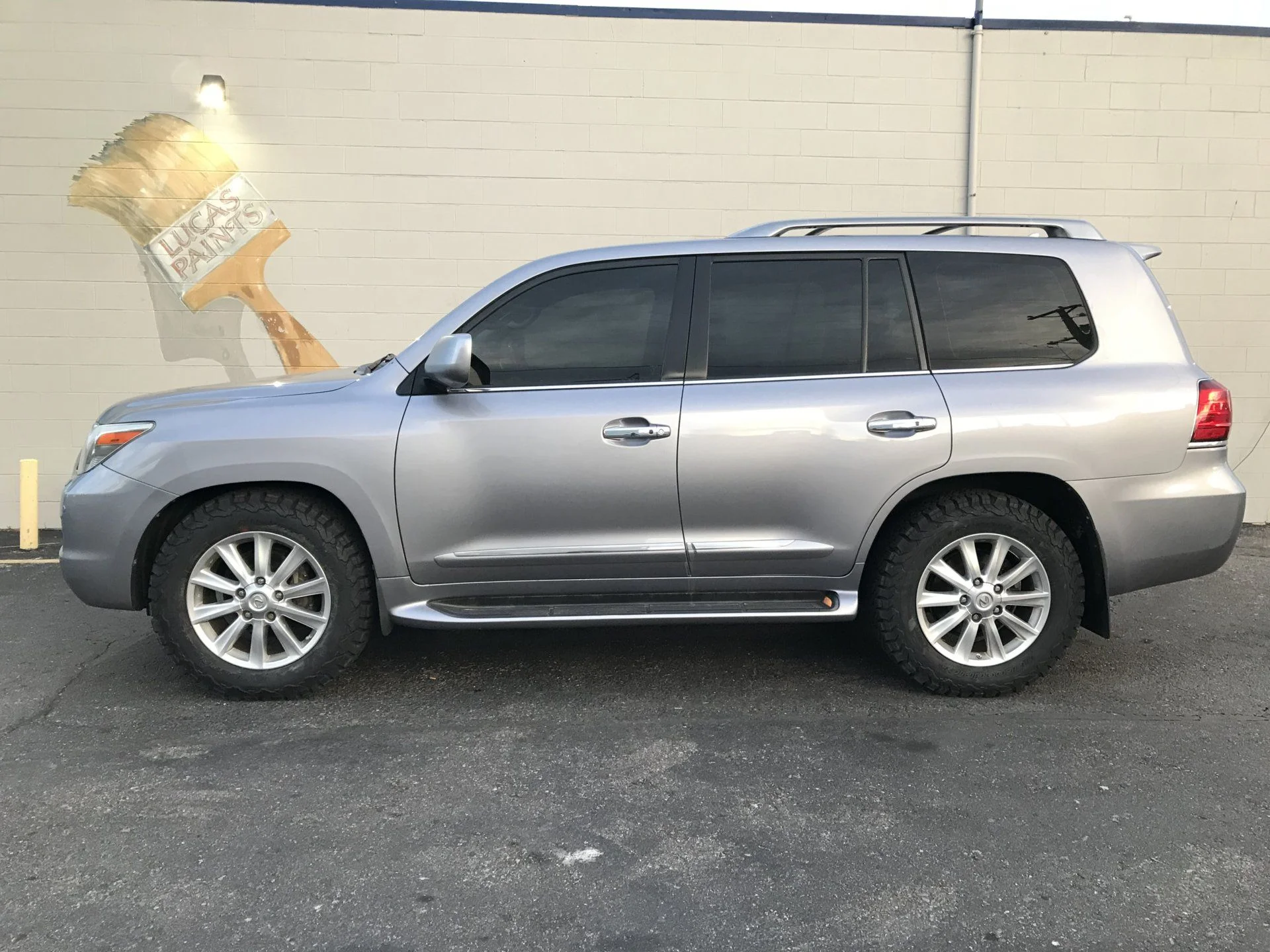

I went about as big as you can with the OEM 20s - 275/65/20 which is a 34” tire. No clearance issues after I removed the mud flaps but I would never run chains up front because there just isn’t enough clearance on the UCA. In the rear I don’t think there would be any issues. Here it is in the neutral position:
And in the high position from another angle. These tires are appreciably bigger than my 285/70/17 ATZs on the Tacoma:
