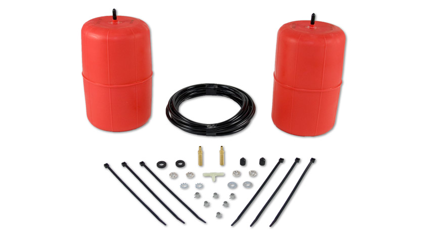

Does anyone know what size helper air bags will fit inside the Dobinsin 2.5 rear springs? I love the springs. They kicked butt in Moab last week. But I have a lot of squat when really loads with gear and when towing.
Either of these would work.
Nope. I bought the first one and it is literally half the size it need to be. They don’t work as anything but bump stops. The second one looks right but I really want to hear from someone that has installed them on a second gen sequoia before I waste more money.

So what helper airbag is correct for the 2.5 inch rear lift? I think those previously mentioned on this thread are for non-lifted? So is the taller AirLift 60755 the way to go?
