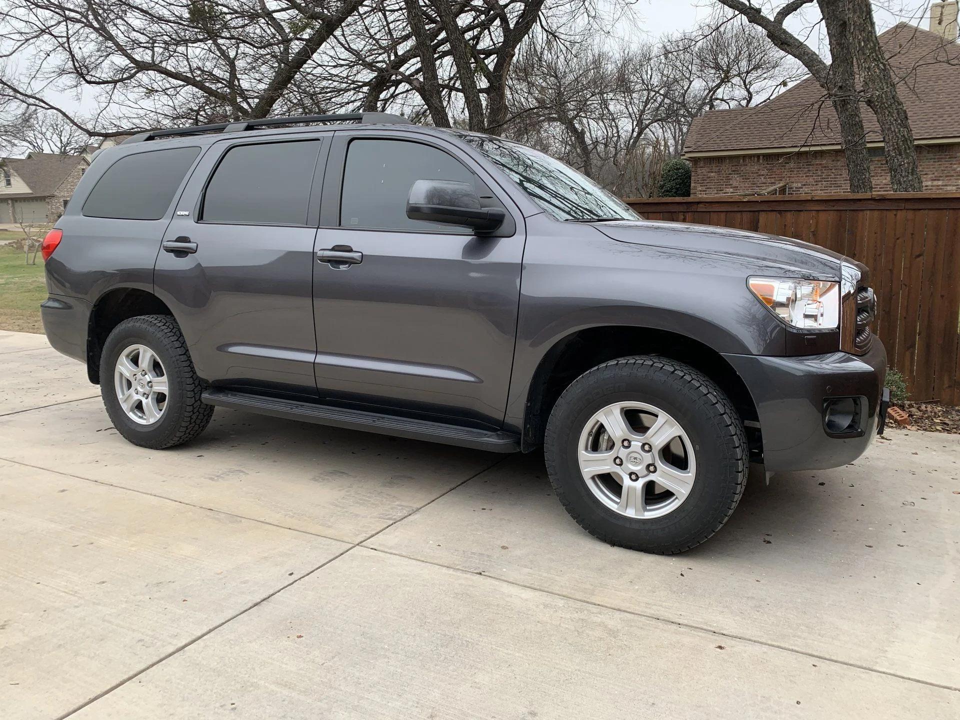

Curious where you guys are sitting ground to frame and what lift and tire size combo you have. Anyone have ground to frame (to the rear of the vehicle behind the transmission crossmember) measurements? My Sequoia seems pretty low stock. 11" on the dot sitting on 275/65/18s.
Eagerly waiting on my Dobinson Suspension. Currently sitting on 295/70/18s, no rubbing on the road.

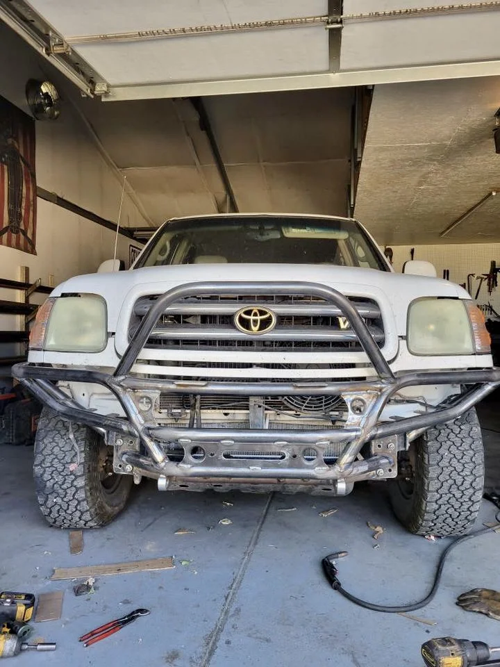

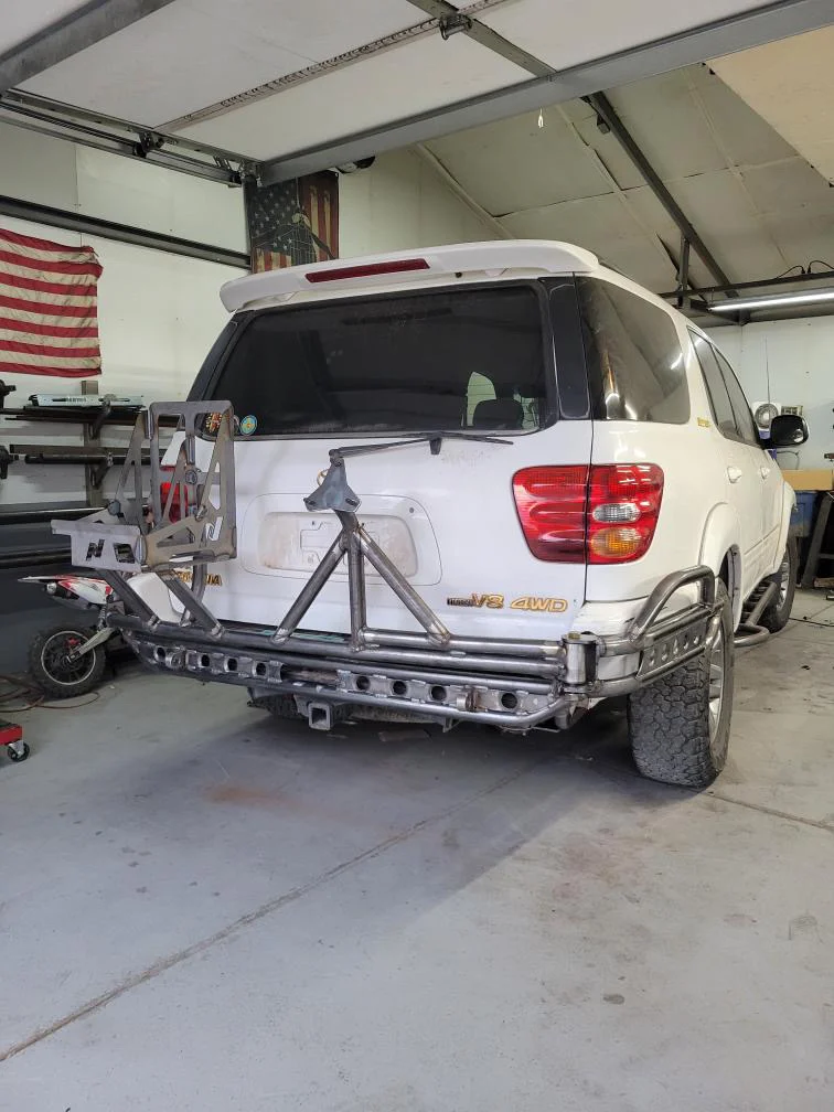

What springs would you recommend for an 04 Sequoia? I want a 2 inch lift. I'm going to need an heavy spring rate for front and rear. I have aftermarket bumpers and plan on a winch in the front.
All the options are in the first post. Dobinsons don't offer heavier load rear coils. The front shouldn't be a problem, as they're a pretty strong spring rate, and if you use the IMS struts, you can raise that height up. But for the rear, it will ultimately depend on how heavy the rear bumper is you have.
Who is making a rear Sequoia bumper these days?
I’ve seen others use different springs that weren’t specific to the sequoia on their rig from Dobinson. I might have to do a little more research to dial it in.
They are custom bumpers.

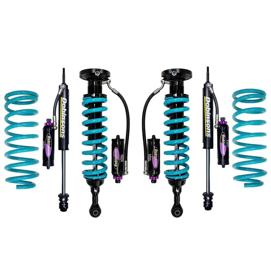

I just added some HUGE UPDATES to the first post. The MRA 3-Way Remote Resi Strut/Shock Options are now in stock and ready to ship for the 1st and 2nd Gen Sequoia's. They're also in stock for the 3rd Gen, but I'll make a new thread for that model.
The 1st Gen MRA's are a regular style that uses the existing Dobinsons coil option up front.
The 2nd Gen MRA's are a coilover design up front, using different rate coils, an upside down configuration, and still have the same 3-Way adjustable valving (low and high speed compression as well as rebound adjustments.

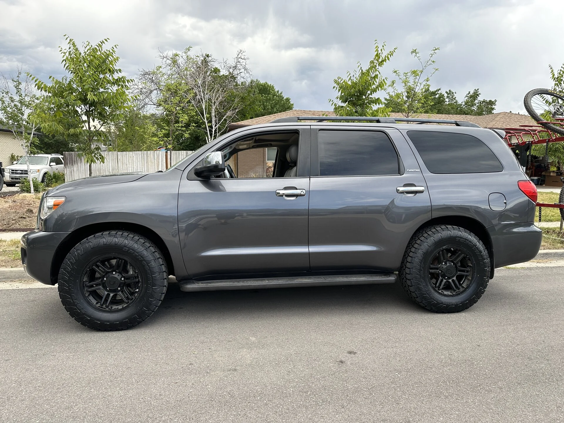

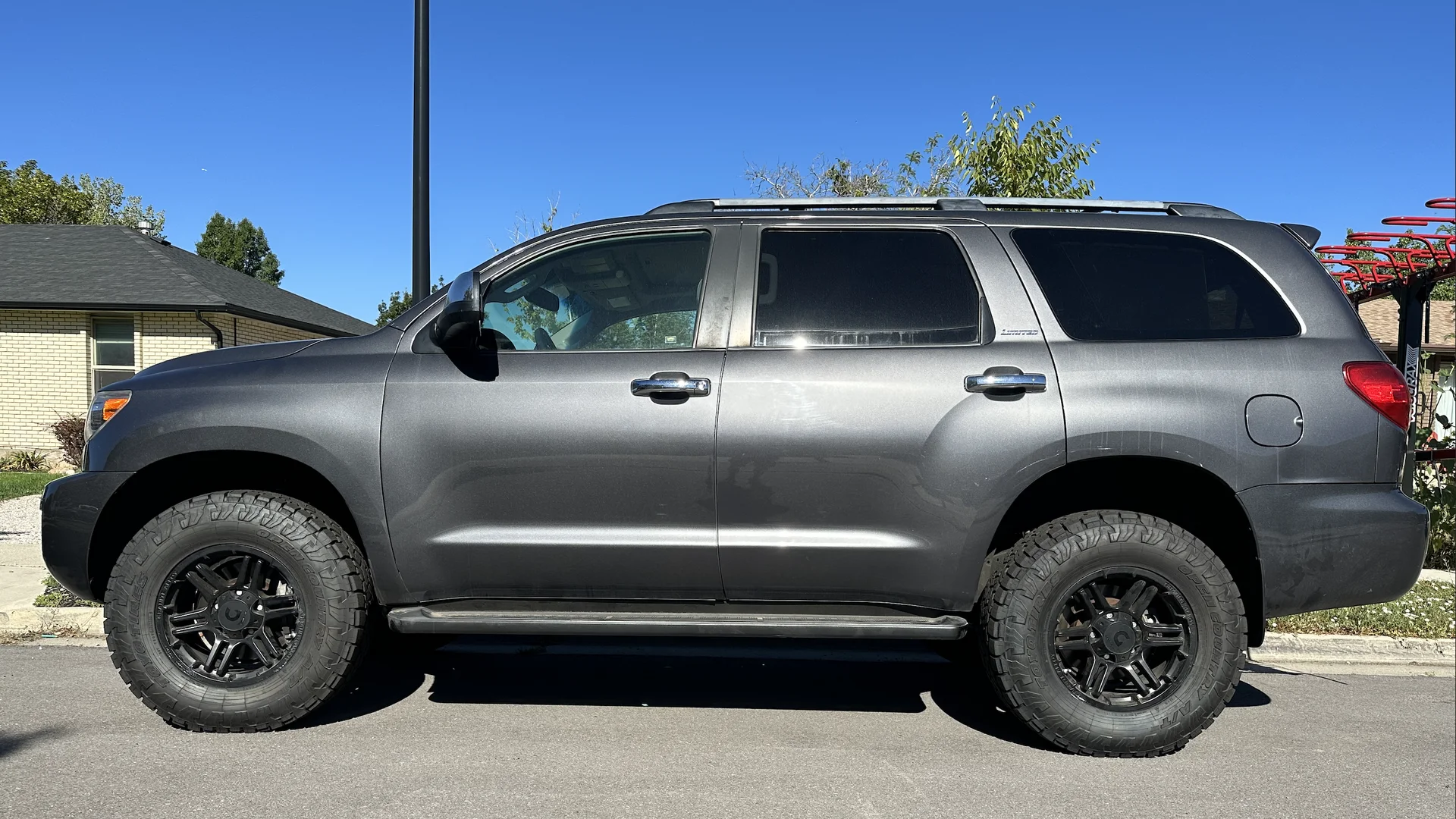

Do you have F/R hub to fender measurements on this with the 1.75" lift?
Approximate measurements:
Left Front 21 3/8”
Right Front 21 5/8”
Left Rear 22 3/4
Right Rear 23 1/4
I have the full 1/4 thick Valhalla steel skid plate and cat converter kit on it which probably weighs a couple hundred pounds.
