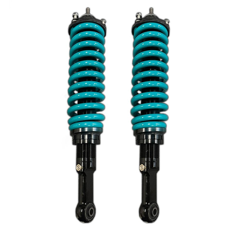

Hey Guys,
Breaking down our stock and raised height suspension options for the Sequoia suspension that we offer. Links to photos and kit ordering info is also down below.
2001 to 2007 Models
C59-342 - Front Coils - Stock height replacements
C59-344 - Front Coils - 1.75" Lift 370/370mm free height, 651LB/IN
C59-343 - Rear Coils - Stock height replacements
C59-345 - Rear Coils - 1.75" Lift 425/425mm free height, 212LB/IN
Front Strut Options
GS59-222 - Front Struts - Twin Tube Nitrogen Charged - 465mm extended, 335mm compressed
IMS59-50222 - Front Struts - IMS Monotube with IFP - 473mm extended, 335mm compressed
MRA59-A222 - Front Struts - MRA 3-Way Adjustable Remote Resi Monotube, adjustable height - 473mm extended, 335mm compressed
Rear Shock Options
GS59-682 - Rear Shocks - Twin Tube Nitrogen Charged - 630mm extended, 382mm compressed
IMS59-60682 - Rear Shocks - IMS Monotube with IFP - 634mm extended, 400mm compressed
MRA59-A682 - Rear Shocks - MRA 3-Way Adjustable Remote Resi Monotube - 620mm extended, 390mm compressed

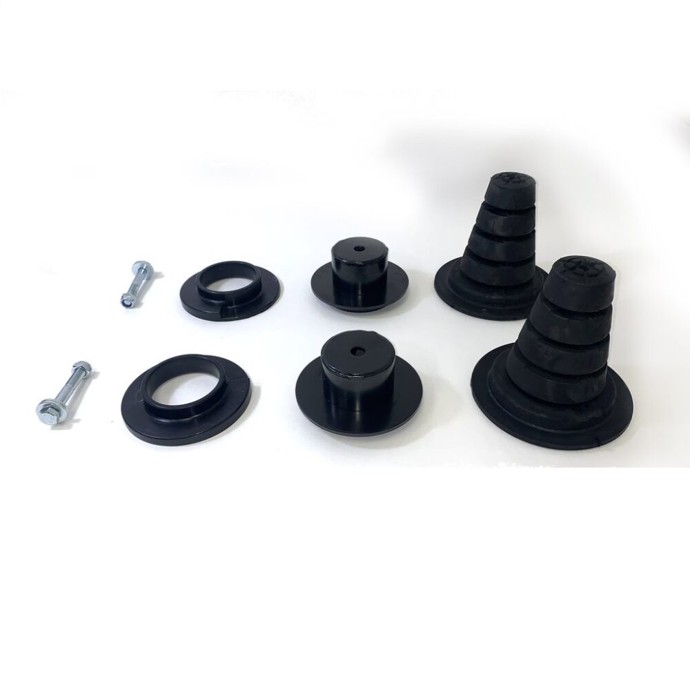

PS59-4030 - 1/4 Strut top mount spacer to add 1/2" of lift. Can use on one side to correct a lean, or use one on each side to add lift evenly
BS59-560 - Dobinsons Front Bump Stops, adjustable height, tune in the bump gap you want or need
CV Boot Kit - Not Dobinsons, they're All Pro, but given the age of the vehicle, re-booting the CV shafts is a good idea when lifting
Twin Tube Suspension Kit Builder - Dobinsons 1.75" Sequoia Suspension Kit for 2001-2007 - Exit Offroad - https://exitoffroad.com/product/dobinsons-1-75-lift-kit-for-toyota-sequoia-2001-to-2007-4-7l-v8/
IMS Suspension Kit Builder - Dobinsons 1.75" Sequoia IMS Suspension Kit for 2001-2007 - Exit Offroad - https://exitoffroad.com/product/dobinsons-1-75-sequoia-ims-suspension-kit-for-2001-to-2007-4-7l-v8/
MRA 3-Way Adjustable Suspension Kit - Dobinsons 0-2.5" MRA Sequoia Suspension Kit for 2001-2007 - https://exitoffroad.com/product/dobinsons-mra-0-2-5-sequoia-suspension-kit-for-2001-to-2007-4-7l-v8/
Stock Height Suspension Kit - Dobinsons Stock Height Sequoia Suspension Kit 2001-2007 - https://exitoffroad.com/product/dobinsons-stock-height-sequoia-suspension-kit-for-2001-to-2007-4-7l-v8/
2008 to 2022 Models - Does not suit Airbag suspension
C59-474 - Front Coils - Stock height replacements
C59-476 - Front Coils - 1.75" Lift 367/367mm free height, 685LB/IN
C59-720 - Front Coils - 2.5" Lift, 685LB/IN
C59-475 - Rear Coils - Stock height replacments
C59-477 - Rear Coils - 1.75" Lift 380/380mm free height, 624LB/IN
C59-719V - Rear Coils - 2.5″ Lift Variable Rate Coils
Front Strut Options
GS59-710 - Front Struts - Twin Tube Nitrogen Charged - 602mm extended, 445mm compressed
IMS59-60710 - Front Struts, height adjustable - IMS Monotube with IFP - 615mm extended, 445mm compressed lengths
SEQIMSCOILOVERS - Dobinsons 1.75-3.0″ Pre-Assembled IMS Coilovers for Toyota Sequoia 08-22
2GSEQMRACOILOVERS - Dobinsons 2.0-3.0″ Pre-Assembled MRA Coilovers, 3-Way Adjustable valving, adjustable height
Rear Shock Options
GS59-713 - Rear Shocks - Twin Tube Nitrogen Charged - 471mm extended, 315mm compressed
IMS59-60713 - Rear Shocks - IMS Monotube with IFP - 343mm compressed length, 489mm extended length
MRA59-A713 - Rear Shocks - MRA 3-Way Adjustable remote resi shocks
DD59-530K - Front Diff Drop Kit
PS59-4032 - 1/4 Strut top mount spacer to add 1/2" of lift. Can use on one side to correct a lean, or use one on each side to add lift evenly
WA59-563K - Rear shock extension kit - Allows use of GS59-713 rear shocks with the 2.5" height rear coils
Twin Tube Suspension Kit Builder - Dobinsons Sequoia Lift Kit 1.75"-2.5" for 2008-2021 5.7L V8 - Exit Offroad - https://exitoffroad.com/product/dobinsons-1-75-lift-kit-for-toyota-sequoia-2008-2018-5-7l-v8/
IMS Suspension Kit Builder - Dobinsons IMS Sequoia Lift Kit 1.75"-2.5" for 2008+ 5.7L V8 - Exit Offroad - https://exitoffroad.com/product/dobinsons-ims-sequoia-lift-kit-1-75-2-5-for-2008-2021-5-7l-v8/
MRA 3-Way Adjustable Suspension Kit - Dobinsons MRA Sequoia Lift Kit 2.0"-3.0" for 2008-2022 5.7L V8 - https://exitoffroad.com/product/dobinsons-mra-sequoia-lift-kit-2-0-3-0-for-2008-2022-5-7l-v8/
Stock Height Twin Tube Kit - Dobinsons Stock Height Sequoia Suspension Kit for 2008-22 - https://exitoffroad.com/product/dobinsons-stock-height-twin-tube-sequoia-suspension-kit-for-2008-2022/
