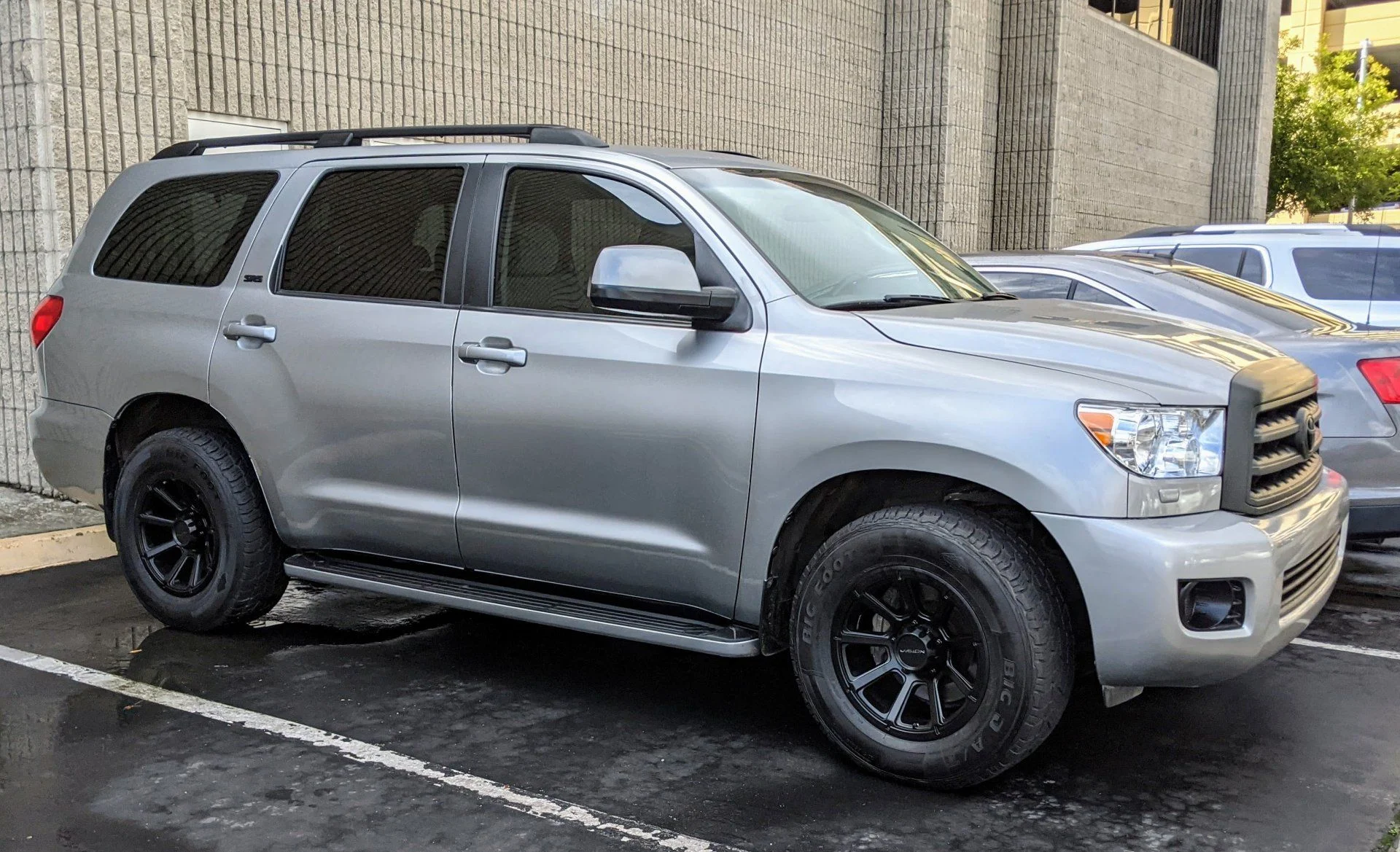

That looks awesome. Love those wheels. With those 17” wheels, just make sure the weights they add for balancing are out of the way of the calipers. It’s a pretty tight fit. I’ve seen where they will knock them offI just installed the 2.5" Dobinsons lift front and back.
Pre lift ride height hub to fender: 20.5" front, 21.25" rear
Post lift: 22” front, 24.5”rear
I gained 1.5" inch in the front and 3.25" in the rear. Exit Offroad said that should settle over the next month or two.
Build:
Dobinsons 2.5" lift kit for 2nd gen sequoia.
Pro Tune Dif Drop.
Icon Vector 5 wheels 17x8.5
Nitto Ridge Grappler 285/75 17 C rated tires
Black headlight mod....cooked in the oven
Black plasti-dip on all chrome. Gunmetal on front emblem.
