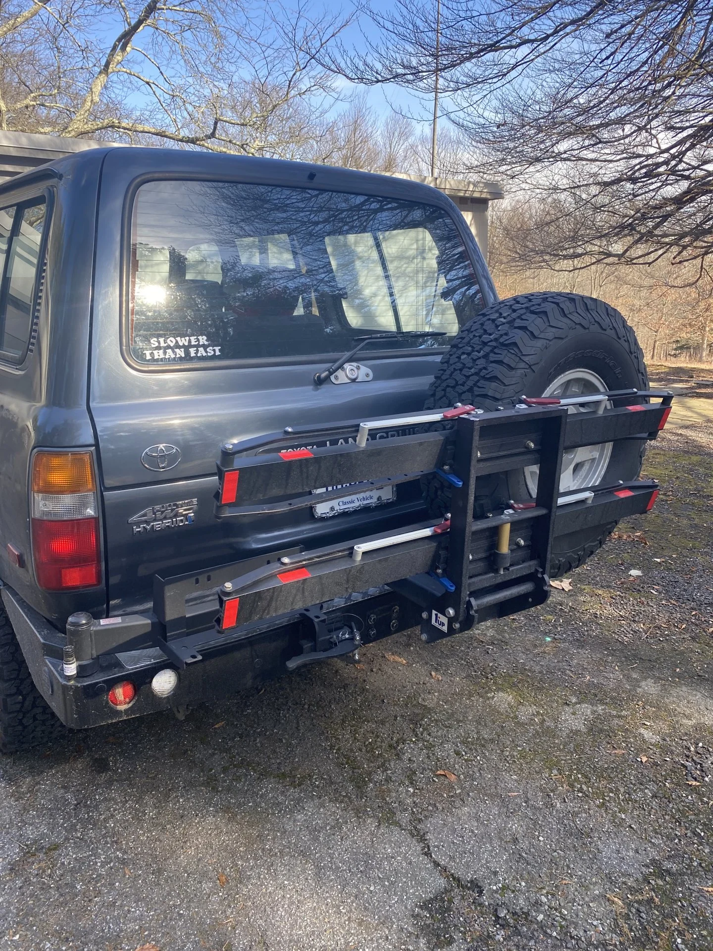

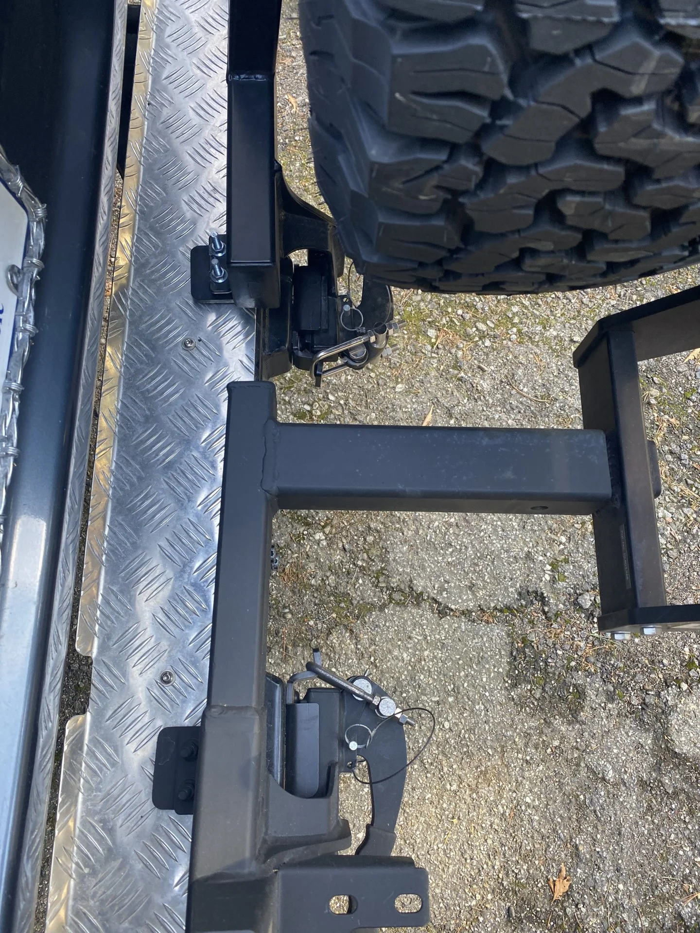

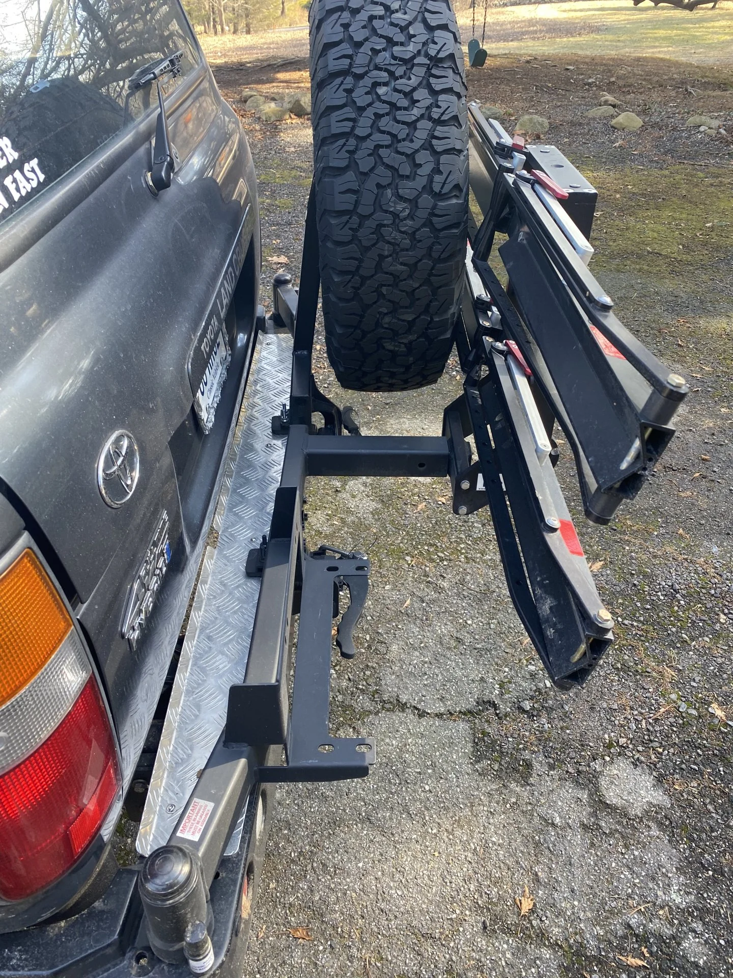

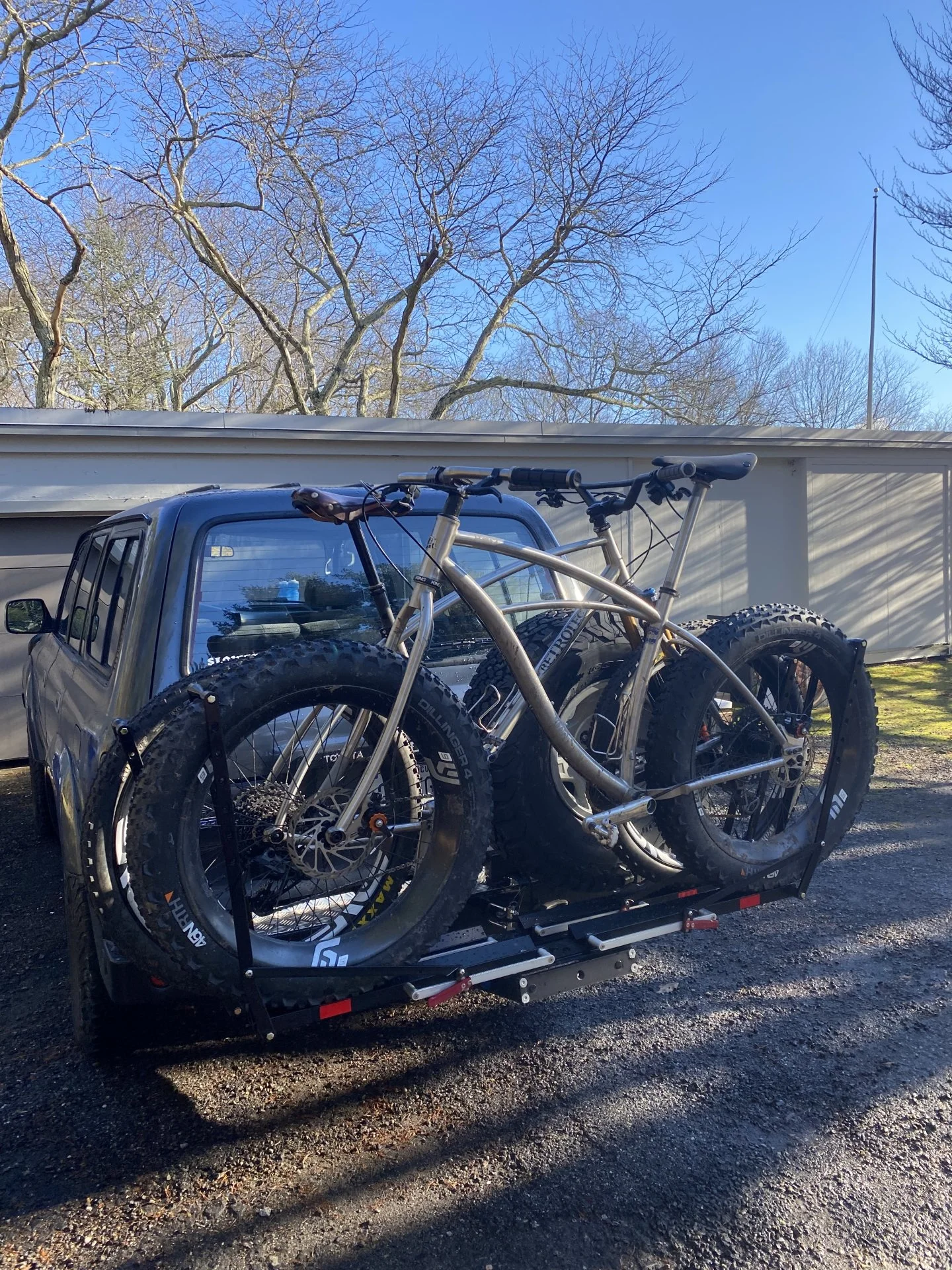

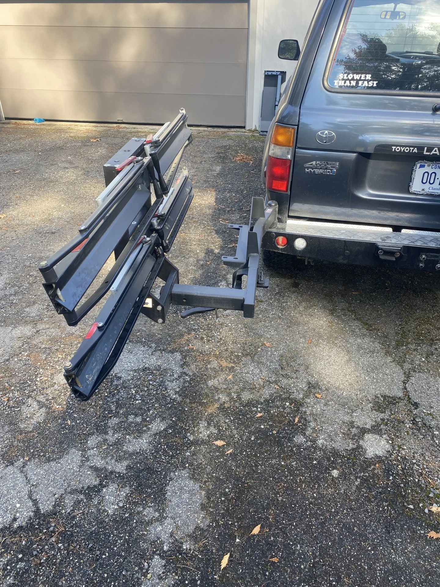

I have this same bumper, here was how I got the factory swingouts to work with a 1up rack:
