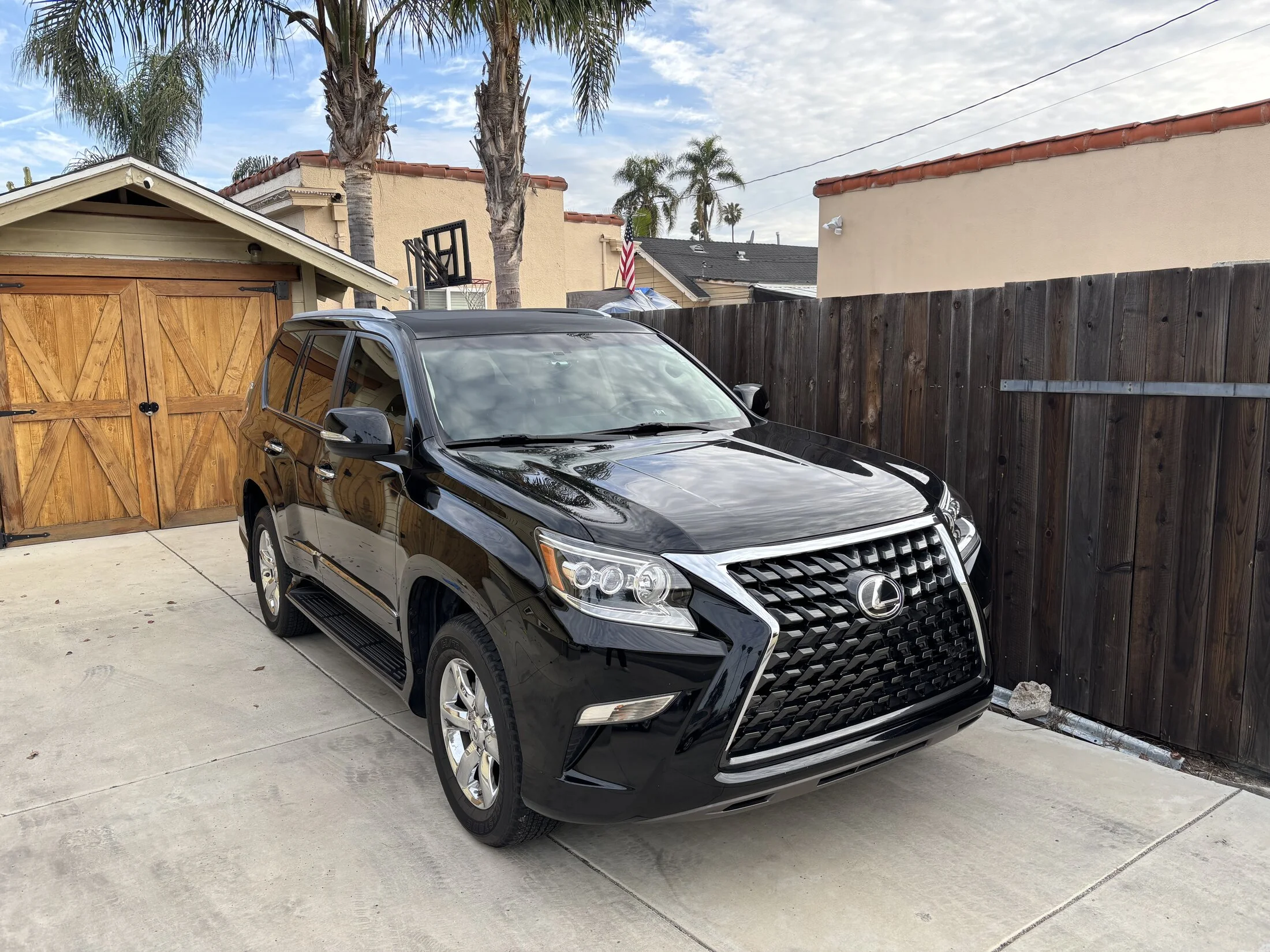

This is my GX at time of purchase (stock) and as it is now with:
4Runner OR wheels
Falken Rubitrek AT 265/70 17 tires
Cornfed 1.5" front and 1.0" rear lift
(still on the way: Lexus center cap decals)

Looks great!
Are you finding the ride to be a wee bit better with the smaller 17" rim and taller side walls?
Looks great!
Ride quality feels essentially the same, honestly. Actually the one thing that is noticeably better is that the truck doesn't seem to "track" in pavement ruts like it did on the stock wheels and tires (admittedly those were fairly clapped out original equipment tires with 29k on them).

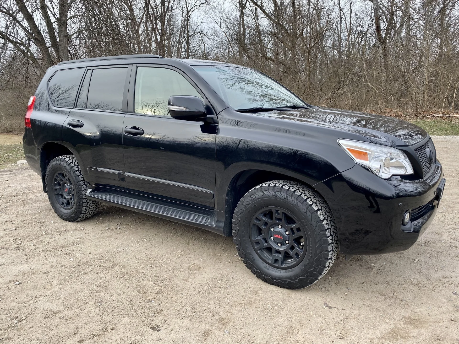

Hi,
Here is my set up: TRD Pro wheels from a 4Runner with 265 70 17 KO2s with no lift and no spacers.
TRD Pro wheels with 265 70 17 KO2s with no lift or spacers.
