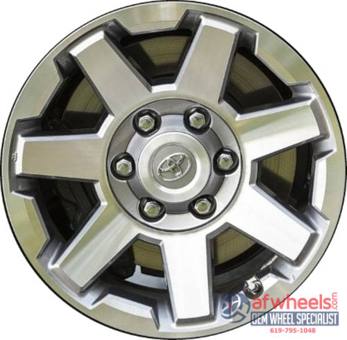

Are the rims that you are asking about different in dimension than the ones I showed?

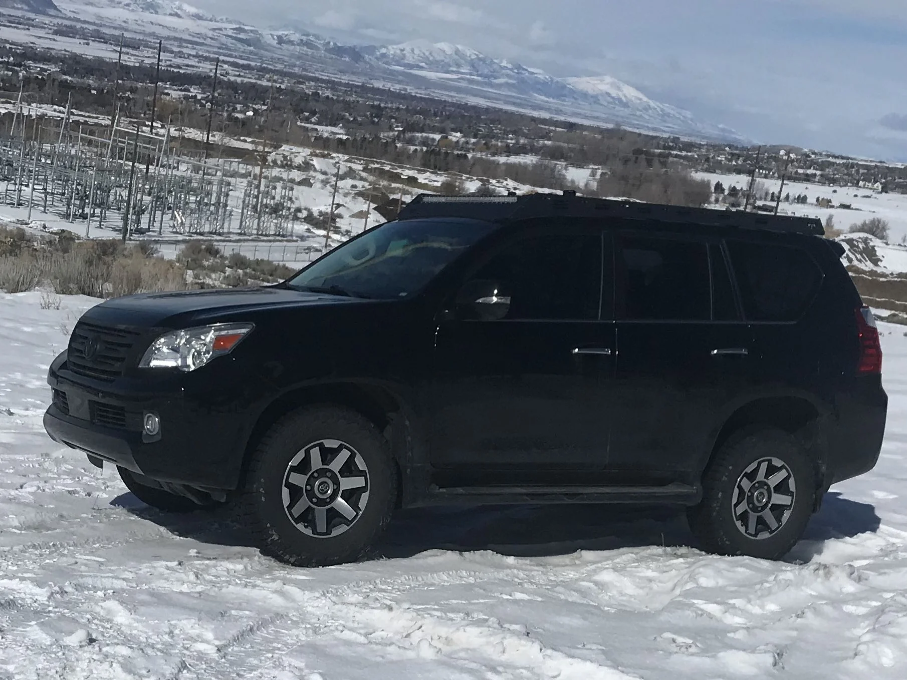

Looks like both the older and newer Trail wheels have the same +15mm offset so you should be fine. I ran 255/70's on the factory 18's without a lift and had very little rubbing. Those tires are shorter and only 4/10" narrower and they have a much more positive offset.
I have these wheels with 265/70/17 Falken AT3w tires. I chose them over the Pros because they are half an inch wider and have better valve stem protection. I did push back the plastic a bit with a heat gun which stopped any rubbing I was getting. My spare is an FJ wheel with same tire size but different brand so I'm not sure how well a Wildpeak fits.

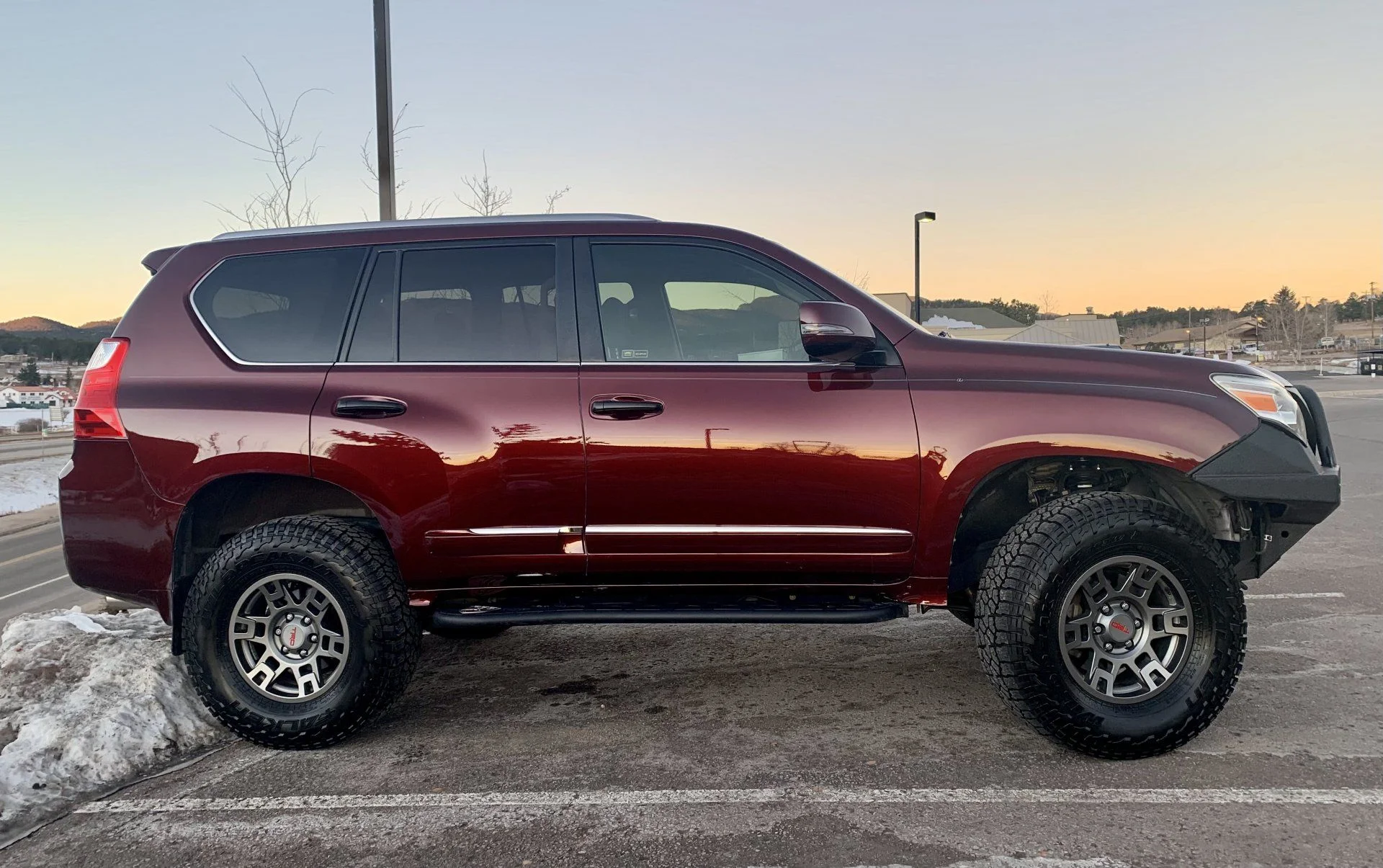

A few days late, but I’m here. I’ve been running the older trail wheels for a couple months with no issues. The 265/70s should fit well as long as it’s nothing too aggressive. I’ve got 275/70s with a 2” lift and I do get some slight rub on the factory steps while braking hard and turning. I plan on having most of that area cut off when my sliders go on soon.
