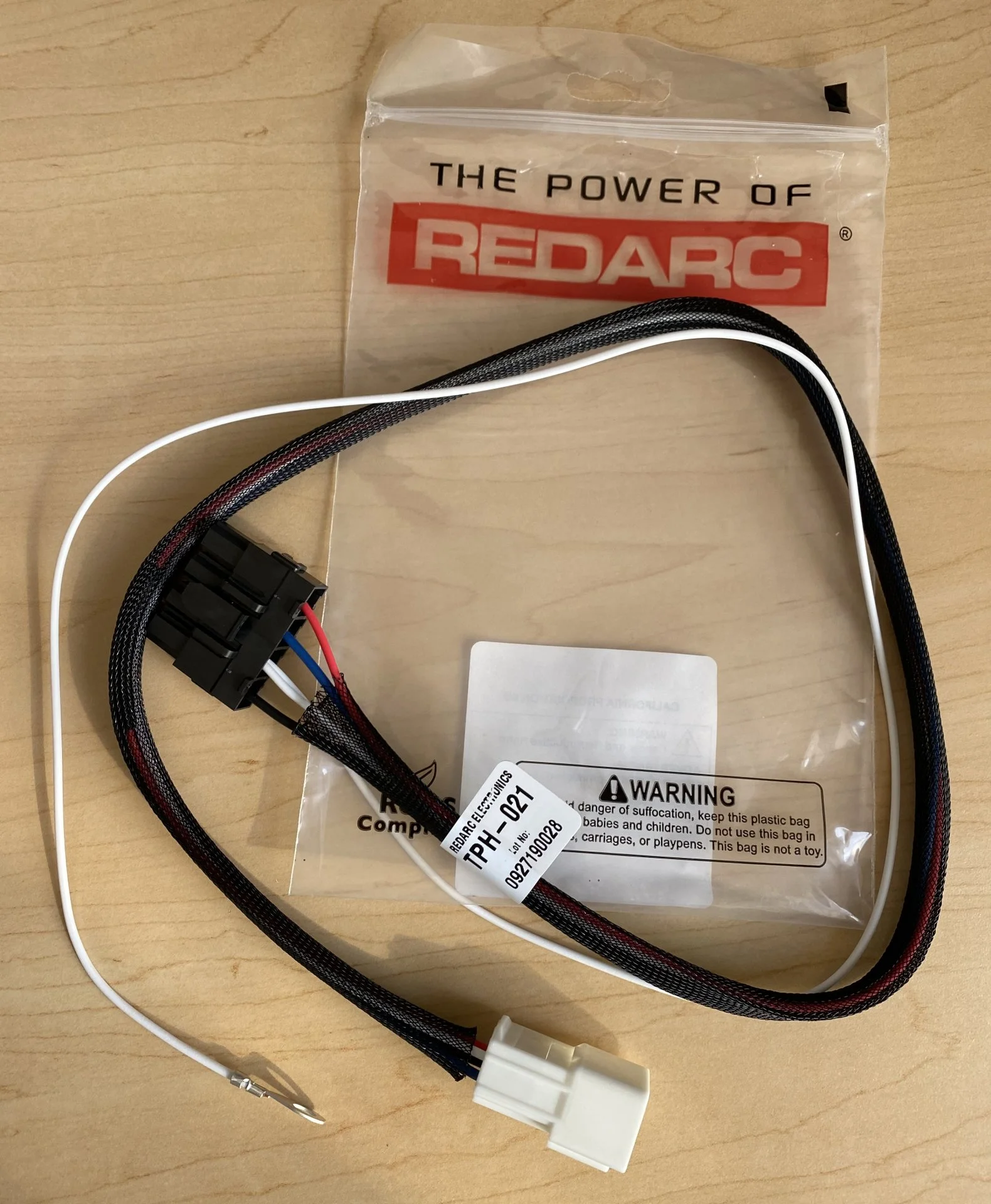

Thank you all. I think Redarc seems to be a good option, i do not need to plug-unplug once installed. Good factory like install keep it clean IMO. I think tow-pro-Liberty is more than enough for me. So, I am on Redarc's site and looking for the plug-n-play cable. I found the following for Toyota TPH-021 HARNESS . When looking at the compatibility list, it says LCs from 2008 - 2012. I do not see anything else on their site for LC 2016+ . Any idea where to find the plug-n-play harness to work TOW-PRO-Liberty and LC2016?

If you can crimp butt connectors or solder, you can easily make a plug and play wiring harness with the tow harness part (that comes with every new cruiser) and the wiring harness that comes with the Redarc. A bunch of us have done it and posted the instructions. It is super easy.

If you got the Redarc harness, it is basically plug and play.
The hardest parts will be finding the factory plug buried in the dash and a bolt to ground the white wire.
The white Toyota connector is on the far left, deep under the dash and the white wire goes to ground, find a good bolt on the body for it.

Plug and play Toyota specific harness is this one, part TPH-021:
